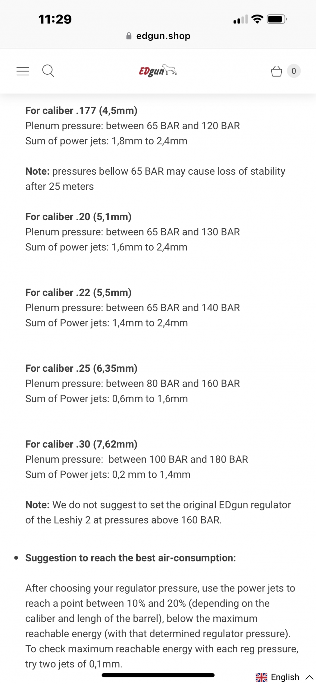

I want to swap to the 350mm barrel but can’t find a power jet valve in stock. If I was to continue using one jet only, what’s the ideal size for a .25/350mm barrel?
In terms of area, the closest configuration to the (0.4,0.4) suggestion from the above chart would either be a single 0.5 jet, or a single 0.6 jet. So if you want something with a little *more* dwell time (more air expenditure), go with a 0.6 jet, and a little less dwell time (less air expenditure), go with a 0.5 jet.
The 0.5 single-jet configuration has 20% less area than the (0.4,0.4)-jet configuration. The 0.6 single-jet configuration has 12% more area than the (0.4,0.4)-jet configuration. So 0.6 is the closest to spec.
But the ideal configuration really depends on your regulator pressure and exactly what projectile you use.

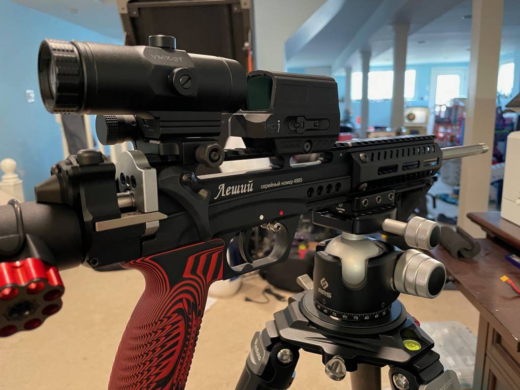

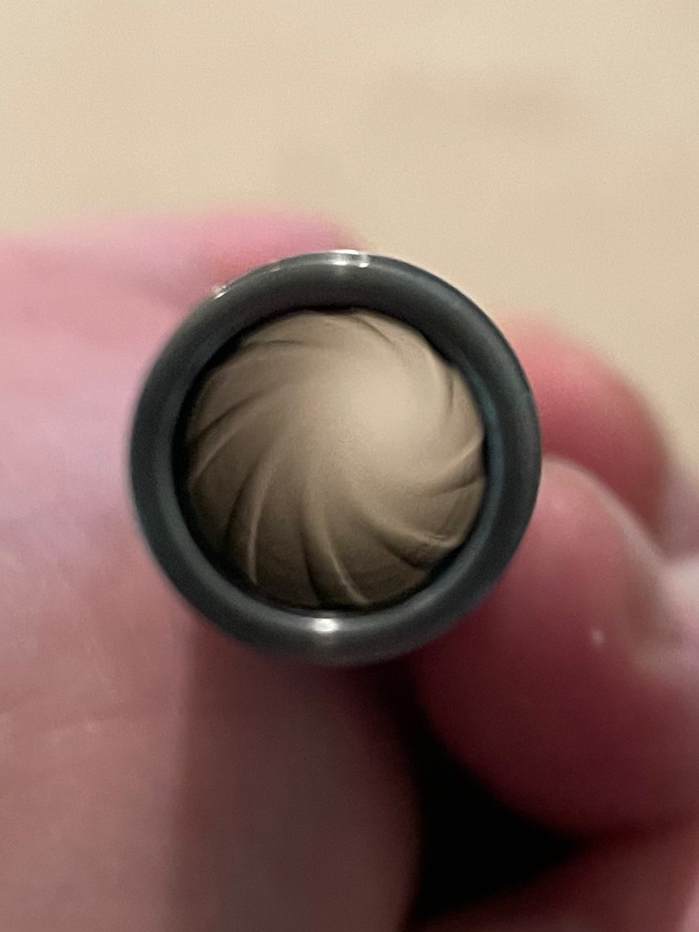

On another note my .357 barrel from Russia finally arrived after 4 months.
Setup as a 450mm single shot.

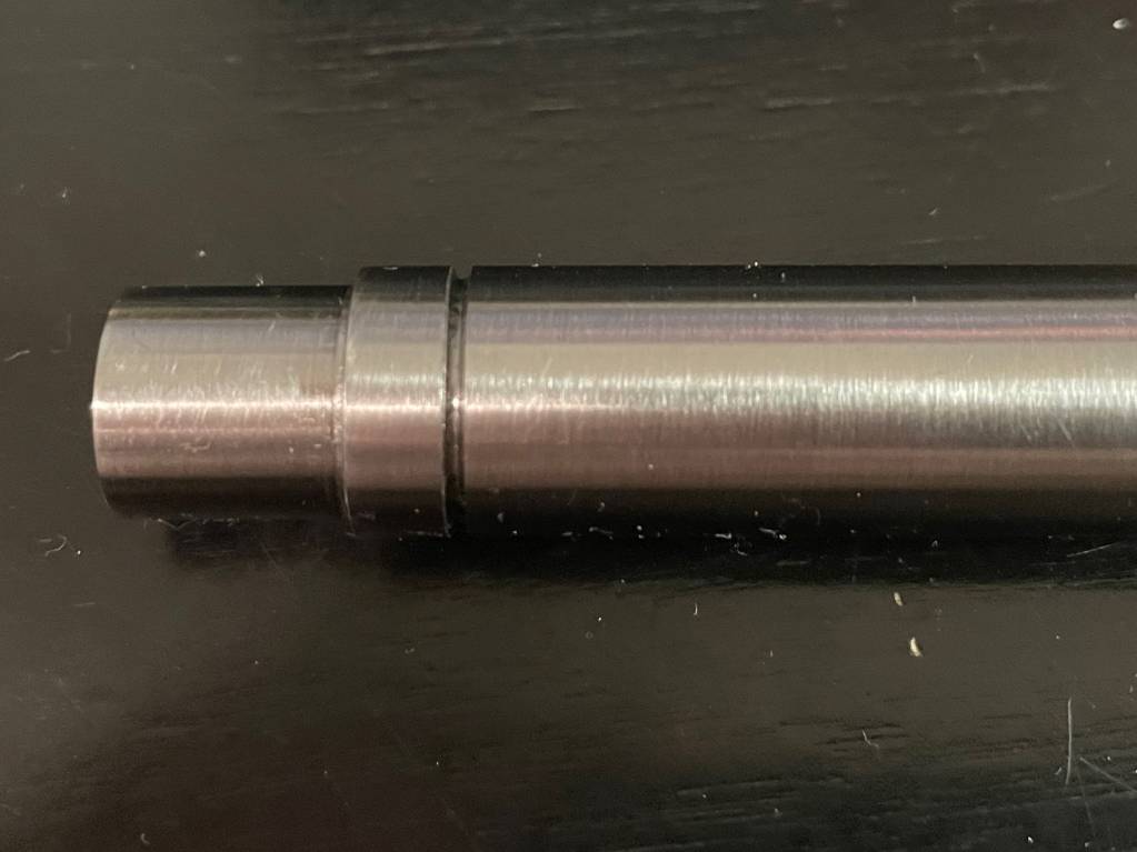

Damn - that's a big hole.
Only problem is there doesn't appear to be much of a lead in to the rifling so my NSA .357 slugs don't fit at all. I honestly wasn't expecting much and for $100 I won't be broken hearted if it doesn't pan out.

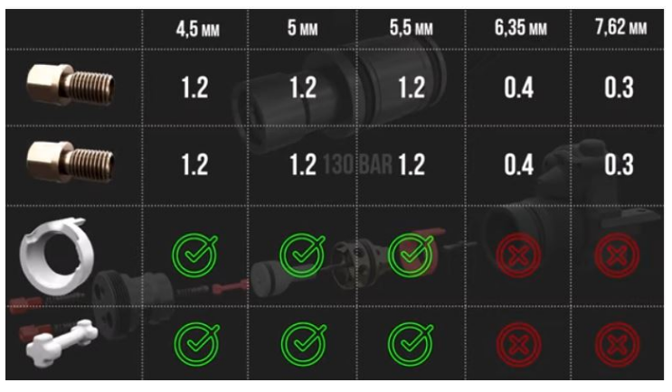

Just curious now that the L2 has the REPR are you guys still playing with the nozzle sizes anymore? I know stock is double 4, but just curious if playing with a nozzle / REPR combo can get better spreads and deviations.
You'll want to switch the nozzles when you change the barrel. But if you aren't changing your barrel or projectile weight by much, you probably don't need to touch the nozzles unless you like experimenting endlessly.
