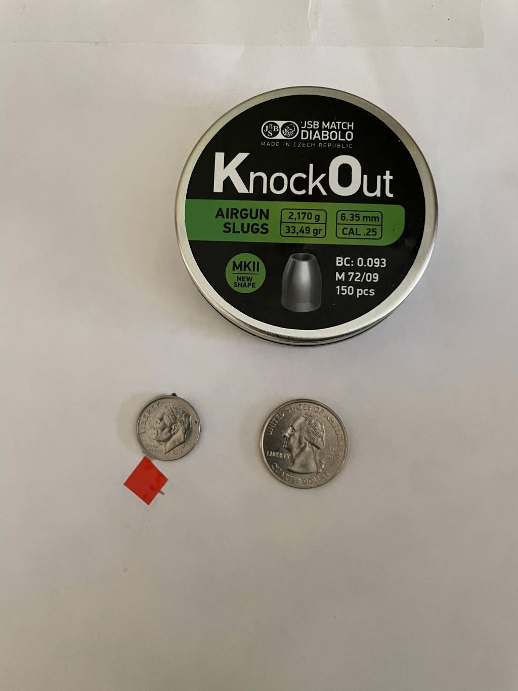

Had a chance to shoot another mag of the JSB knockouts MkII .25 with the Leshiy 2 2 300mm barrel had 160 bar. FX chronograph speed 875 fps 47 yard. Switch to a better scope I think I have the magnification at 10 power. First shot when high, pulled one to the right and the other 6 went the same hole.
I’m curious to see if the accuracy will hold up out to 75-100 yards shooting them at sub 900 fps.

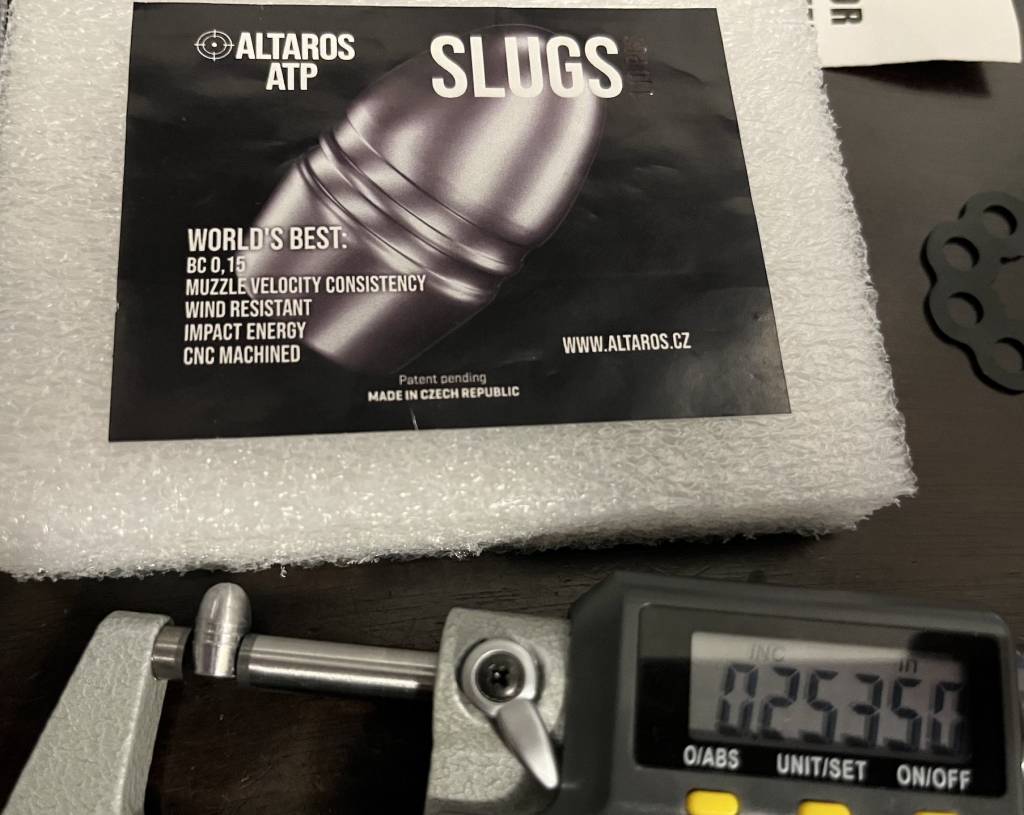

These are the most accurate slugs I have found for the Edgun Leshiy 2, so far. Solid with .15 ballistic coefficient, 50 grain. They are a touch too wide for the metal magazine but do fit the polymer. They are slightly wider than the standard slugs Altaros sells and they made these after a few requests from me.
I am using them with 2 x 3mm jets, ~161 bar and a .25 450mm barrel, with DonnyFl Shogun, for 804 fps and ~16 good shots from the small tank.
I shoot mostly small game at 50-75 yards.
Note - Altaros made these in .254, this is my caliper measurement for reference.
