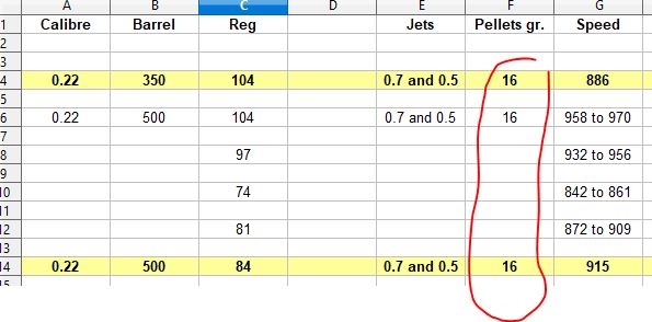

The last good performance I had with lighter pellets 16gr, but once I jumped to heavier pellet 25gr I got lost.
This is the original Reg and don't know gen1 maybe. I hear that the REPR need way higher Reg pressures because of a smaller bellewille washer size, and that was the main reason I didn't bought it earlier. But now just happened that I lost my time and a track about what all changes I made, so finally my grumpy temper kicked in and just ordered that REPR, expecting to arrive end of this week.

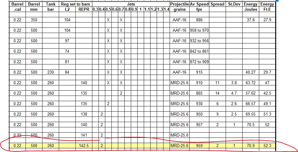

My spreadsheet so far, probably useless for most people buried deep into tuning but maybe a ballpark for starters.

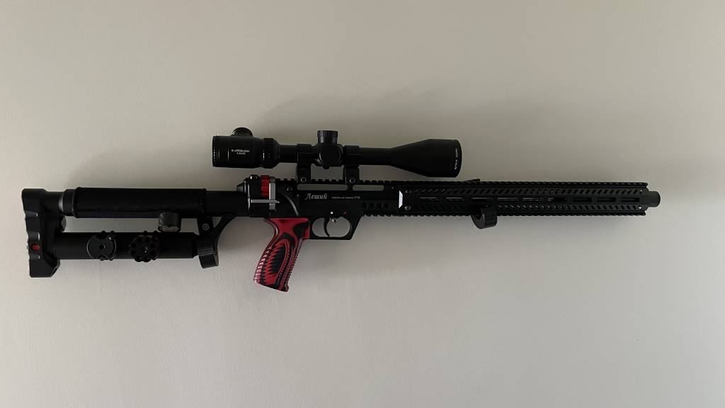

my 450 Shelest……love it
