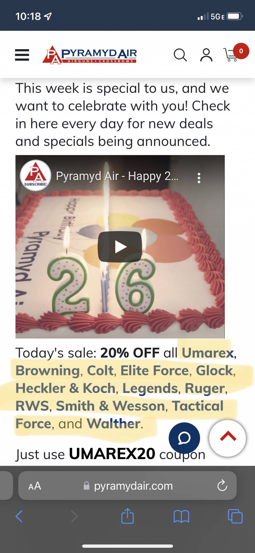

Guys , Pryamid Air is having 20% off sale and that includes products like the Leshiy 2 !! That’s over $400. You are looking at about $ 1800.00!!! So if your looking to buy this would be the time ! Have you seen what these guys want for used??? Crazy , then they don’t want to negotiate ???? I bought mine and can’t wait to doll it up the way I want it !!
NOT CORRECT!
The 20% off does not apply to non-Crosman/Benjamin/Remington products. That’s what the email said and I verified it to be sure this morning!

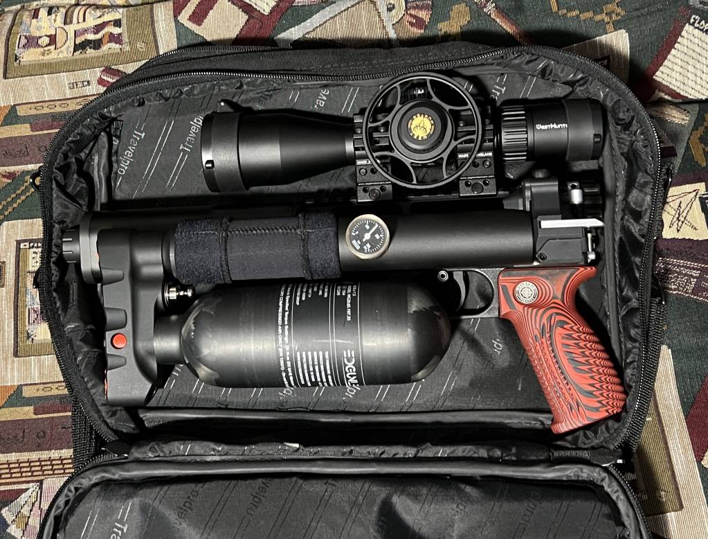

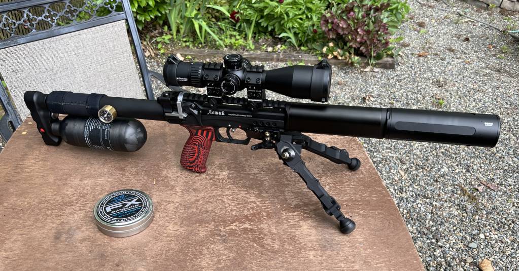

I chose the Westhunter WHT 3-12x44 SFIR FFP scope to mount on my L2. Highly recommended! ...
You lucky you got a small scope. I have maybe the same WHT adjustable scope ring but also my scope have a 76mm bell, so barely fits...no room below for the green dot. Looking now for some picatinny riser if that can give me some gap below.
I chose the Westhunter WHT 3-12x44 SFIR FFP scope to mount on my L2. Highly recommended! Only source I found for this specific scope is on Amazon as it is not even on the Westhunter website?

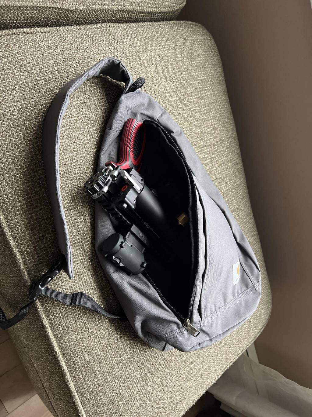

I know you like your laptop case gun bag, but if you’re ever in the market for something more comfortable to carry and equally (imo) inconspicuous check out the Carhartt sling pack gun bag.
Shown with my 250mm L2 and aimpoint red dot, but it fits with my Lpvo too which is not way smaller than your 3-12. I’m sure that’d fit no problem.

I agree, very easy to carry - not Carhartt but I use something similar for Leshiy Classic and L2, both short versions

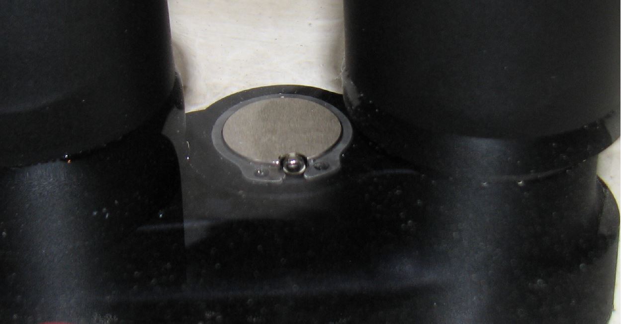

Do you know where the leak is? - if not from the valve housing a o-ring repair kit should fix that, did for me with two L2's, o-rings was fine but bone dry, o-rings need lubricant to flow with pressure and seal
There at two o-ring sets, one for first edition and another for the external adjustable regulator
If the leak is from the regulator aka it blows the o-ring around the brass piston you may have to change the delrin cup and ceramic ball (did)

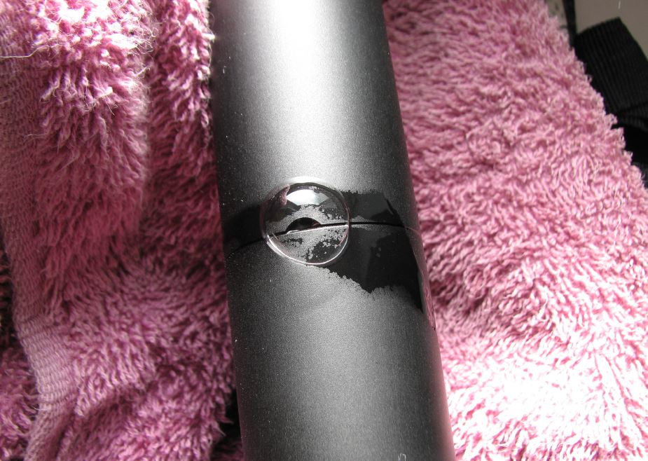

i got one from a member that makes them. if interested i can pm you his forum name. i don't know what the rules are,,,,
I think he's referring to the fancy milled ones from Edgun. Just checked the EGW page, and they do seem available now.

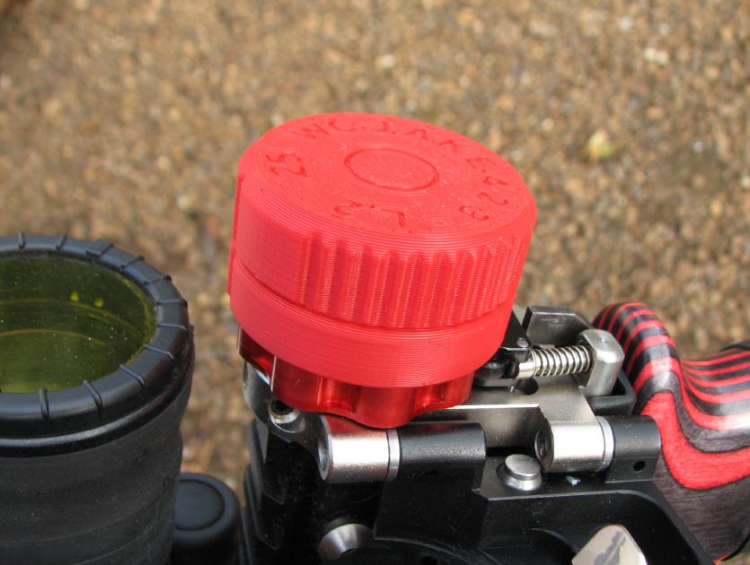

Leshiy 2 speed loader, roll you own
Latest 2 disc nut-less version, all calibers
flat top surface for the magnet folks
knurled sides for better grip
4 x 16mm countersunk screw (standard length), do not cut threads, hold the 2 parts together, ad pressure to the screw as it turns and it will self thread and keep the proper friction like a lock nut
also print the loader for speed loader, will make filling the loader much easier

Latest 3 disc nut-less version, all calibers
4 x 20mm countersunk screw (standard length), do not cut threads, hold the 3 parts together, ad pressure to the screw as it turns and it will self thread and keep the proper friction just like a lock nut

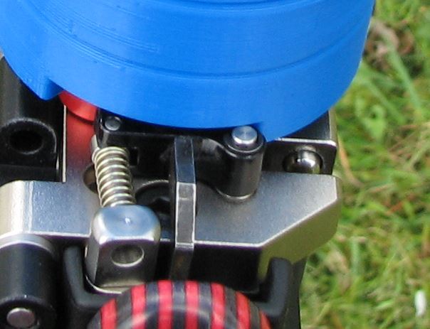

Loading goes like this, hold the gun by the back stock with left hand
peel of the mag cover (new bigger sized cover, no magnet needed) with your right hand fingers
place same between you left hand index finger and thumb, you should be able to do this while reaching around the tube unless you have extremly short fingers
place the speed loader with the index mark at the top
right turn the top part to drop the pellets
replace the mag plate, done
its very fast! - faster than I can change the mag, will see if I can make a vedjao later
