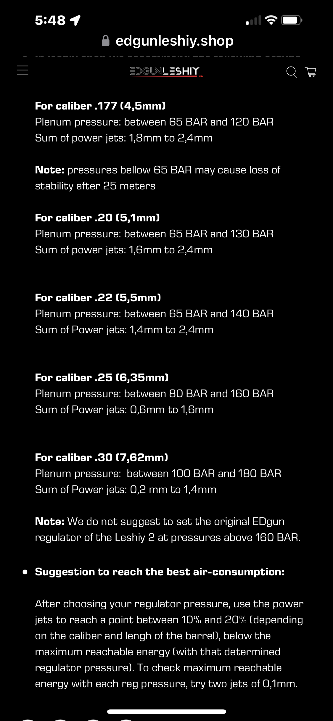

Direct from the website:
Hello everyone, I understand that changing the jets you can increased or decrease the power on the gun so my gun came with 0.4 (both) 25.cal the reg is on 130, so does anyone has a combination to increase the FPS? Thank you very much guys .
Something to be aware of is that many of the jets from EGW came mis-labelled. I don't know if this was a small run or something else, but the original jets on my Leshiy 2 (from EGW) were strongly mis-labeled, and I've seen similar mis-labelling on other Leshiy 2's.
I'd either measure your jets or compare them to some "known to be accurate" jets before you trust the numbers on the side.
