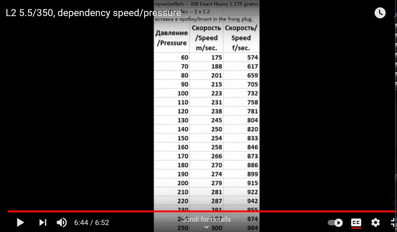

Ed did a L2 5.5/350 test - new forward plug with dog bone & collar installed, no mention of jets so must be factory at 2 x 1.2
L2 5.5/350, dependency speed/pressure
But they seem to be using the old regulators, not the EAR.
The type of regulator do not matter when you have the large plenum as a buffer, Ed (in the link I just posted) seems to get much lower fps with the new forward plug than I get with the old version

From the video, Ed gets 238m/sec @120 Bar with the heavies, I get 280m/sec (350mm Alfa barrel)

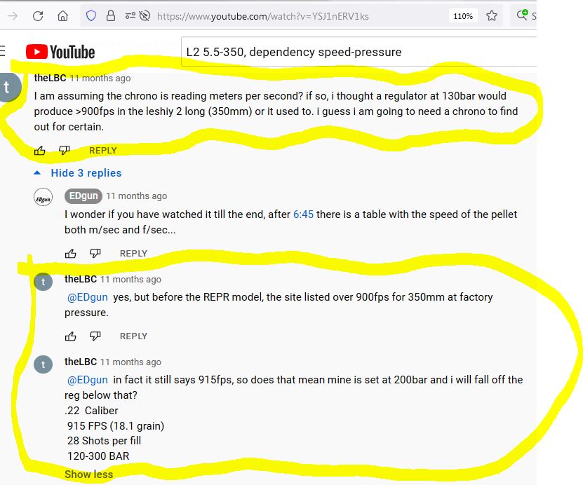

From the comment section, video posted above:
I thought the "new forward plug" was only new for the small-calibre guns. It helps to keep the fps low, for places like the UK where people are shooting without a firearms license. i.e. if you want to shoot high fps or larger calibres, you can remove those new components.
With the new forward plug inserts in place (dog bone & collar as there referred to) you have to crank the reg up to around 200 bar to shoot the JSB Heavys 18.13grn at 900fps. As it shows on on Eds chart, I'm assuming this is also using the 2 x 1.2 jets as well??
But, if like me you remove the inserts you can achieve higher fps with a much lower reg setting, the same as with the original forward plug, all just seems a but redundant to me 🤷🏽‍♂️
