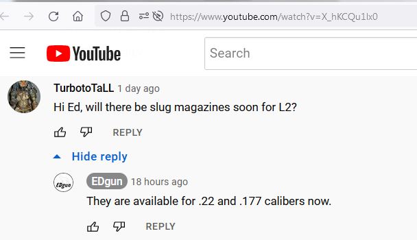

BTW, from the comment string under Ed's latest video:
Excellent explanation, do you have the Leshiy 2 EAR, in .22, 350mm configuration?
If so what jets, puck & regs settings are you running? Curious 😊
