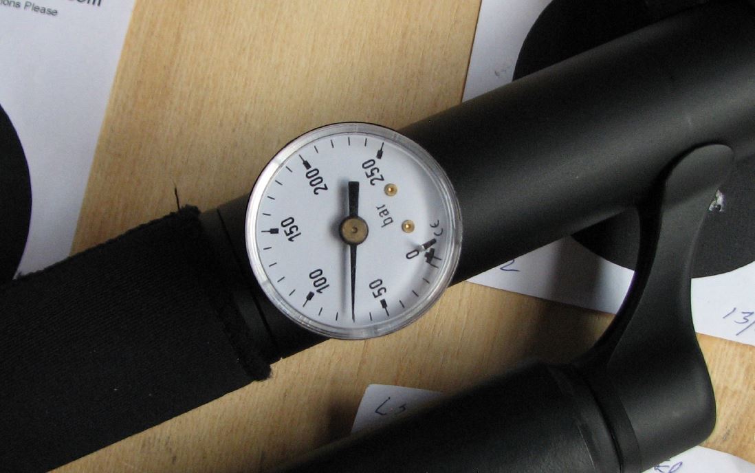

My regulator pressure is measured with the Sekhmet digital gauge in place, the other side of the EARHow are you two measuring your regulator pressure?

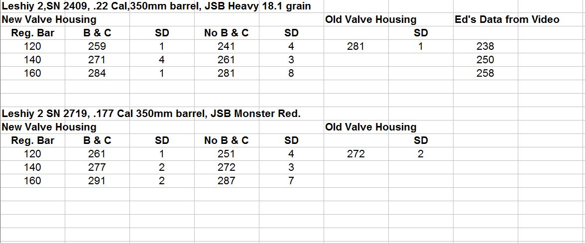

With the EAR, apart from being able to easily attach a gauge & quickly adjust the reg....I just seems the previous regulator /plenum setup (as you have) seems much betterYes but mine has same barrel length, but maybe slightly lower friction, compare:
350mmLWbarrel. ALFA poly barrel.
.22 calibre. Same.
EAR regulatorFirst edition regulator.
Ammo: JSB Jumbos 18.13gr. Same.
Dog bone & Collar: removed. First edition valve housing.
Reg:155 Bar. 120 Bar.
Puck: full sized. same.
Jets: 2 x 1.2mm. Same.
Speed: 900fps. 919fps.
Shots per 300 Bar fill (standard cylinder): 30. To quote Harry: in all the excitement I ...
That should not make any difference, the new reg may have a bit lower flow and longer reset - Bar is Bar - what you see on the manometer is what you get
My take so far, the new valve housing without the dog bone and collar is not the same as the old valve housing
With the EAR, apart from being able to easily attach a gauge & quickly adjust the reg....I just seems the previous regulator /plenum setup (as you have) seems much better![]()
I think it's the other way around. The original plenum was smaller than the EAR.Don’t quote me, but I believe the original reg had a larger plenum than the ear. Ed says this should not matter, but to me, plenum is plenum. You can definitely bypass this by raising reg pressure, and economy shouldn’t suffer. Looks to me like this is the case with all your testing.
Jmartinez is getting 84 shots on a 300cc bottle with original reg set lower and 450mm barrel. Compared to drseagram who is getting 30 shots on factory tube, which is about half the size of a 300 bottle, at higher reg pressure, and similar speed. This would show similar economy less about 20 shots (shorter barrel would confirm this). I say both of you have some pretty good tunes respectively.

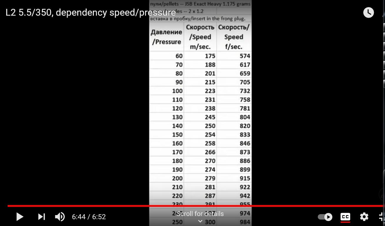

Hey bud I I’m running a 350mm .25 and I’ve been trying to tune my gun for a bit now and I’ve changed power jets and messed with reg pressure a lot I also have a 300cc tank and on a full 250 bar fill, I was getting 22 regulated shots and about 25 more unregulated shots easy with factory 180bar! And a pair of .4/.4 jets which wasn’t the best for me accuracy and speed wise, I was recommended to put a pair of .2/.2 size jets and turn down to 160. I was also told you should be running two jets cause it was made to flow through two. But Yes the .2 size would mean less air efficient but it would give me better speed with lower psi in the repr what I wanted. This maybe saving more regulated shots? So far liking the .2 size still have yet to do shot count but sitting at 160 bar shooting 34grainers at 55fpe and pellets 26grain at 50fpe. Surprisingly before I couldn’t shoot both slugs and pellets at same tune they would be opposite and way off but today I poop both at 160bar w/ .2/.2 and they were both right on sure only at 20 yards but more testing to be done soon. liking it so farOK I just tested my .30 x 450mm after setting the reg to 151 bar from the factory set 136 bar. I got 609 fps with NSA 47 grn. slugs and 646 fps with JSB 44.75 grn. pellets. Not much improvement over the factory setting 136 bar and 620 fps with the JSB 44.75 grn. This would have been very disappointing prior to us knowing about the nozzles. My thinking is this valve needs to breathe longer for this barrel and caliber combination. But it may be just the opposite ? Assuming the #7 on my nozzle means .7mm and both are both the same size I at least have a base line of .14mm to start from. So for you guys wanting to change out your barrel to a .22 / 350mm , at 135 bar with .14mm nozzles is a good tune for 16 to 18 grain pellets. MtnGoast had mentioned that .25 / .30 guns came with .4mm nozzles which if thats correct is opposite from the way I am looking at it . I would think with every increase in caliber size the total nozzle volumes would increase too for a middle of the road tune. Can someone confirm what size their 30 caliber came with. Then we see Kikopower has one nozzle hole blocked off and one large nozzle in his .25. But he doesnt know what size it is yet and he didnt mention his barrel length. I think when we all start experimenting with the nozzles and reg settings we need to also give the barrel length so we are all on the same page. All this now brings up the only thing I dont like about this gun and that it doesn't have a means to adjust the regulator or change out the nozzles without degassing the whole system. But that isnt that awful unless you are hand pumping.
BlackPaw, The regulator in the Leshiy 2 is the same design as in the Classic or at least the way it is adjusted with an allen wrench. There is no indication marks or numbers to tell what the setting is at so as the videos on the classic OEM regulator show how to adjust with 30 degree turns for every 10 bar increase or decrease depending on which direction you turn, is close. I was shooting for 150 bar and it took me three try's to get to 151 where I stopped. you don't need the tester to adjust the reg but without it you really dont know what you got without a gauge. and if you loose your place or dont remember what it was last set at, your screwed.
