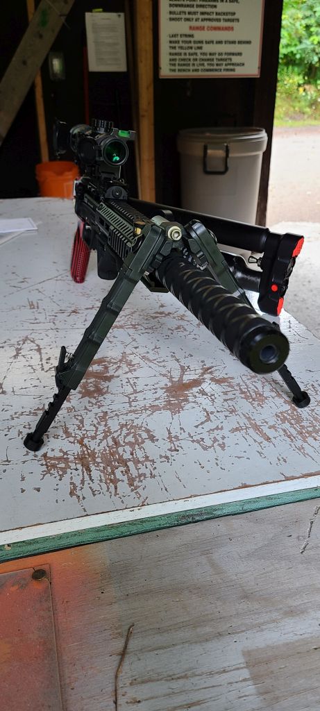

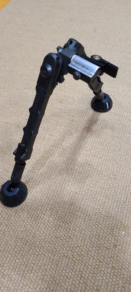

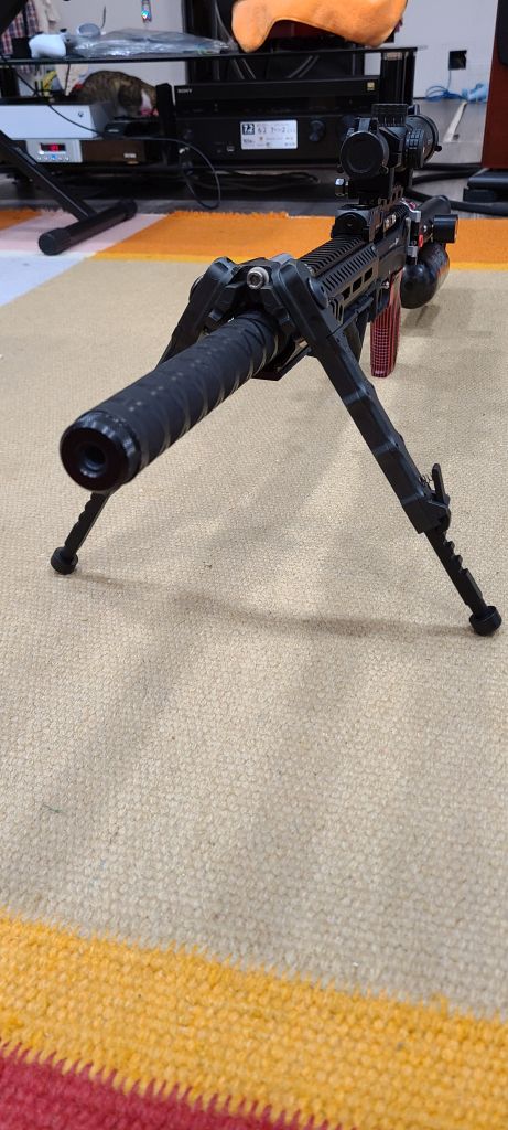

I have this AT clone bipod for couple years, and I am so glad I have not paid more then $50CAD for it. I just hated bipods from day one, how it holds the CoG. For my Impact BR I built a one-piece rest, and with Leshiy2 I was using a heavy tripods, I built couple of them for BR and 22LR silouettes.
So this AcuTac clone sits there in my locker for ages, I decided rebuilding it DIY into over-the-barrel bipod from bits and pieces I have hanging around in my garage. And I kind of like it now how it is holding the gun in plumb.

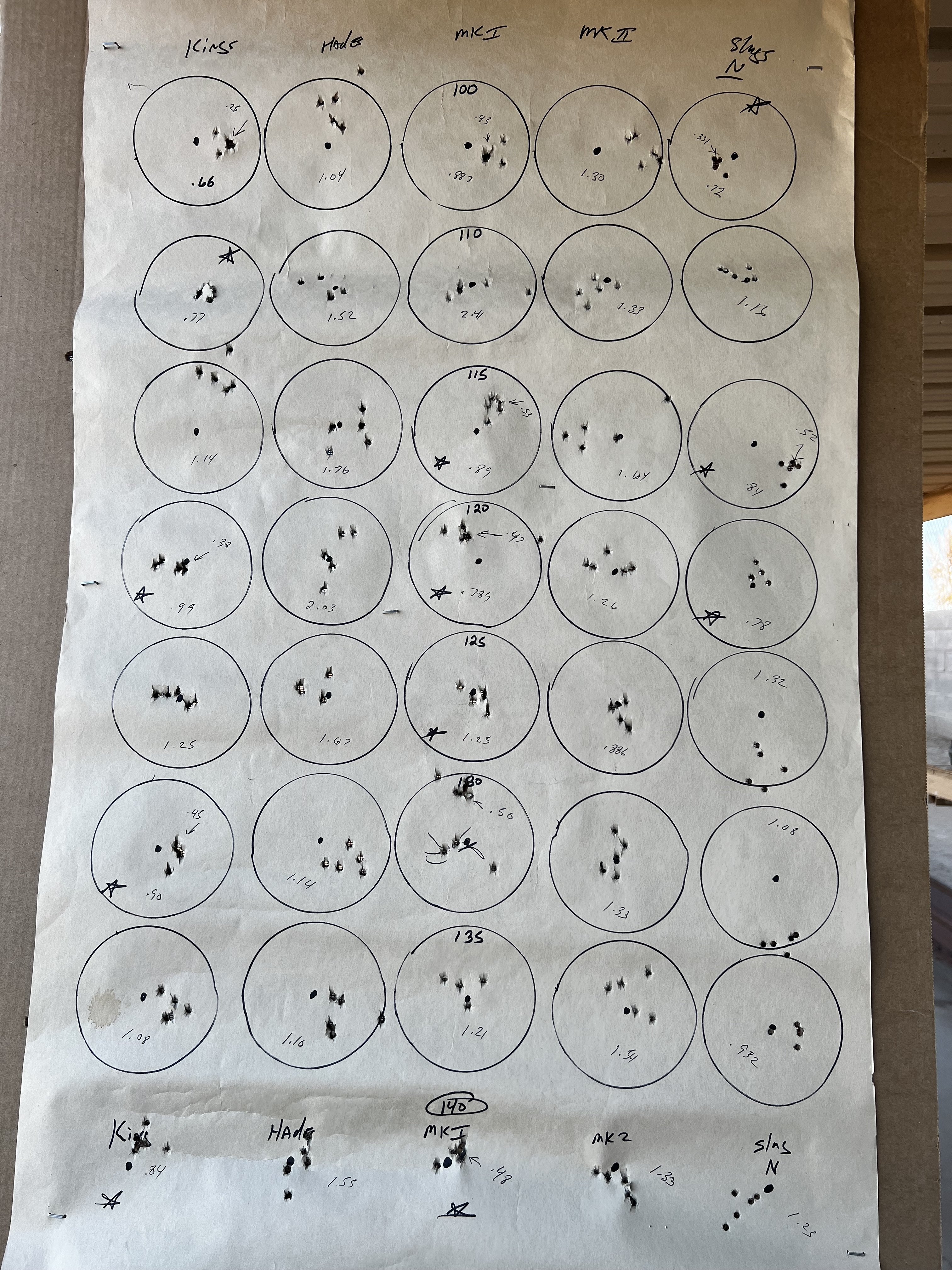

OK went to the range and did some testing at 50 Yards and various Reg settings, pellets and slugs. Having the reg at 160 shots great but poopty shot out two mags at best with factory jets. Surprisingly at the range I found kings and Neilson slugs shot really good with the reg set at 100 BAR, and I get like 5/6 mags. The slugs while shooting great at the range when I got it back to the house opened up quite a bit little disappointed at that. Here are the groups 5 shots in each circle. Groups are measured in inches, and if I had what appeared to be a flyer I have two measurements with and without. The number in the middle circle is the Reg setting.
