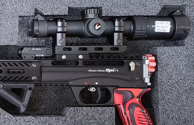

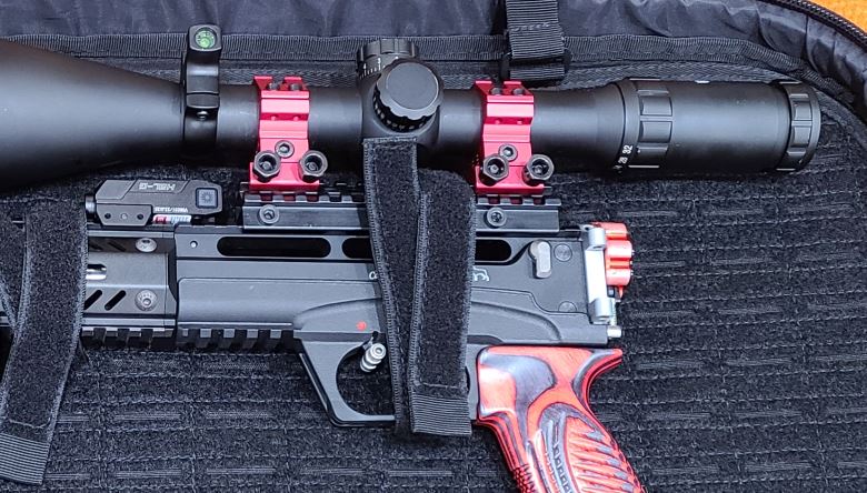

@towle is there anyway to measure how far forward a scope needs to be for that loader to work? I think I have the 2mm clearance already.
I've had a heck of a time getting scopes far enough forward. My Leshiy2 is recent with REPR. It has the ~115mm upper tube which I believe is the shortest. I think going to a shorter plenum is not possible with the REPR.
I wouldn't mind getting the length of pull similar to my Leshiy Classics & that would help with the scope position some. But I'd buy new rings first.

Just curious, but what is the plenum and air tube arrangement on the L2 with the 2-7 Hawke?
I mocked up a 2-7x32 Vantage on my L2 and there is no way I could use it with 17mm overhang. I would need much more than that.
This is with the REPR plenum and shortest air tube.
