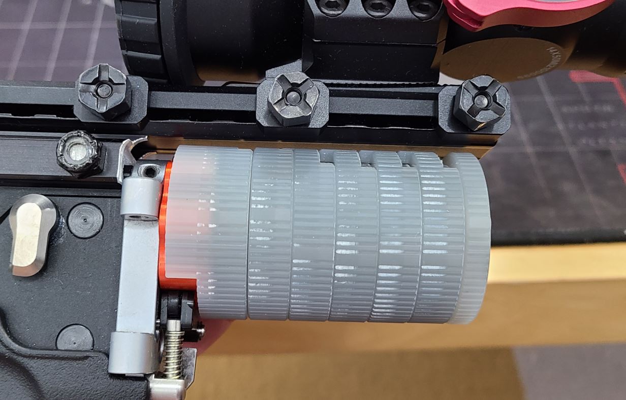

Were these all 3D printed ones? Which one has the smallest diameter?
making a small diameter one is easy (I made a special edition for wcjake423), but it require 3 hands, one to hold the gun, one to hold the speedloader base from rotating, one to turn the upper disc to release the pellet
a speedloader disc indexing on the mag indexing arm makes it a 2 hand operation
This brings up a question I hadn't thought of. Do the speed loaders increase in diameter with caliber?
I had assumed they do not since the L2 indexing mechanism is made for all calibers?
None of mine seemed to differ in any way that depended on Caliber. Some of the .25 ones were larger than my .30 one from Sub-12 Airgunners.

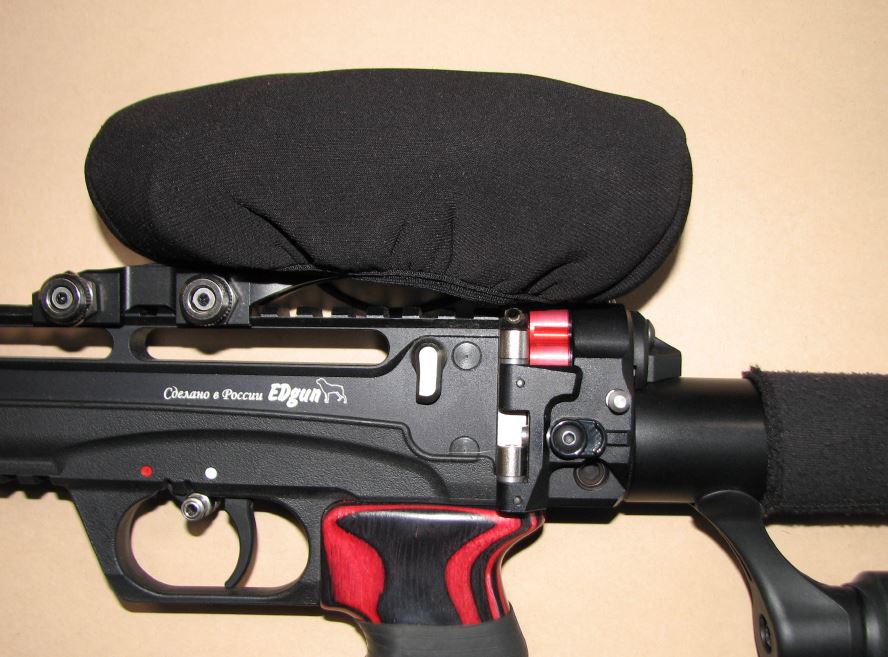

Just curious, but what is the plenum and air tube arrangement on the L2 with the 2-7 Hawke?

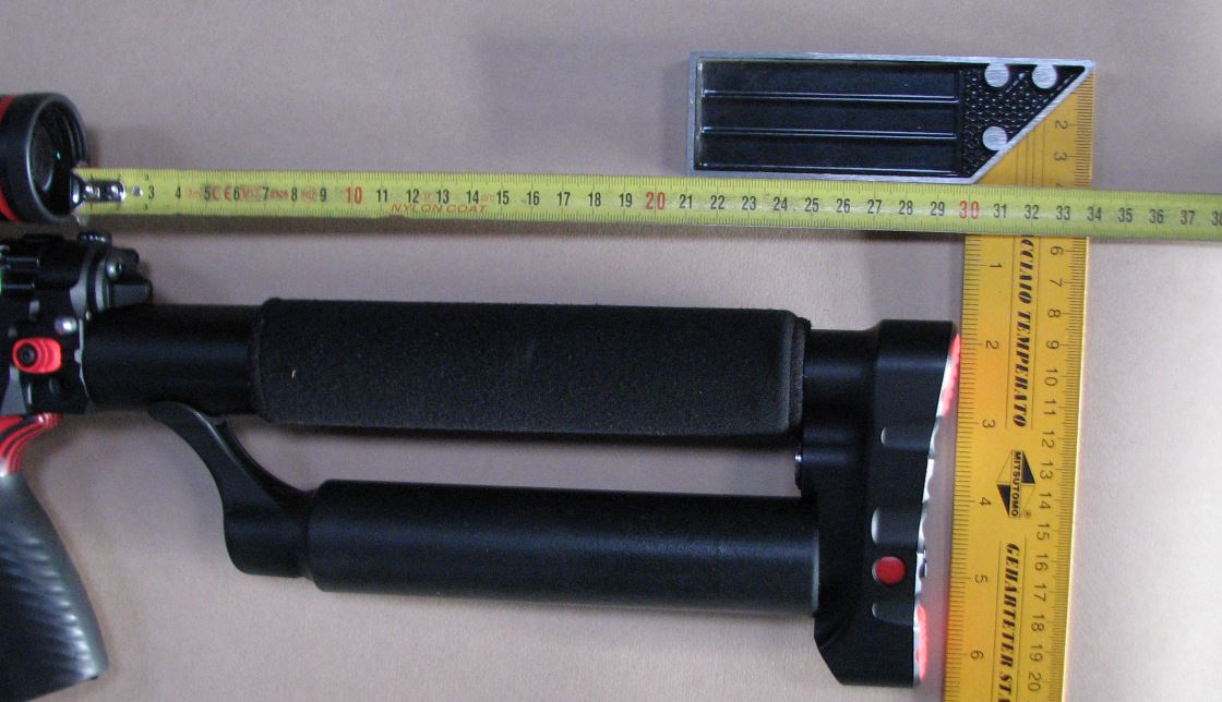

Its the first edition as came from factory (non-EAR version), shoulder to scope is 298 mm, I get full bell vision with the Hawke so perfect for me
I mocked up a 2-7x32 Vantage on my L2 and there is no way I could use it with 17mm overhang. I would need much more than that.
I like it to fold without the scope adding to the folded length
My design use same OD for all calibers
AFAIK my design is the only one in the world, maybe the universe, that indexes on the magazine indexing arm with a simple one-handed plug and turn and play operation :)
That sounds good. Not to get too much into my health issues, but one of many side effects of my vestibular issue is that it makes me sort of clumsy which is my main reason for interest in a speed loader.
Sorry to ask a question that I'm sure is answered in the 3D print thread, but do you loaders have the magnet for removing the magazine cover? I'm trying to take as many hands out of the operation as possible.
No they do not but I can easily make an indent for a magnet you can glue on to the top disc, just state the OD of magnet used
I prefer to use the oversized magnet plate, easy to peel of, I reload like this:
1. fold the gun and hold with left hand around the tube
2. peel of mag plate with right hand
3. place the mag plate between left hands indexing finger and thumb (I have normal size hands and can easily reach around the tube and hold the plate between the 2 fingers at the same time)
4. right hand mount speed loader, turn to drop pellets
5. right hand remove speed loader, grabs mag plate from left hand and relocate on the mag
It may look slow in writing but it ain't
I'm not worried about speed but rather fumbling around. I'm not sure what the oversized magnet plate is but I'll assume that's what I have since my L2 is new and I don't have any trouble removing the plate. The rest of it sounds fine to me.
From the back of my magazine to the same spot on the stock is basically the same length. Amazed you can get the scope that far forward.
