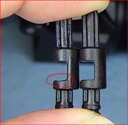

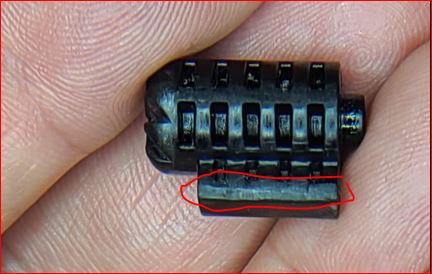

This "little" wear can really make the life miserable :cautious:
These cannot be made from metal because need to be light-weight but I will haveto make some extensive research how to extend the life on these parts
