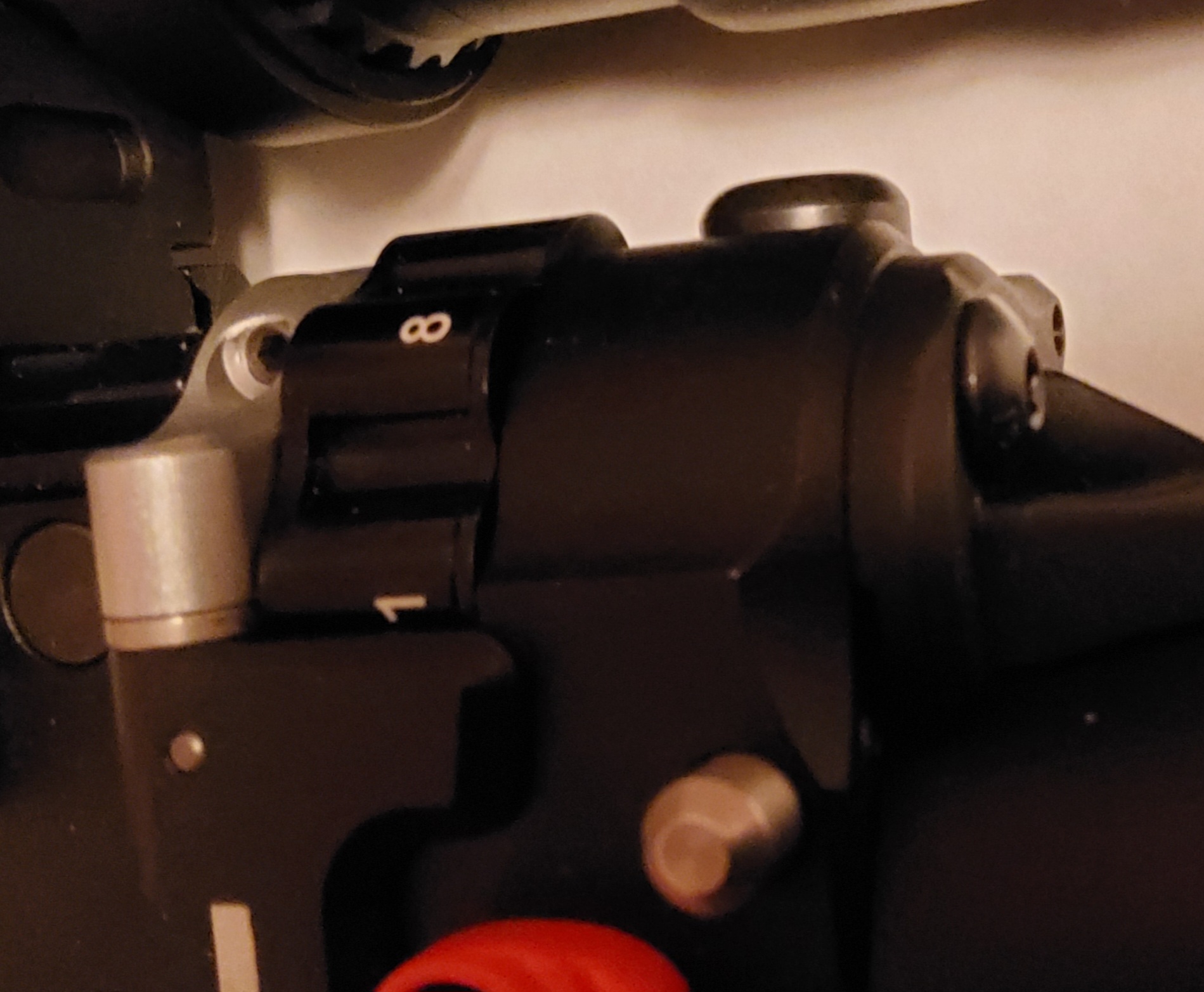

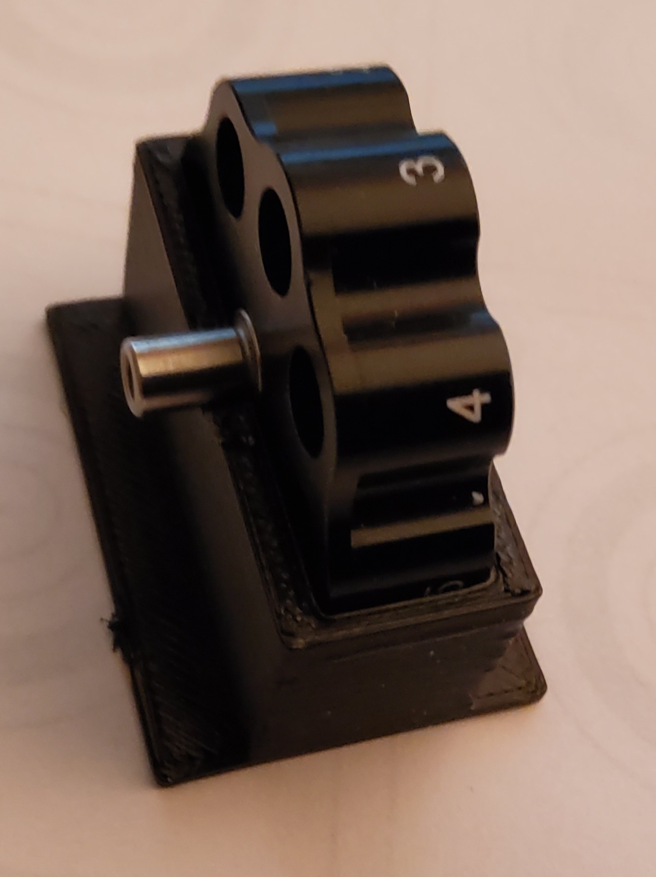

Tinkering what I shall - or can - change in my L2 setup to be able effectively shoot Action games. I am right handed + right eye dominant, but the L2 opens to the left. How to make mag reloading fastest possible? With my left hand I feel doing it so - weird?
I open mine and hold the rifle with my left hand and fumble with the speedloader with my right. I'm getting there. I would recommend a speedloader
Yes, after unlatch I have to transfer to left hand and hold it open. Maybe a next version could have a latch below so open it like a shotgun? ;)

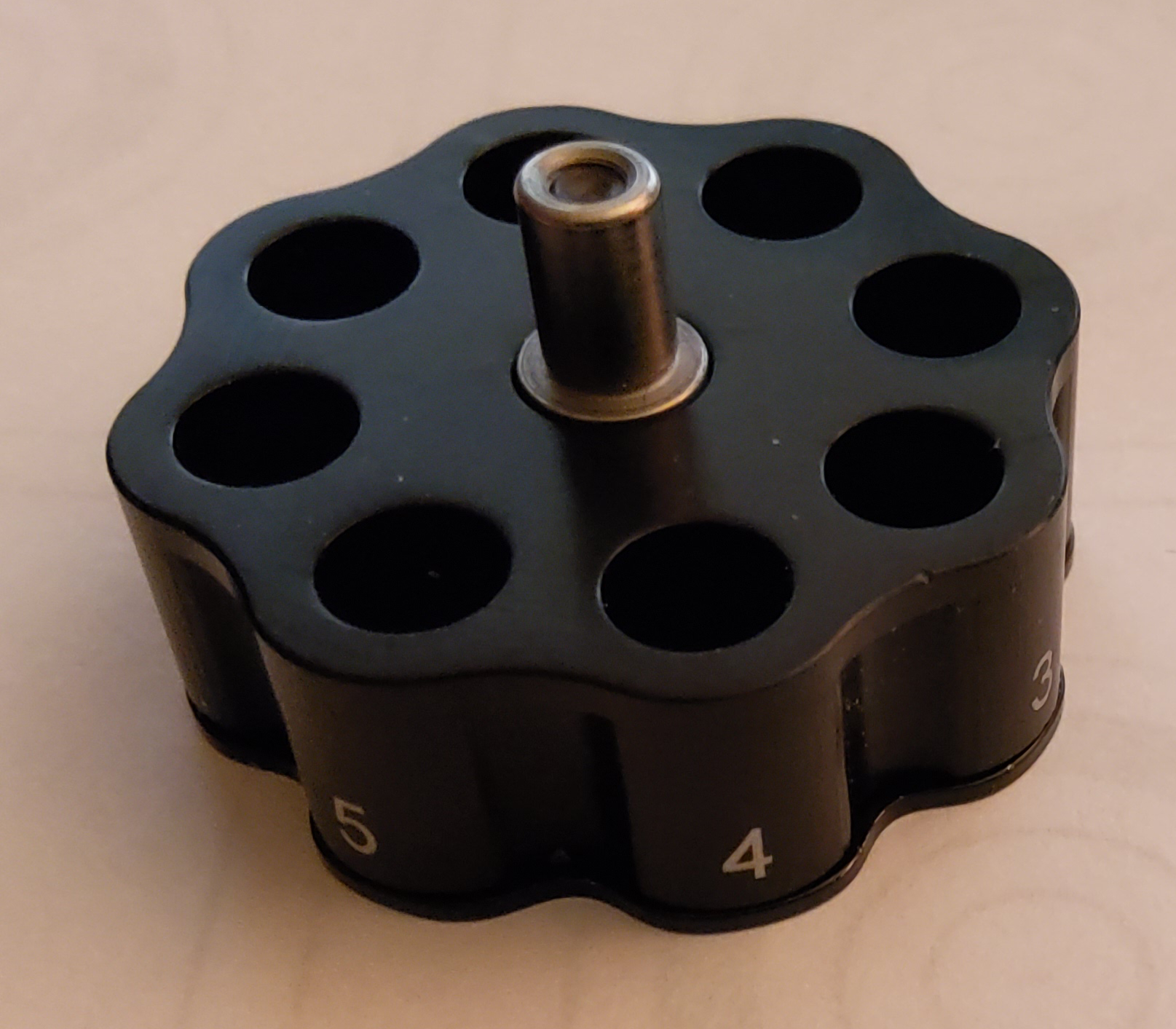

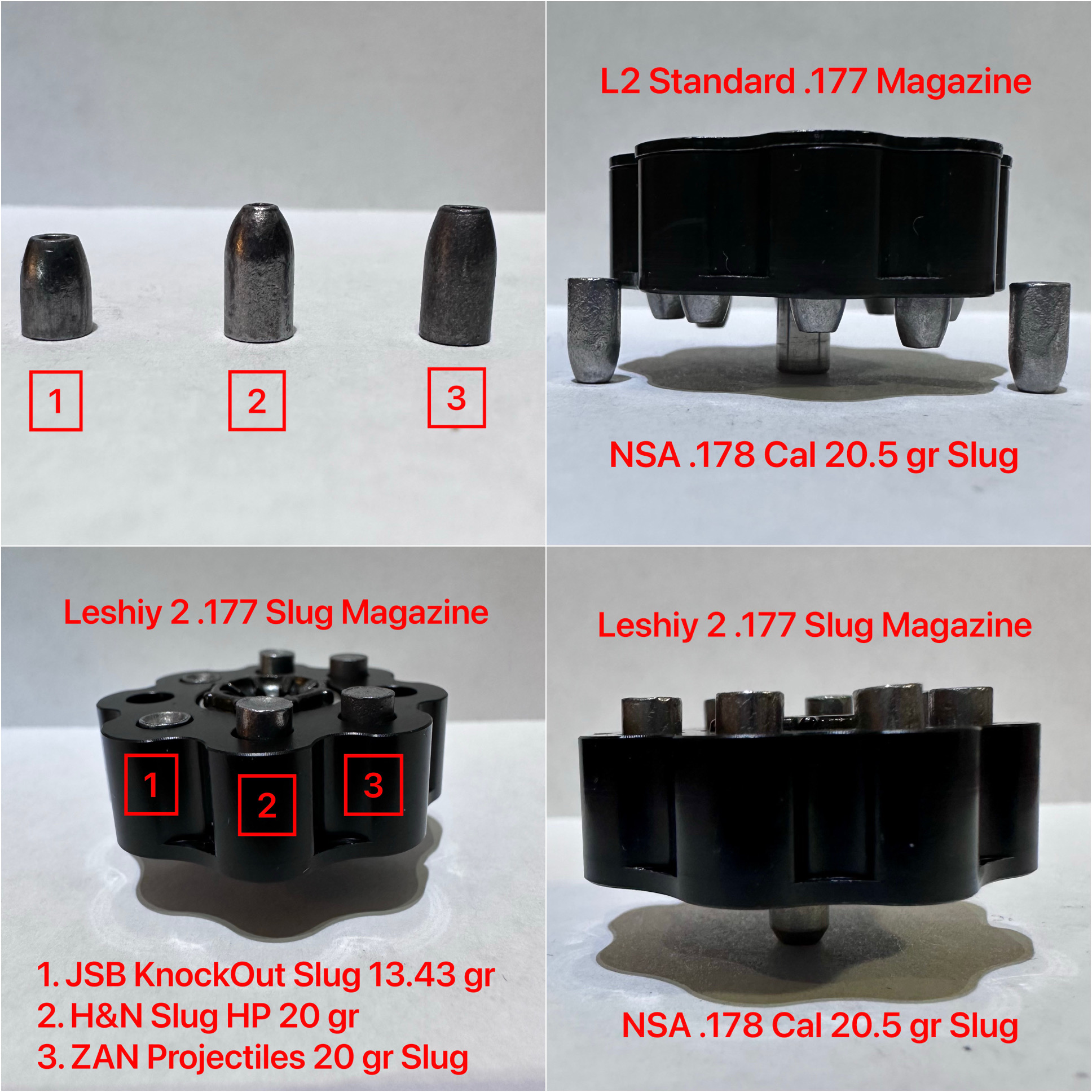

Does anyone have insight on what is a proper slug fit for the new Slug Magazine?
The JSB and NSA slugs fit in the standard magazine, without falling out, but rattle around inside the standard magazine. It’s cumbersome to install the magazine on the gun breech or the magazine holder, when the slugs partially protrude out the breech side of the magazine. However, just leaving the magazine installed on the breech and using a Speed Loader resolves this issue.
So far, I’ve only experienced one slug, the JSB KnockOut 13.34 gr, that doesn’t require a considerable amount of force to be seated into the new slug magazine.
Are we supposed to find the few select slugs, that fit like the JSB, or is it by design a requirement to push the slugs into the magazine?
Having to push the slugs, into the slug magazine, seems to defeat half the purpose of the Speed Loader!
I feel like I may be damaging the slugs or the magazine, with the amount of force required to push the slug into the magazine. But, they all seem to exit the magazine just fine.
Between the regular magazines and slug mags I find I can fire pretty much everything I have, without problem. But I'm using .22 and .30 cals. Some slugs require a bit of force to get into the magazines, but I don't use a speedloader so it's not really an issue for me.
That said, I mostly use pellets. I think I only have three different slug types: NSAs, Javelins and Altaros.

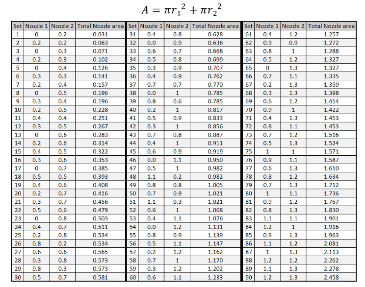

Here is a table of nozzle combinations and the resulting total area. I find it quite interesting. It will be even more interesting when we begin to see lots of results. As a rule of thumb, dwell duration is inversely tied to total nozzle area. Long dwell needs small area... For low energy guys, I think somewhere in the table we have to start using transfer port ID to maintain backpressure to cycle the mag. I am wondering if there is also a trend in optimum reg pressure that will show some sort of pattern with the nozzle sets. It seems logical that each caliber, barrel length and projectile can be optimized in this platform.
Love it. Have a .177 350 mm. Changed to a 450 mm .22.. At 16 j with the .177. I got 24 j with the .22.... At full power with the .177 I Got 32 j . BUT. only 38 j with the .22..Not 48 j.... On page xx there was a guy with .25. 63 fpe. 450 mm and 0,2 + 0,5 jets.. 0.228 area according to your chart.. My thoughts are that scaled down to a .22 the math would be ..25 is 3,175 x 3,175 x 3,14 ..is 14244 cmm..A .22 would be 10686 cmm.. 0.228 x 14244 ,div. 10686 is 0,304 ..Or 0,2 +0,6 jets.
