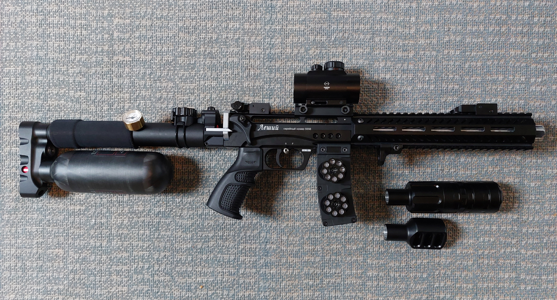

So the thing that I love about the L2 is that it fits into a normal backpack! But also the problem is that I run out of air SO FAST. What buddy bottle tanks/sizes have y'all found to be the best fit so that I can carry more air with me in a backpack along with the L2?
I've never had that problem. For me the L2 is a hunting rifle. For me, one magazine is often far more than I really need. More often than not, it's 1 or 2 shots, and I'm done.
That said, when I go to the range I tether it to a bottle so that my son can fire off 200 rounds. I've got a small bottle that I carry around in a backpack, and a big bottle that I'll leave on the shooting table.
The size of the bottle you'll want to use will depend a lot on how you shoot. Calibre, regulator pressure and number of rounds will answer your question, for the most part. If it's a close call you'd need to know your jetting, i.e. exactly how much air you lose per shot.

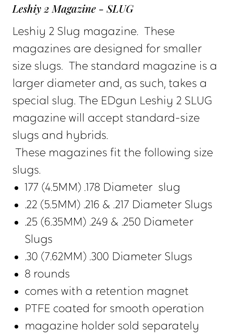

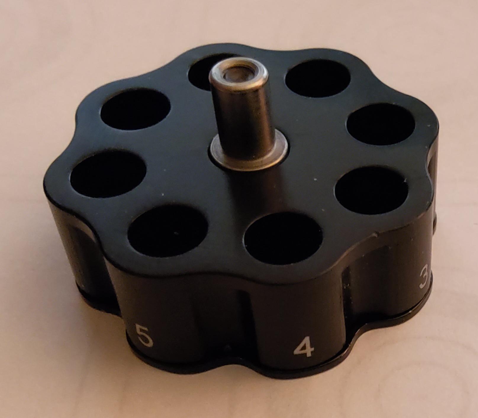

I’m curious why the slug mags do not fit the barrel. According to the specs put out on the wolfiek page,
Lothar walther .2216 groove (5.63mm)
.215 bore (5.47mm)
Alpha .2208 groove (5.61mm)
.2138 bore (5.43mm)
I confirmed (slugged) with my own barrels.
16twist on both.
These are typical rimfire barrels. Not a problem really for me because I have used quite a few and I make my own molds for my builds. Except the mags need opening. Or single load with adapted barrel.
I wonder why slug mags are not designed for optimum slug size for barrel. For 22 anyway.

The slug magazine is a great addition, but it feels a bit iffy. It shoots FX Hybrid slugs perfectly. They fit nice and snug, not too loose or too tight. But Zan slugs require a lot of force to get them seated all the way. More force than I'm comfortable with honestly.
I did one test shot with a single Zan loaded into the mag and it did fire and cycle properly with the Reg set to 150 bar. But it still feels like Im setting myself up for an jam at some point. That's how tight they are seated. Maybe Im just being paranoid, but still. The official Edgun webshop specifically sells Knockout slugs and Zan slugs, so I assumed that these were the recommended slugs for the L2. But now I'm not so sure.
