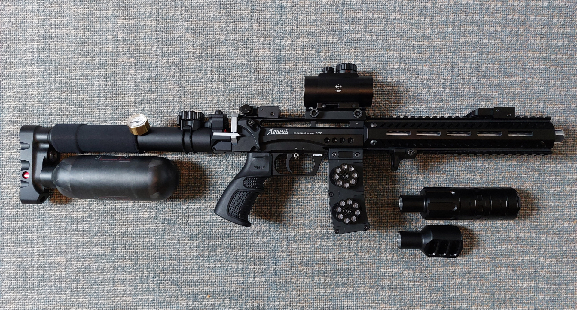

Congratulations on your L2. What caliber, pellets used, regulator settings, barrel? Thank you for the information
