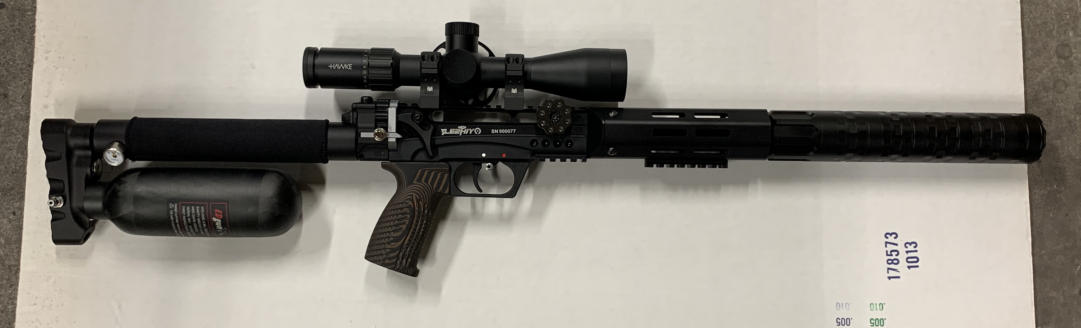

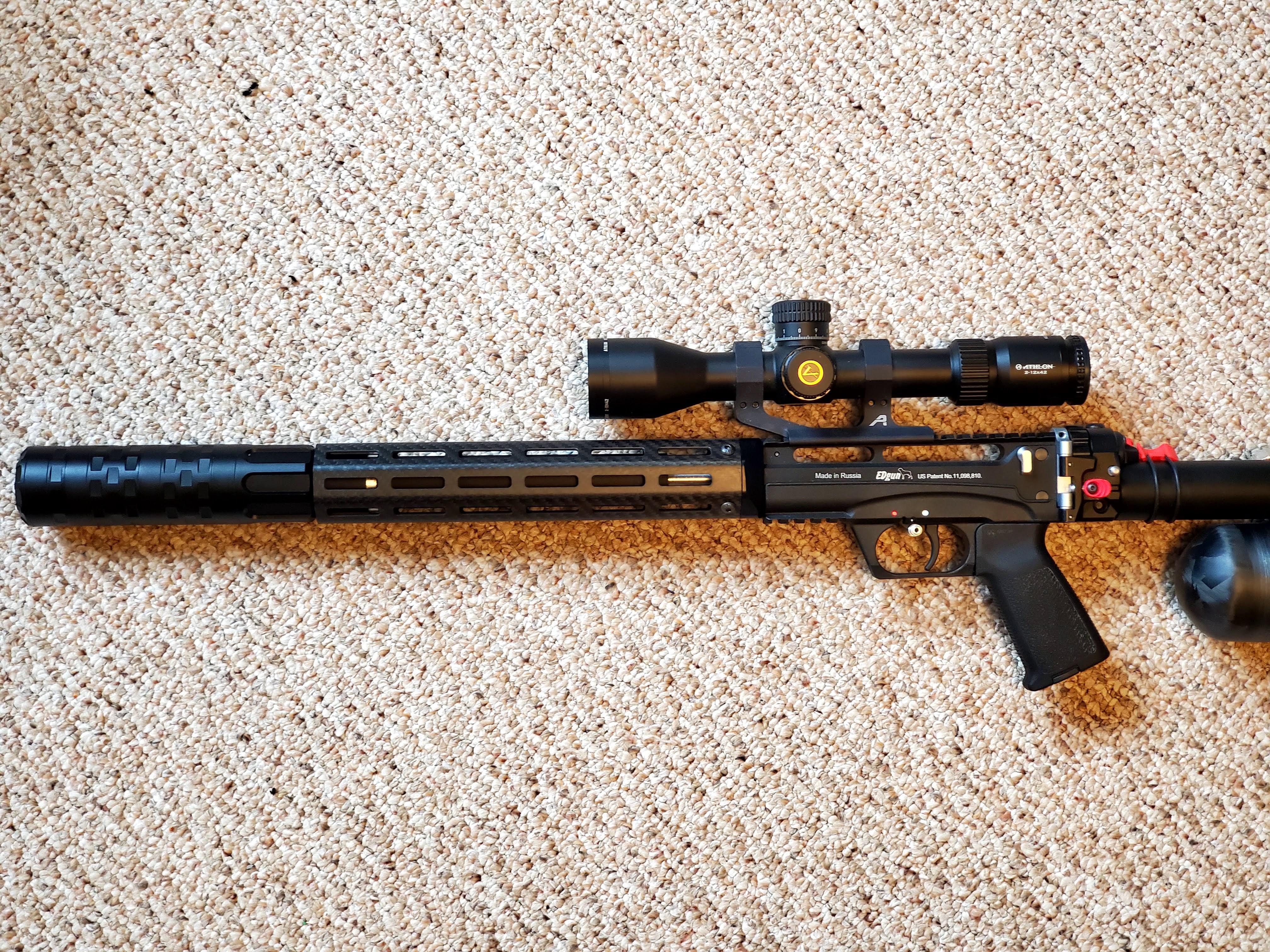

I can't answer all your questions but I recently purchased and L2 in .22 350mm with Behemoth moderator.
Looks like your gun has the monster plenum from the 9mm model. Interesting...
Upvote 0
Yes, it is the reflex Behemoth per Edgun ad. I do not perceive any sound or air movement from the Behemoth. I believe that it is pushing air backward but it is all contained within the Behemoth sections.
The only air sound detected is the bit that is used to rotate the magazine.

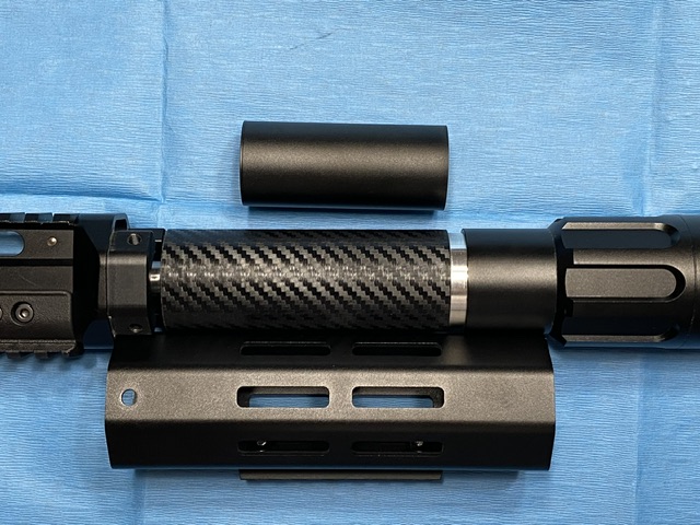

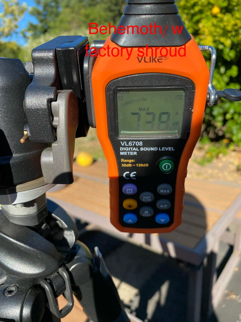

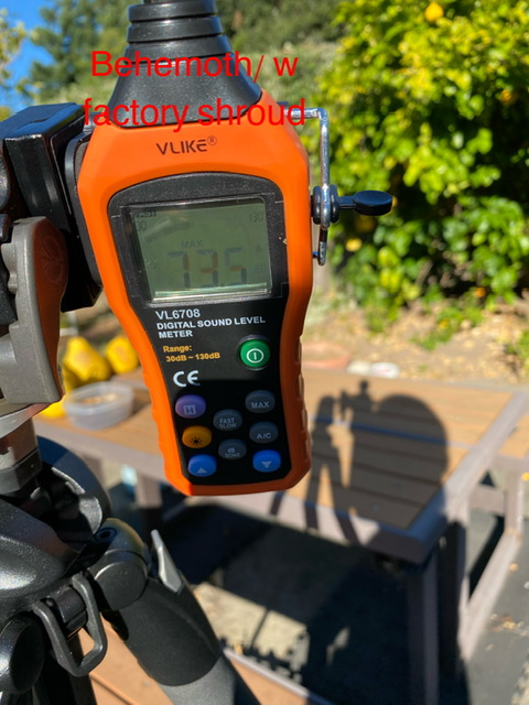

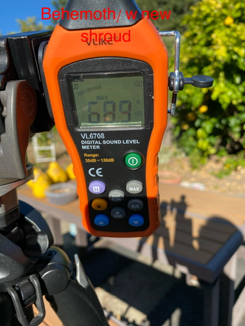

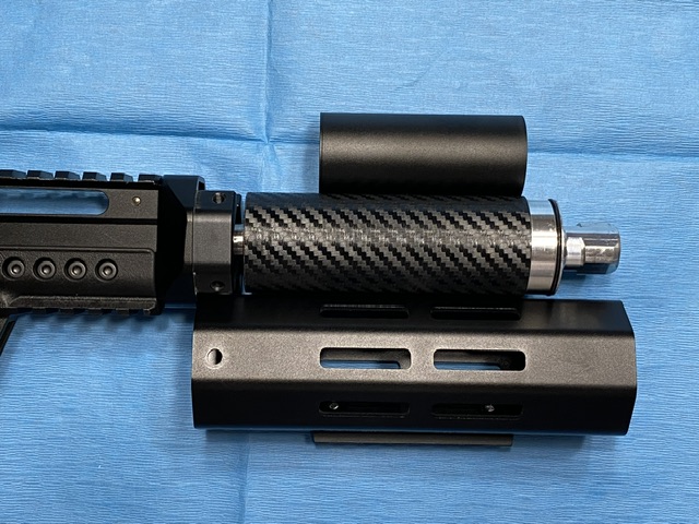

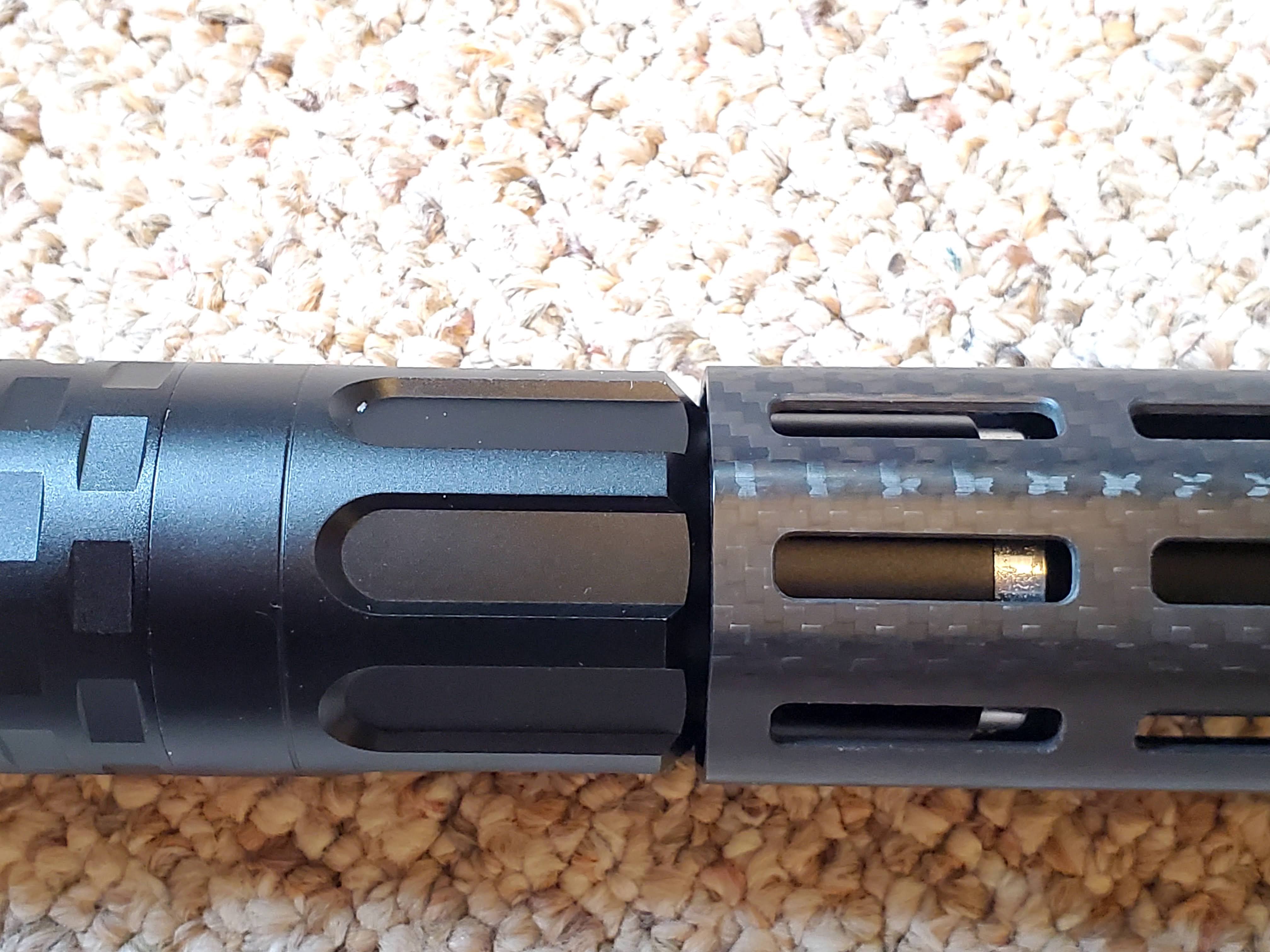

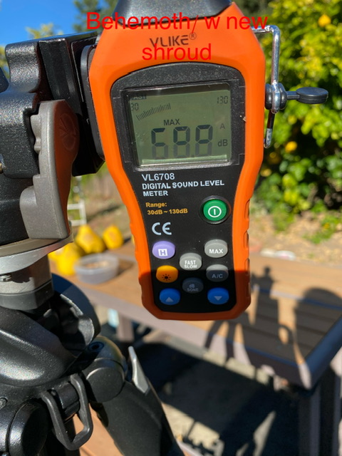

The Behemoth reflex shroud does add suppression as you can see from the photos below when I open up the reflex shroud. Unfortunately the 350mm reflex shroud is kinda short so I made longer and bigger diameter shroud to replace the factory shroud which add to the initial discharge chamber for the Behemoth moderator. This dropped almost an additional 5db on my sound meter during testing with the meter mounted on a tripod 12ft away.

It does, because I ordered the 9mm model but with a 350mm .22 barrel. And per JackK's post about extending the shroud, my rifle came with that. It covers the entire barrel as you can see no silver under the shroud and my handguard does have M-Lok slots. The reason I know is when I first installed the Behemoth I could not get the quick connect off and the entire assembly unscrewed from the barrel. Once all separated a little lube on the Behemoth quick connect solved that issue and back part is secured to the barrel now.Looks like your gun has the monster plenum from the 9mm model. Interesting...
Wait. Are you saying the reflex shroud of the Behemoth is longer with 350mm L2-9 than the Behemoth-Reflex setup you can buy separately? Clearly would prefer the longer reflex shroud. Wonder if that can be ordered separately.... And per JackK's post about extending the shroud, my rifle came with that. It covers the entire barrel as you can see no silver under the shroud and my handguard does have M-Lok slots. The reason I know is when I first installed the Behemoth I could not get the quick connect off and the entire assembly unscrewed from the barrel. Once all separated a little lube on the Behemoth quick connect solved that issue and back part is secured to the barrel now.
A 5db reduction is significant! Does the increased diameter affect usage of M-Loc holes? Perhaps you can share the process making this reflex shroud to the forum. Thanks.... Unfortunately the 350mm reflex shroud is kinda short so I made longer and bigger diameter shroud to replace the factory shroud which add to the initial discharge chamber for the Behemoth moderator. This dropped almost an additional 5db on my sound meter during testing with the meter mounted on a tripod 12ft away.

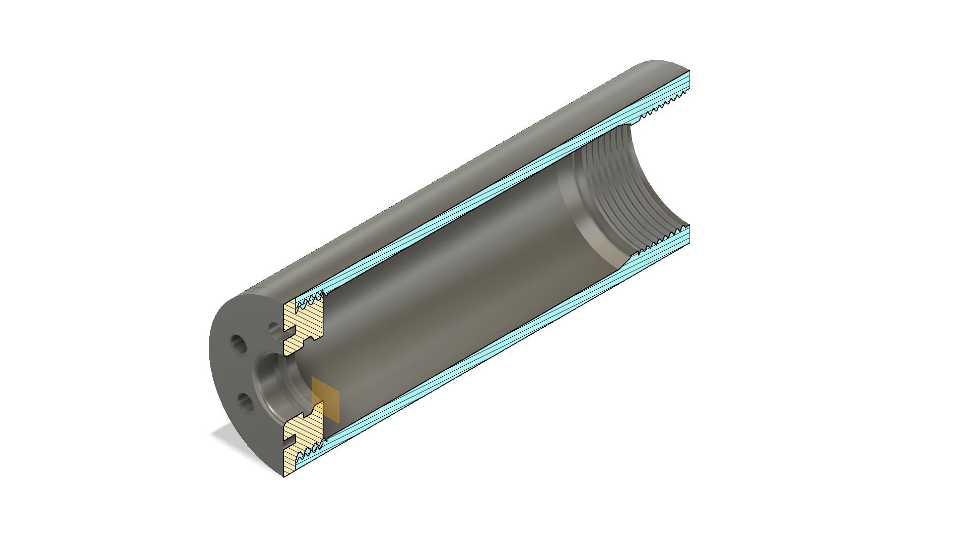

I was surprised at the amount of reduction on my sound level reading just from adding some additional volume to the reflex shroud. The factory shroud is about 32mm in diameter and 76mm long including the end cap. The shroud that I made is about 38mm in diameter and 102mm long. The shroud is attached to the Behemoth reflex QD with 30x1.5mm thread. As for the use of the M-Loc with the bigger shroud I have no problem using the rail, I have a picatinny rail attached to the bottom of the handguard. Some of the longer M-Loc screws might have to cut down. Both should fits inside the handguard without the barrel showing through the M-loc opening. For my sound testing I had a sound level meter attached to tripod at the same height as my shooting position 12 ft away and fired 2 shots each with factory reflex shroud vs the bigger shroud. The reading was 73.8 & 73.5 vs 68.8 & 68.9 db.A 5db reduction is significant! Does the increased diameter affect usage of M-Loc holes? Perhaps you can share the process making this reflex shroud to the forum. Thanks.
Cool. So, where did you source the tubing how did you fabric the CF barrel to be compatible with Tri-lug endpiece? And how did you fabricate the perforated endpiece? 3d? A 5db reduction would well be worth the investment to DIY this.... The factory shroud is about 32mm in diameter and 76mm long including the end cap. The shroud that I made is about 38mm in diameter and 102mm long. The shroud is attached to the Behemoth reflex QD with 30x1.5mm thread. ...

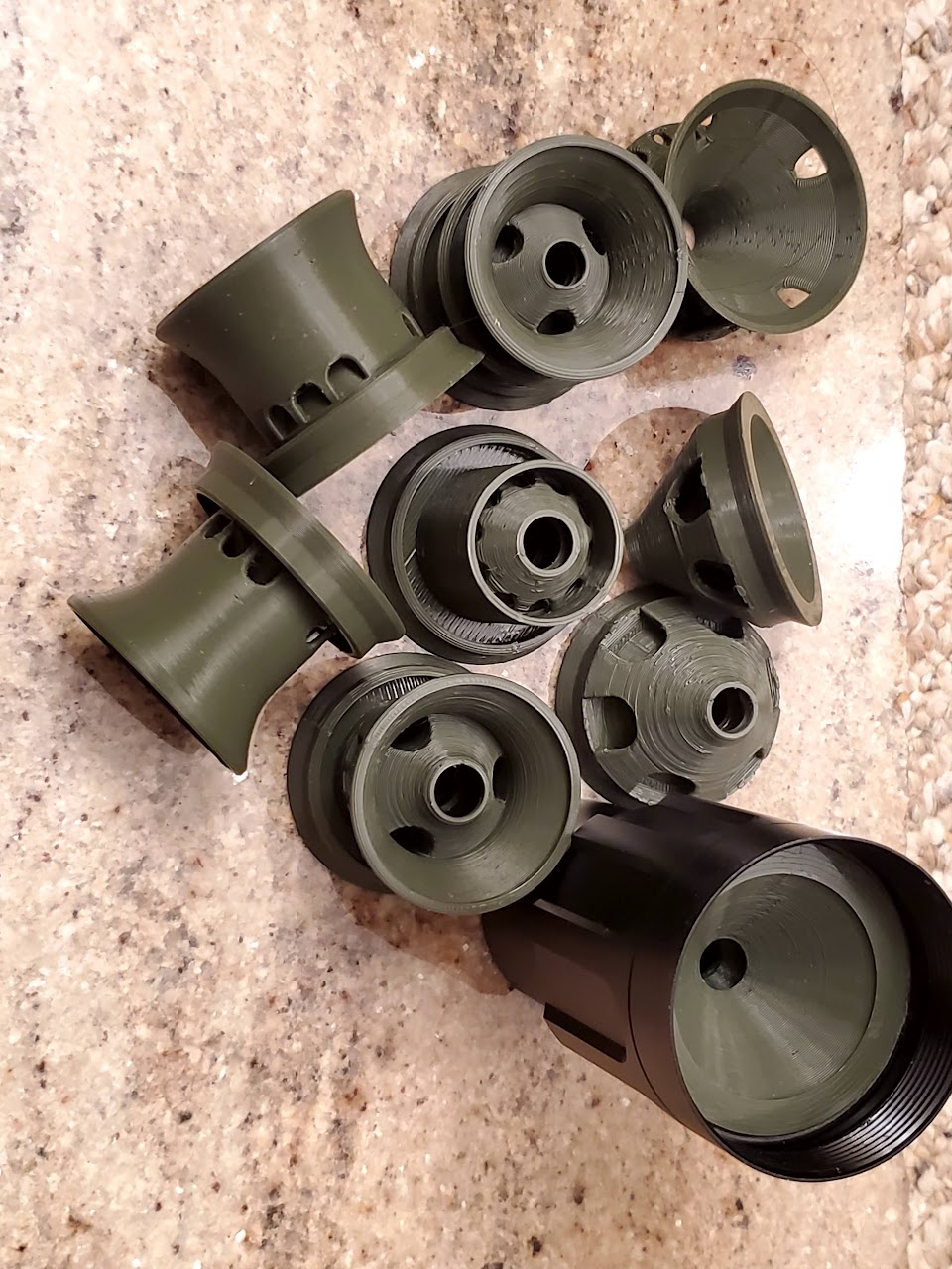

Here is a cut away view of the shroud
