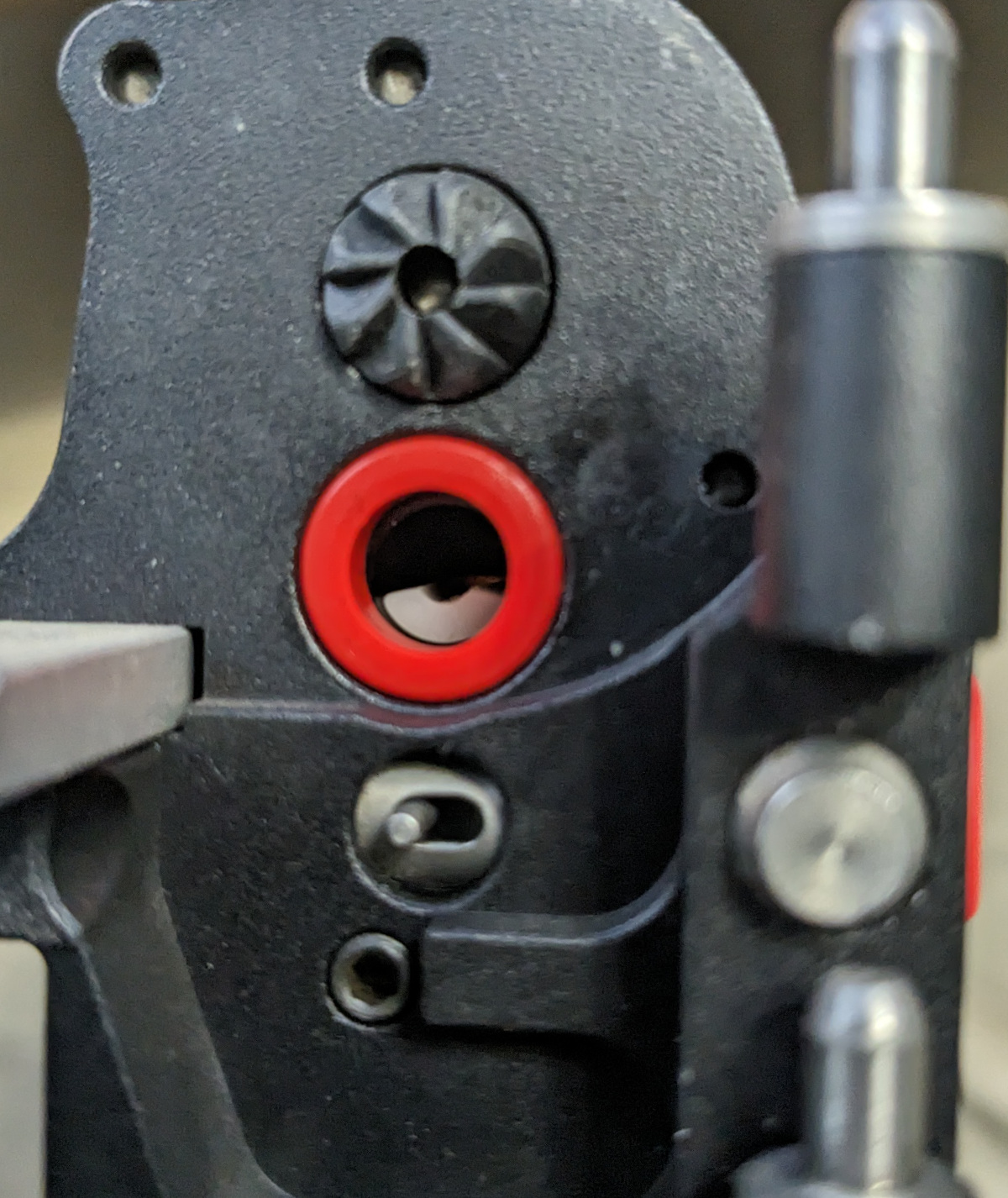

Yeah barrel is definitely choked, so its absolutely pellets only then, my only worry with that is keeping it in the sweet spot 800-900 fps with the best pellet options, kinda only allows me to reach 25-32 ftlb before my fps start going way up - anyway, I'm sure I can crank the power when I get some unchoked barrels - I bought the gun 2nd hand, very low use age, like new condition, I'll attach a pick see if anyone can tell me if its got the dog and bone thing, ive heard of this, I'll deffo wanna go 30cal soon, what are my options if it has this dog and bone thing?
You need to look straight into the hole. See the white thing inside the red "puck" in this picture? That's the dog bone and collar.
But yeah your rifle looks lightly used.
So this dog bone and collar thing, am I best leaving it in or taking it out? If I wanna be able to switch between 22 and 30?
You'll need different jetting for the .22 vs. .30 unless you're okay with the .22 wasting an enormous amount of air.
When you change the jetting you can take the dog bone and collar out. It's a pretty easy thing to do.

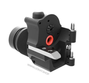

Another thing you could do is get a second forward plug (pictured) or perhaps the entire rear end (stock), one for the .22 and one for the .30. That way you'd have less fiddly work to do when switching between calibres. It's what I do.
The advantage of having a 2nd stock over just the forward plug is you have the regulator in the stock, so you can keep all your settings.

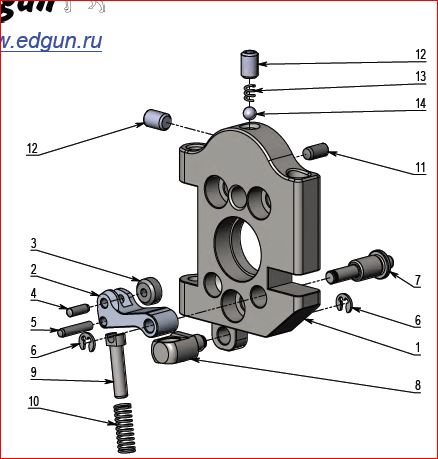

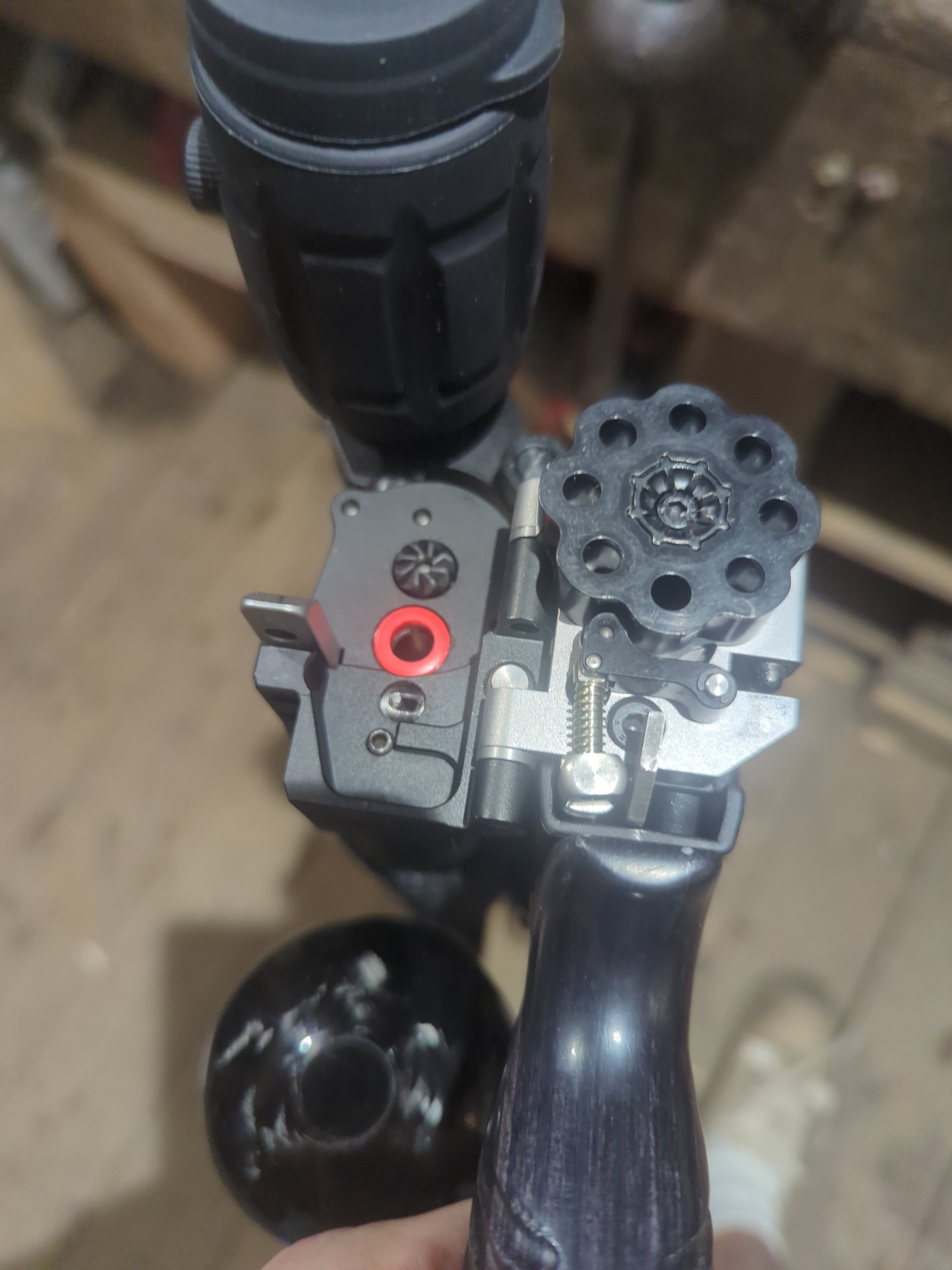

Also chasing an indexing issue on a used Leshiy 2 and have been working through the indexing video. The indexing wheel was dented, but replacement did not fix. Video states that the gear spring should be 10mm +/- 0.5, however both the installed spring and the one in my repair kit are around 8.35mm (calipers zeroed, but maybe not accurate?) Additionally, the two pins near R2D2 are not budging.. suggestions? Tried punching them out with an Allen key and pulling them out with pliers.
Many people pumping up the Regs because having short barrels. But most mistake is in how to calculate the jets (Dwell).
The indexing mechanism won't move below 60-70 bars just not enough juice to feed both the projectile and the indexing, and that mechanism will advance = accelerate with 140-150-160 bars and higher some people have it on 180.
Either you manage your Dwell with jets (lower Reg), or slow down the mag with #12. This all assumes you have no worn pieces already somewhere inside the mechanism.
Edgun Spain recommended stretching the gear spring to the recommended length. My real problem though was the R2D2 spring, the spring was compressed so much (14.69mm) that I stopped to question if the replacement spring even belonged there. Once swapped, the #12 adjustment was easy. If everything else is checking out and #12 isn’t doing anything significant, check that spring!
