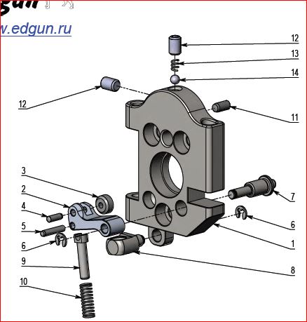

That little ceramic ball goes between #10 (sitting on spring inside hole) and #11. A simple trick how can you make it stick to the other piece? lube it with silicon grease and stick it on the hole in #11
Ah thank you so much, you genius! Well either you are a genius or I'm incredibly stupid! I saw the ball appear from one of the holes in part 7, it must of already fallen out of position and landed in one of them as I disrupted the assembly with my clumsy hands, I just assumed it went in one of those holes! - also I appear to have no part 33! And I am running a 22 barrel, is this a potential problem? Best regards and thank you so much for always being so helpful

You don't need #33, that's the "dog bone". But if you want to tune your .22 to use minimal air, it would be good to acquire one. You can 3d print them -- just search Leshiy on Thingiverse.com and you'll find the design.
In .25 or larger calibres you don't want to have #33 in your gun.

PS the gun wouldn't fire at all the way I'd put it back together, I'm assuming due to the ceramic ball being out of position...

Ah ok, no problem, I'm gonna get a 30 barrel soon anyway so I'll prob swerve it for now unless I go back to 22

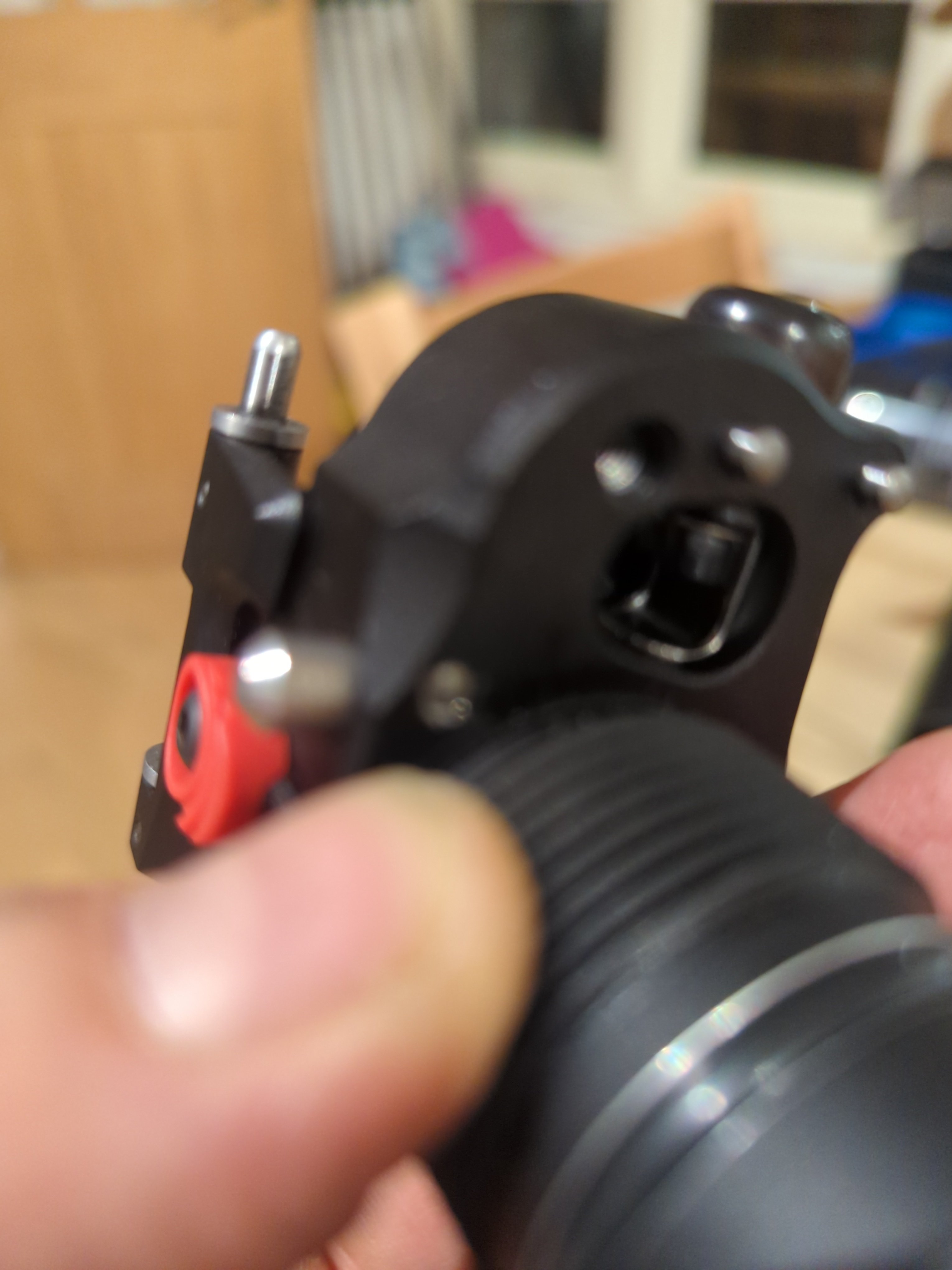

the gun wouldn't fire at all the way I'd put it back together, I'm assuming due to the ceramic ball being out of position... And do you have any tips on removing the pin to release and replace part #22? Its sooo stiff I cannot get it to budge at all
Has anyone ever had trouble trying to tap this pin out to replace the locking pin when switching out to a behemoth set up so the gun will close properly - ive watched a YouTube video and the guy made it look easy, he didn't even need a vice, ive had it in a vice and wacked it with a pin punch and its just not moving, if I tighten it any harder in the vice or hit it any harder it feels like I'll start doing damage, any ideas??? Sooner than later!
I didn't use a vise. I used a couple of sample blocks of synthetic patio board I picked up from the hardware store and situated the flat part Forward Plug assembly on the edge of the blocks so the assembly could lie flat. I then used a pin punch with a tack hammer with some firm strikes. The blocks are hard enough to provide impulse counter force, but softer than aluminum to protect the assembly. Use a large pin punch to hammer the pin back in till it's nearly flush and use the correct sized punch to tap it flat.
Ok well I managed to get the mechanism with the ceramic ball back together and its working again, couldn't get that pin out yet though, going to take it to a gunsmiths to let them do it! I just dont have the kit to do it, maybe mines particularly stiff compared to some others
