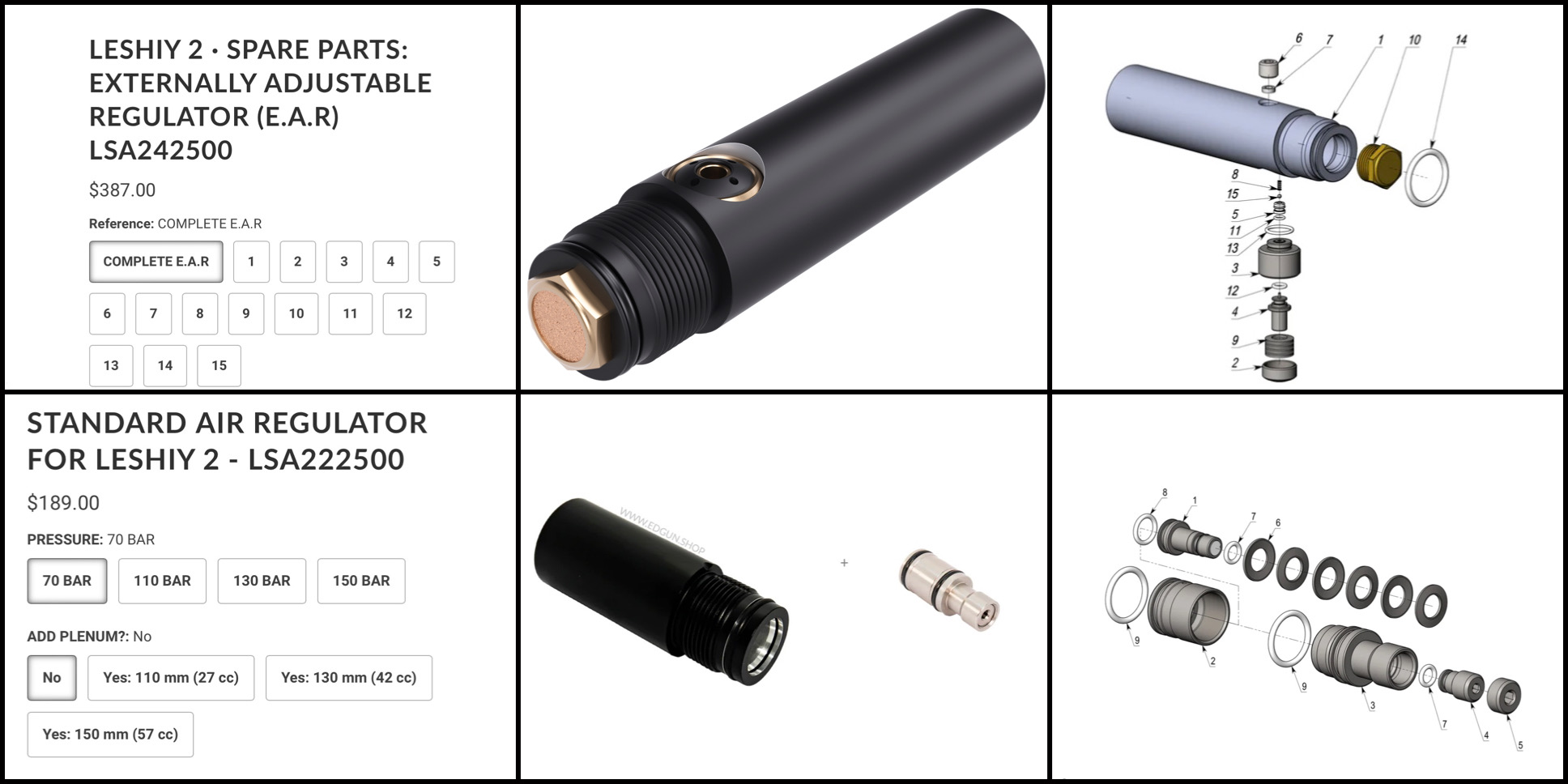

I have an EAR regulator for the Leshiy 2, but I only use it for tuning purposes. Once I figure out the settings I like I migrate back to the standard regulator. So I haven't had the time to notice creep.
For clarification, are you just removing the pressure gauge, from the EAR, or are you actually replacing the EAR with (migrating back to…) the Standard regulator?
Externally Adjustable Regulator Tuning:
Standard Air Regulator Tuning:
It's as BigHun suggests, I migrate back to the standard regulator.
I think the EAR is great for quickly finding what works, but once I've found what works I prefer the "no fuss" standard regulator.
I have the EAR and two standard regulators on hand, set to the various standard tunings I use.

I much prefer the EAR (Huma-Air Raptor), for the ability to monitor both the regulated and the tank pressures.
My L2 is used for backyard pest control. I have not found a need for faster regulator speed.
What use case qualifies the need for speed?

I need the cycling speed from the E.A.R. The Raptor alows rapid fire - but the fps drop is too big - so ill get to many flyers. 8 shots with 1/2-2 seconds between shots makes the Raptor drop 10-20bar. The E.A.R drops 4-5bar. I have tried several times to install the E.A.R - new o-rings, ball, plastic bottom and so on. It always creeps :( So I´ve made a "claim" to get a new E.A.R regulator. It started to creep 1 week after purchase.

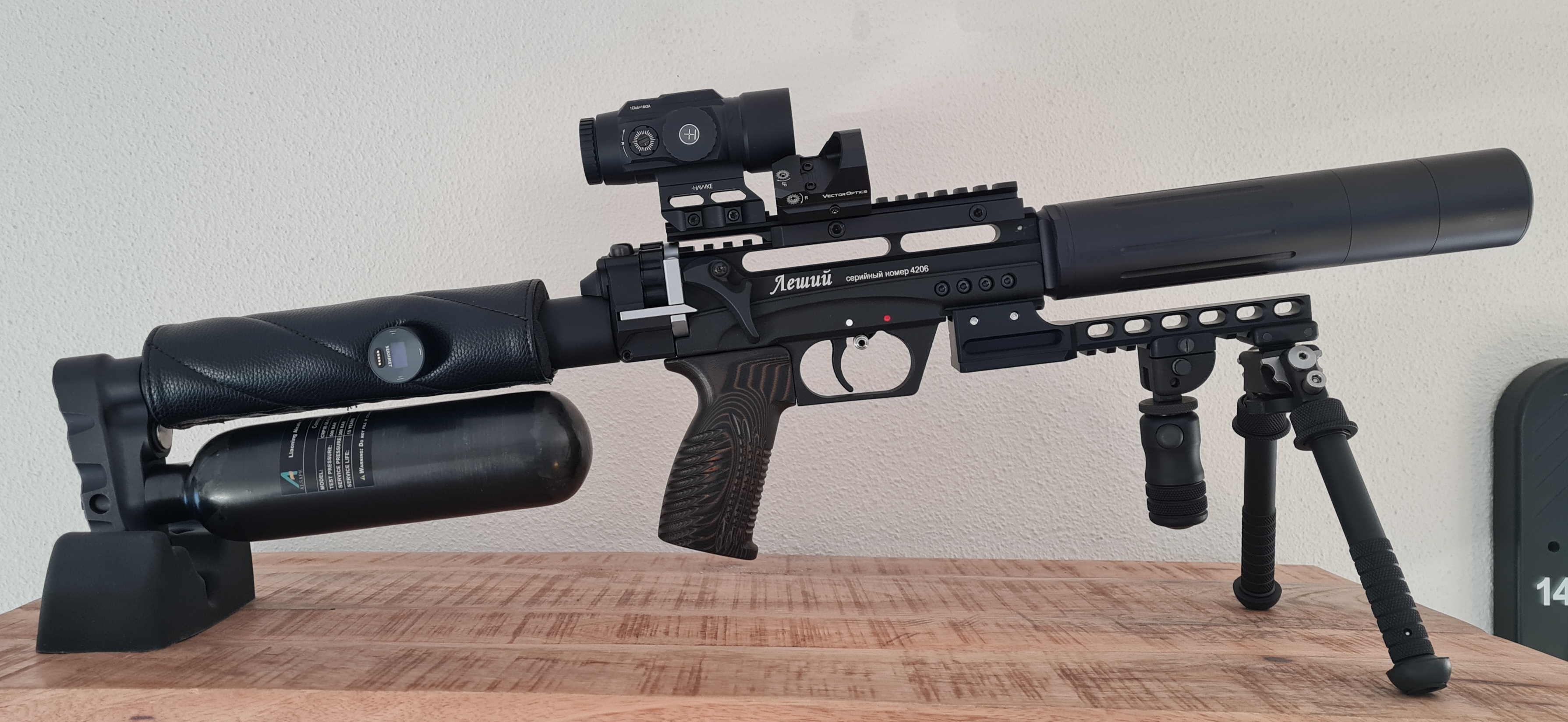

I bought the REPR (EAR) Reg, because I wanted to learn tuning the Leshiy2 without much degassing (as the old Reg would need).
Also I wanted to make a good Target gun from that L2.
After a good year of playing with many tuning scenarios, and when I gained my confidence with jets, I could finally remov that stupid gauge that sticks out on wrong side !!! and now I am shooting the L2 with the radar only.
And finally I am very happy with results, I am shooting paper rings only, and with that AR style trigger I am getting consistent sub MOA @ 50 meters.
If you looking for a fast Reg refresh time, the old Reg would be the best option. Not sure what this latest revision can do, but honestly it look impressive that you can remove it from both side... what is a good use for it this way? we about to discover....
