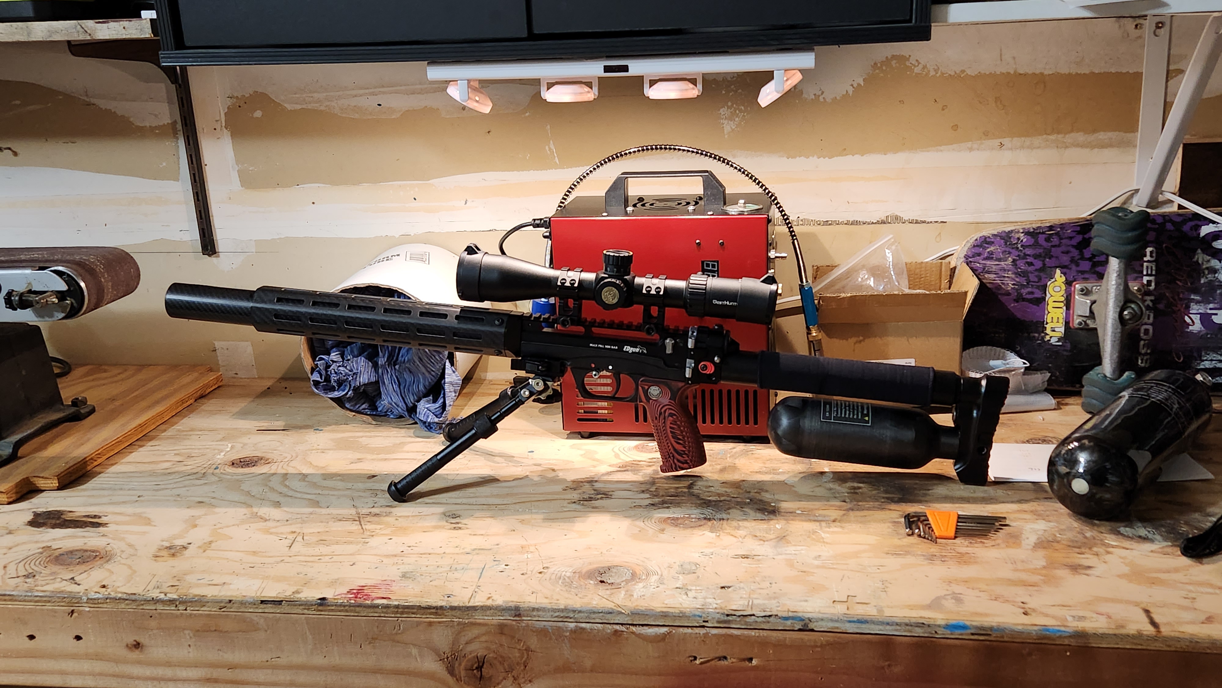

Got the rest of my parts in today and tuned it up. Homemade silencer needs larger ports to breath back into the rear chamber better but seems to be performing about as good as a behemoth reflex possibly?
450 mm barrel .5 and .6 jets around 125 bar on the reg pushing 20.2 nsa slugs at 910 fps. Just need to take it out and have fun now 🫠

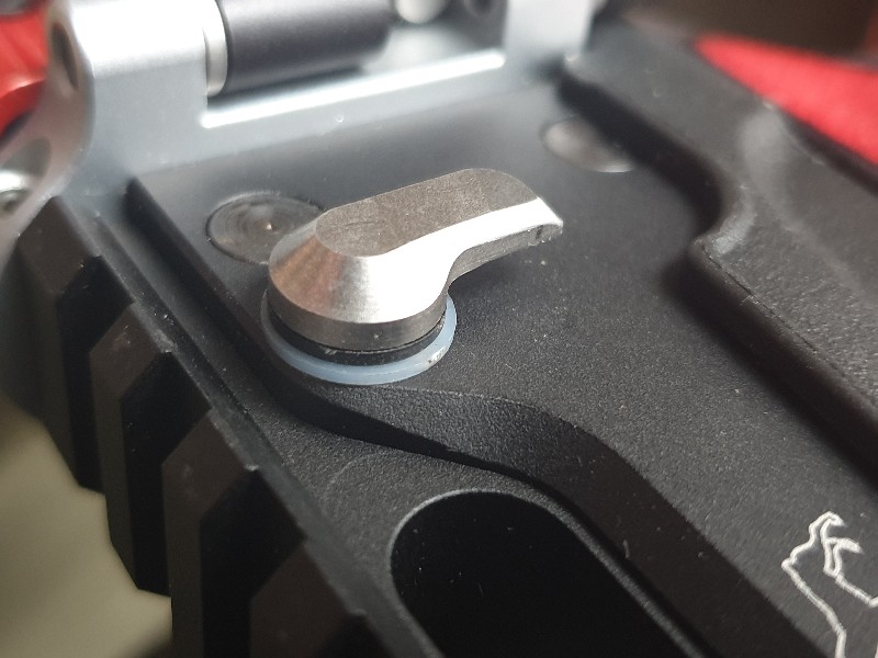

I had a problem with the Leshiy not latching folded. With the handguard bolted on (and I do like the little handguard - tried without it and don't like the limitations on holding the rifle at all, just too tiny), the stainless latch wouldn't quite grab, by about 0.7mm. So digging around in parts bins I found a 0.7mm thick nylon washer about the right OD but with a small ID. Used a small curved carving gouge to cut out the middle, just big enough that it slides over the shaft of the stainless latch, between the tiny black metal washer already on there and the receiver. Perfect. Latches snug when I fold it. And the triangular junction between that shaft and the folding release trigger is more than enough that the small change won't weaken that.
If I understand your comment I believe what you’re looking for is this-
https://www.edgun.shop/products/pin-locks-for-leshiy-2
You need the 16mm, you probably have the 15.25mm
