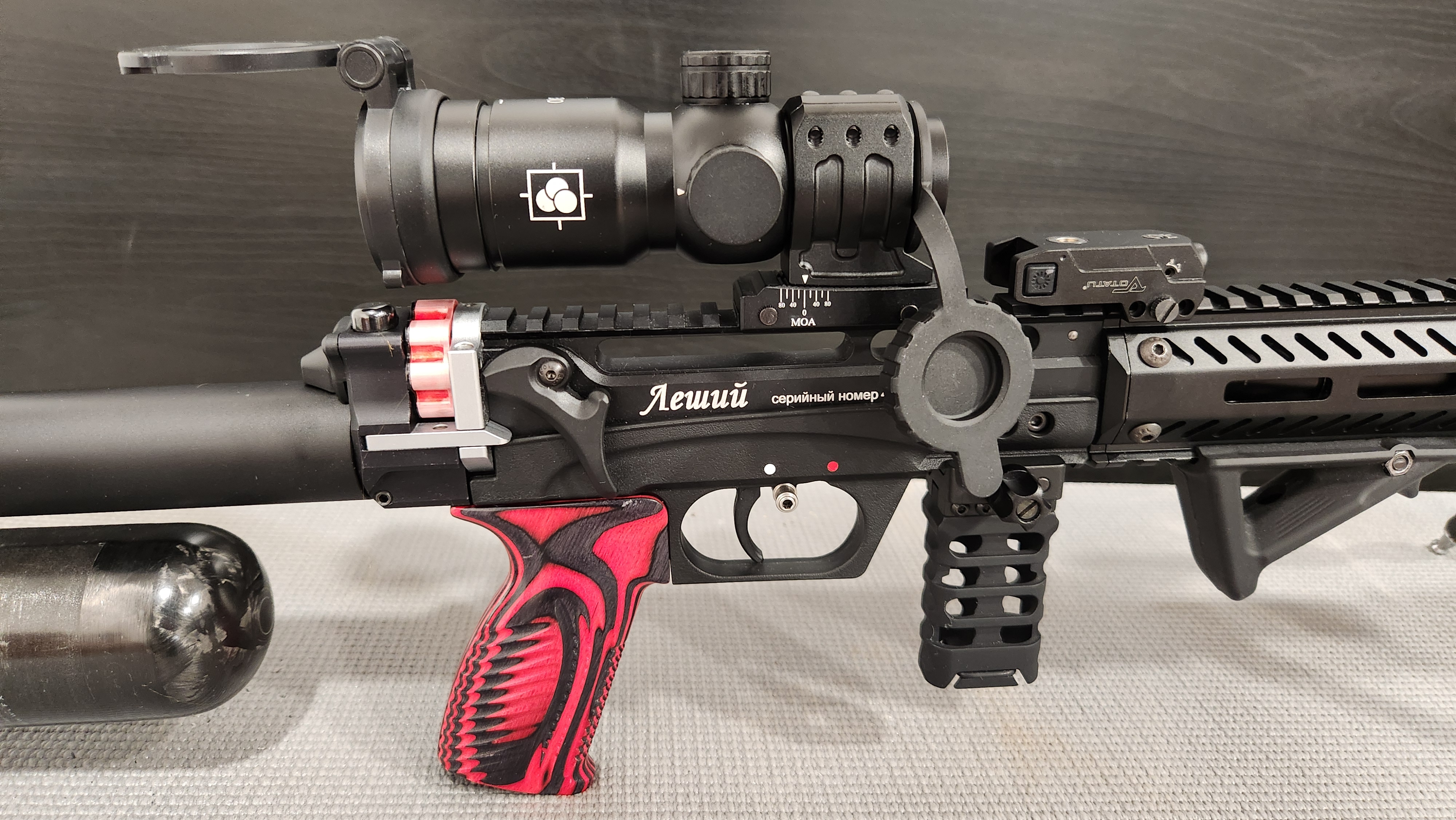

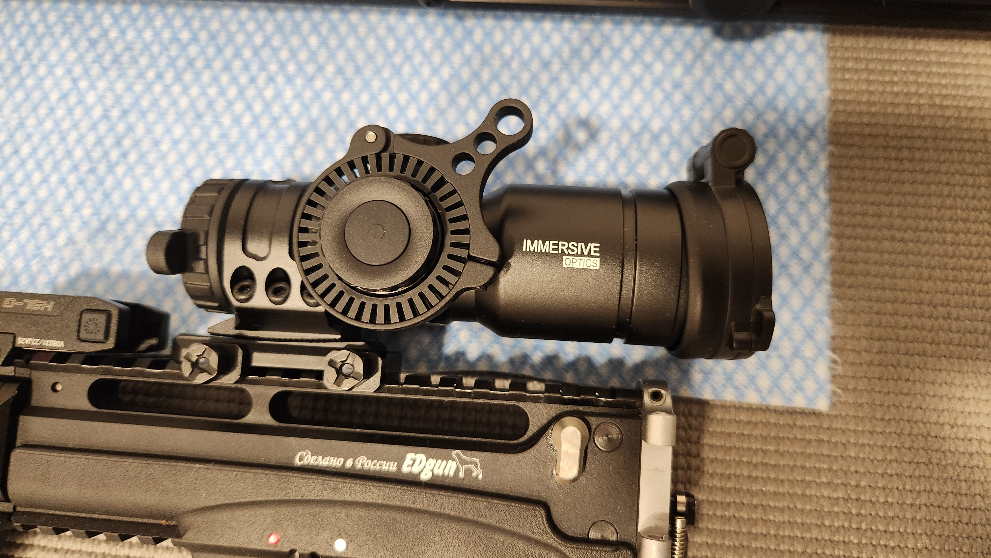

So you made the wheel with lever? Looks like a very finished product.

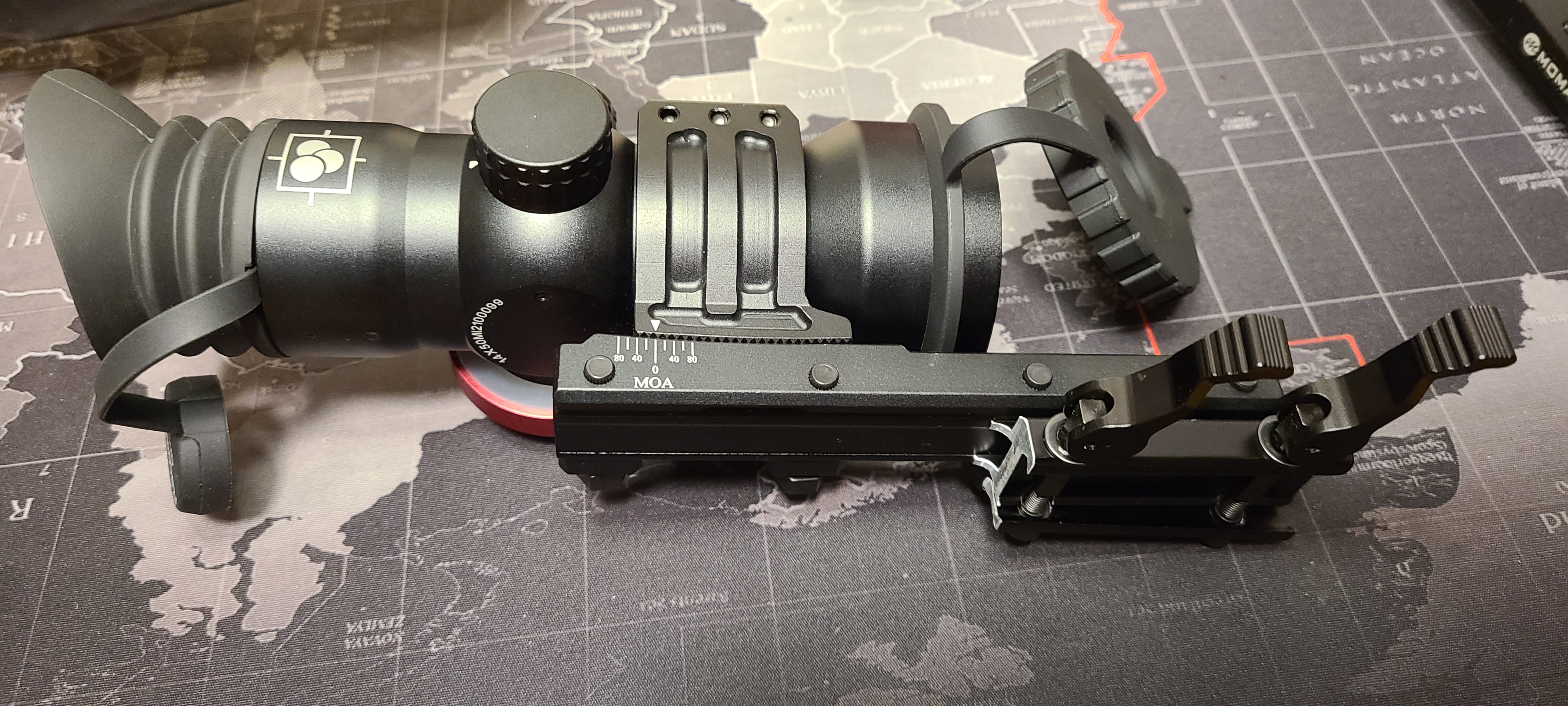

My Immersive 10x40 (branded Element Immersive) arrived today. Had to knock out the two bolts on the smallest mount and tap them into the other side to get the knobs out of the way of folding the stock, while putting the scope mount as close as possible to the magazine. Neither of the longer supplied variable-MOA mounts would work, owing to the magazine plate and magazine. I could order a riser extended mount, but like the scope right there. Gets my eye right in the sweet spot without having to crane my neck unnaturally forward, thanks to the Leshiy's rather short length of pull. Folded, it adds a bit to the length, but it's still only 16" without that ugly brake mounted, 16.7" with it. Got to get a M14x1.5 thread protector to replace that useless thing...
The scope's side focus knob has white lines, and a 6 at the bottom, infinity symbol at the top. I suppose with everyone adjusting focus on the ocular lens to suit their particular vision correction needs, numbering the knob wouldn't make much sense. So is your big wheel numbered for your setup? Seems like something I'd like to get marked accurately at some point to enable use of the focus as a rough rangefinder. Making or buying a wheel with room for numbers on it would be a nice trick.

I wish the Elements base was a QD. Love my Burris one-piece QD bases for my TNW ASR and my Sig Cross. Makes it so easy to arrange bits in a backpack while hiking, and they return to zero very consistently on both rifles. Oh well, like I said the overhang isn't much, with the Leshiy now just 16" OAL folded with the scope. Easily fits in any pack I use - the TNW is 19", so the Leshiy is easy by comparison. And I LOVE the view through the 10x40! Fantastic scope.
Got out the boresight green laser kit yesterday and checked the Elements scope at 8 yards, getting it close, then at 65 yards against a neighbour's fence and dialed it in a bit closer. Then a shot on paper inside at 8 yards. Needed 2 clicks Left, 16 clicks Up. Second shot, still needed a minor adjustment. Did that, and third shot (with 1.2" holdover marked on the paper for this range, according to Chairgun's calculation) was dead on the bull, 1/4 of the hole in each quadrant around the crosshair I'd drawn for a target. So at least I should be on paper at 50 yards, whenever I get an opportunity to go out and properly shoot this thing.
And once that's done and I've shot for holdovers to confirm various ranges, I can set about marking the focus wheel somehow. Maybe just a plastic wheel bonded to it with some Sugru silicone putty, with marked distances on the side for crude rangefinding.

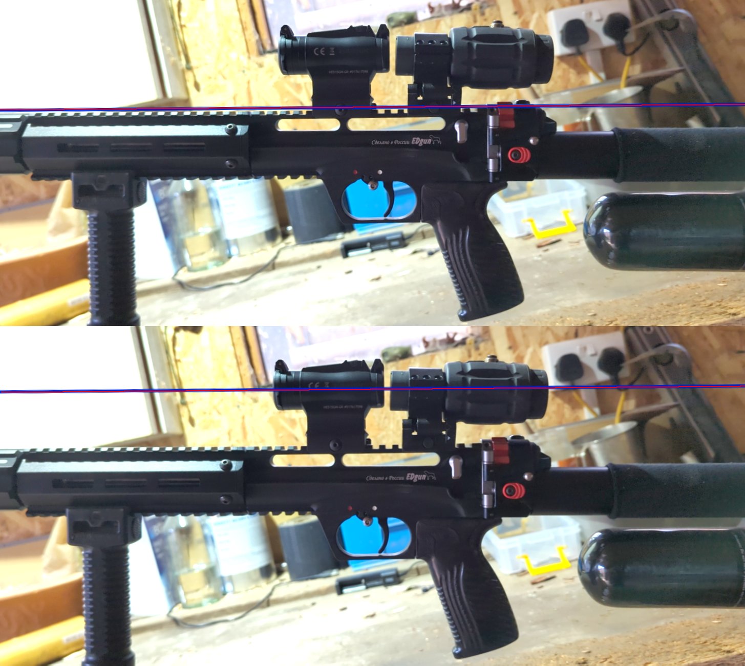

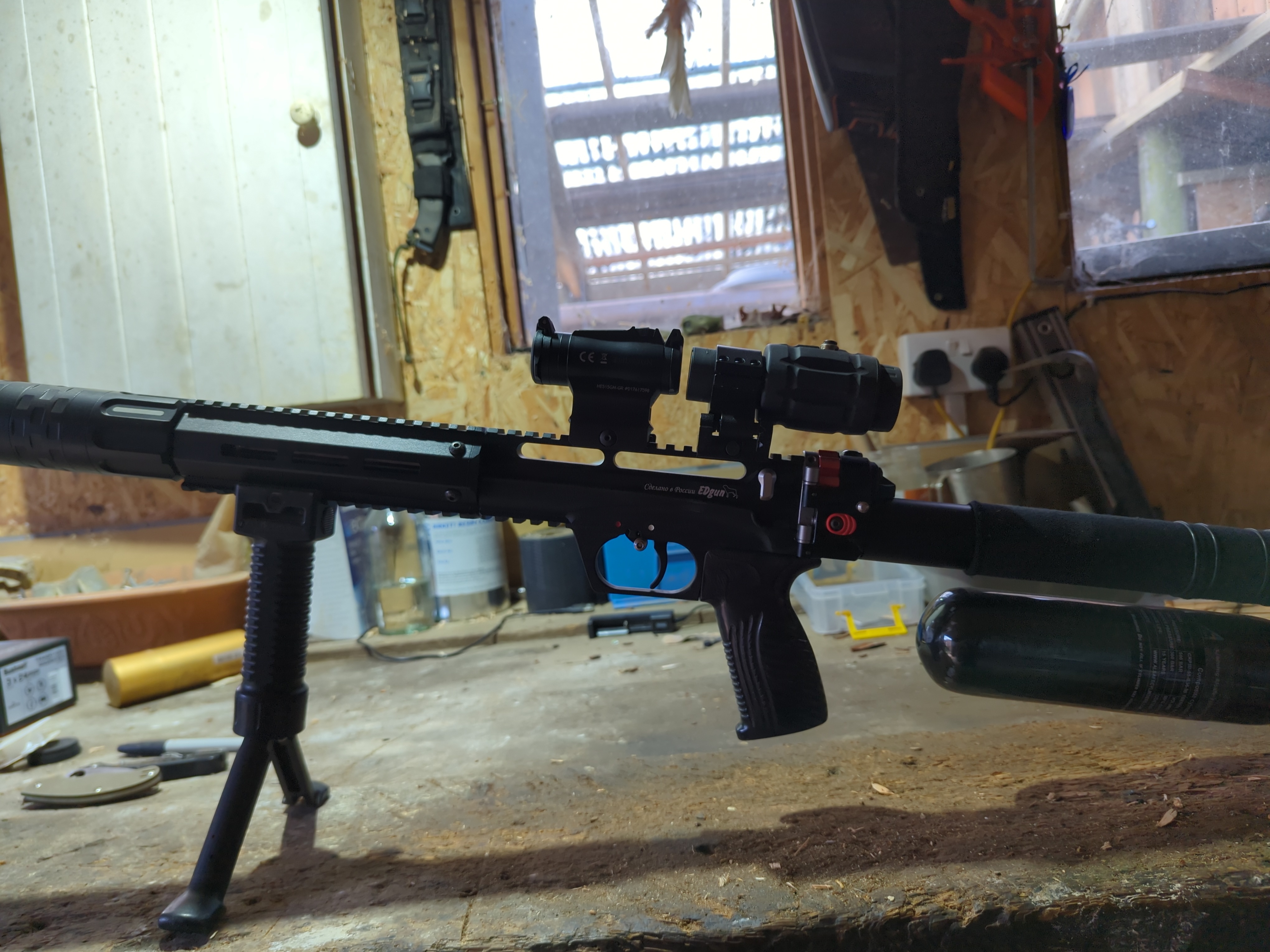

Well I have mounted the Bushnell magnifier behind the holosun - they work just about but for some reason I can't seem to change or adjust, the Bushnell seems to sit slightly slanted so that I can't centre the dot, it sits low down in the field of view, but it works

Maybe you can fix it with shim plates. You would need to measure both centerlines individually.
I copied your picture, levelled it, and drew a line parallel to the optic rail and then through the optical centres. The dot sight looks fairly close to being parallel to the rail. The magnifier isn't anywhere near parallel, pointing upwards about 1.8 degrees according to my screen protractor. That's rather amazing. I've never seen such a crooked mount.
Really appreciate the responses and suggestions guys, Its definitely a really crooked mount, I'm think maybe order a new mount, possibly a holosun mount which I dare say will put the Bushnell magnifier in exactly the correct position..... I can't see why there would be any incompatibility? Either way I'm not particularly impressed with the mount supplied by Bushnell even if it was not crooked its still not great....
