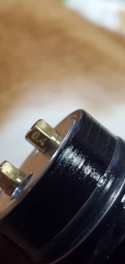

No thanks, these jets are the standard size for .25
I read that the guns from EDgunwest were 0.4 jets and Spain ( has a different configuration and was mentioned in their site that the .25 came with only 1 jet and a plug) has these in .25 but mine came from Russia so I was curious were there anything different, I have yet to open up the rest until i need some maintenance later.
...usually the jets that come stock on the Leshiy 2 are mis-labelled, or not labelled at all...The only jets that are properly labelled come with the jet kits.
I assume when they made the jets and which size didn't passed the QC, either the engraving or the drilling didn't match, we call these "misslabeled"
Why to throw away if still working? And btw people will start swapping them around very soon, anyway ;)
