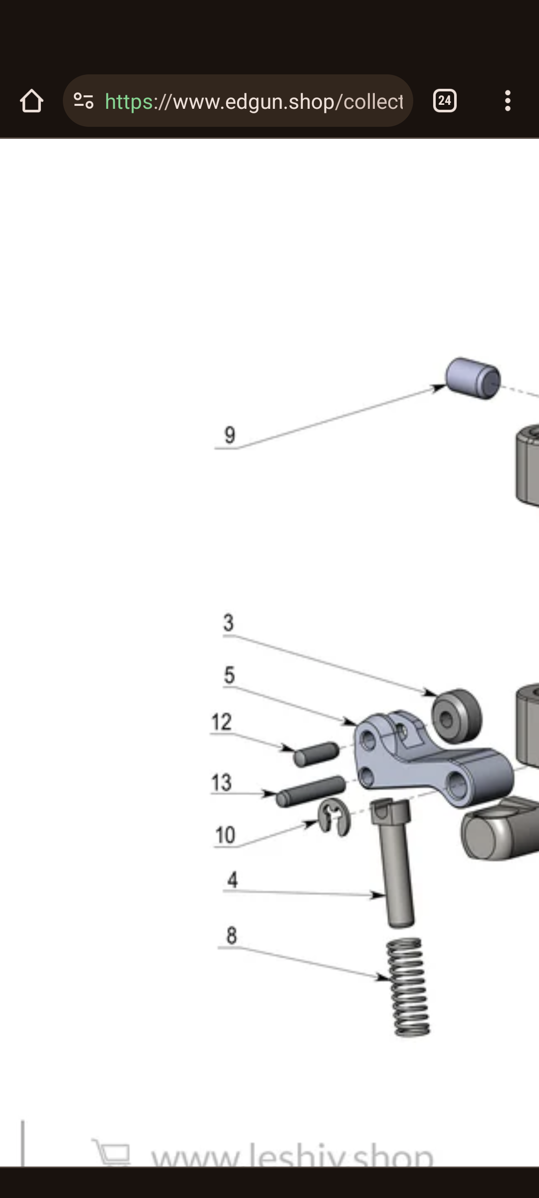

Ok so I have just swapped from a 22 standard walther barrel with 0.7 jets to a 30 alpha precision barrel with 0.2 jets, I wound the EAR a little and am averaging 810-820 fps with hades pellets, I was careful with slotting the barrel in etc, however I have an issue the brand new standard mag is not indexing - I get one shot and then the next shot is just air since the mag hasn't rotated, it did index a few times at first but now its not at all? Any ideas? I already established that my forward plug is missing the dog bone price, it may still contain the collar, but dont fancy opening it up if unnecessary, does anyone have any ideas as to what might be happening?
Thank you for your response I just watched edgun Wests indexing video where he goes through everything to check, before even getting to the retention spring adjustment, I have found that the wheel (part 3 in the diagram) is in quite a state, several flat spots and generally worn out, not sure how ive done that or why indexing only just became an issue, but looks like I need to replace this asap as apparently it can over or under cycle and actually cauce the pellet to hit the back of the barrel and with high pressure I am guessing some serious damage could happenIf you are sure it's not barrel friction then the next most likely culprit is that because you modified your air pressure and jets (timing) you might not have enough energy in the system to get the magazine to rotate. There is a little screw that adjusts the tension on the magazine. If you look at the parts diagram it becomes clear which part needs adjustment.
Pic not great but flat spots all around itThank you for your response I just watched edgun Wests indexing video where he goes through everything to check, before even getting to the retention spring adjustment, I have found that the wheel (part 3 in the diagram) is in quite a state, several flat spots and generally worn out, not sure how ive done that or why indexing only just became an issue, but looks like I need to replace this asap as apparently it can over or under cycle and actually cauce the pellet to hit the back of the barrel and with high pressure I am guessing some serious damage could happen

Apparently its easily done by inserting barrels too, the O-ring on the standard barrel has a gap and the alpha barrel has a flat edge in one area, these are to be able to slide it past the wheel without scuffing it, so I likely did some damage changing barrels, I've actually ordered a full spare parts kit so I can replace everything that gets more wear and tear - I need to up my game with leshiy care!I think that kind of wear comes from roughly removing and inserting the magazine. You can be a little more delicate, carefully angling the magazine to avoid that problem. Or use your other hand and pull that little arm out of the way.
