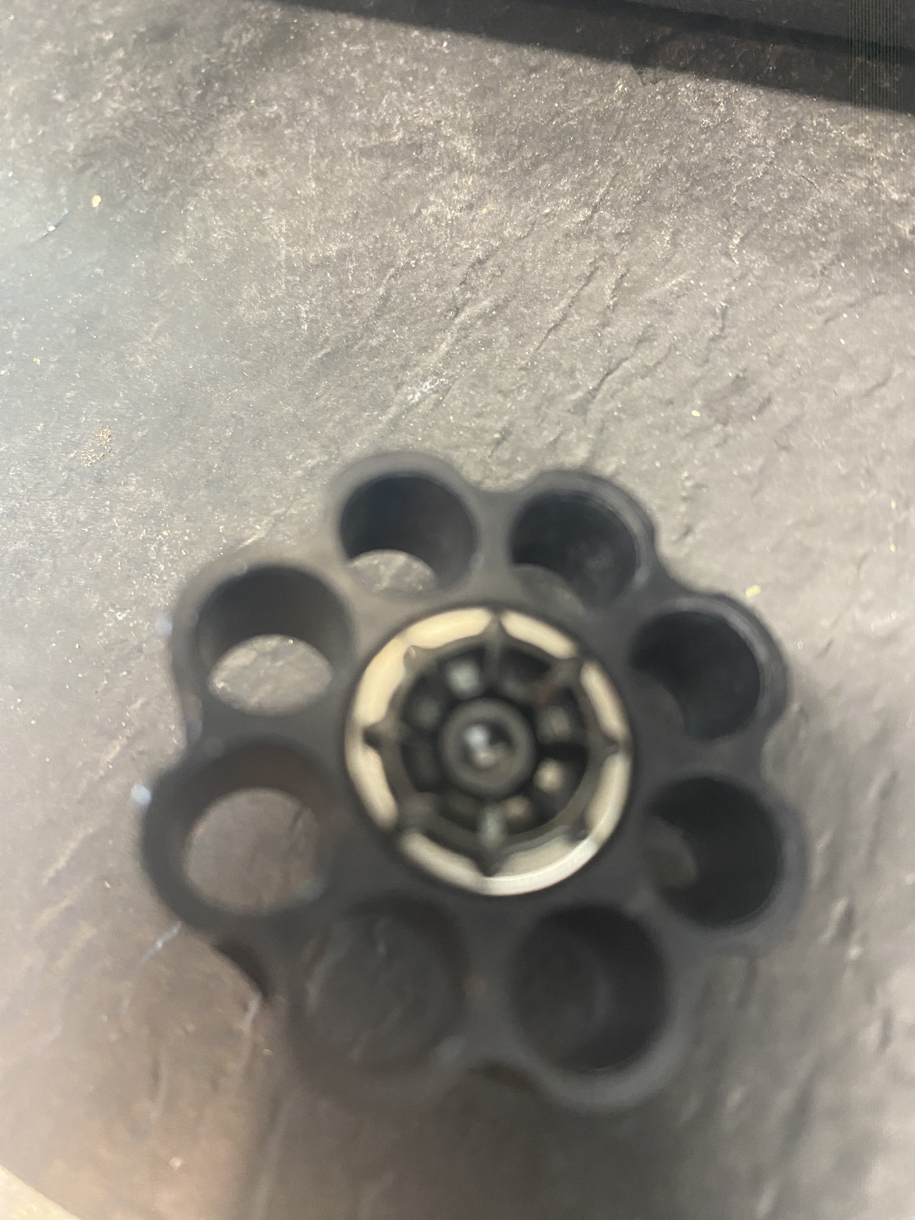

So has anyone got any experience in replacing the wheel on the mag mechanism - my replacement has arrived
Upvote 0
I have done it a few times. It’s not difficult at all.So has anyone got any experience in replacing the wheel on the mag mechanism - my replacement has arrived
Yeah my replacement wheel is another nylon type one, I would like to find a metal option - do you know the spec I need to search to find online? I bet Amazon/ eBay etc will have them for pence!My indexing wheel arm is plastic, noticed that when I replaced the delrin wheel to a steel bearing.

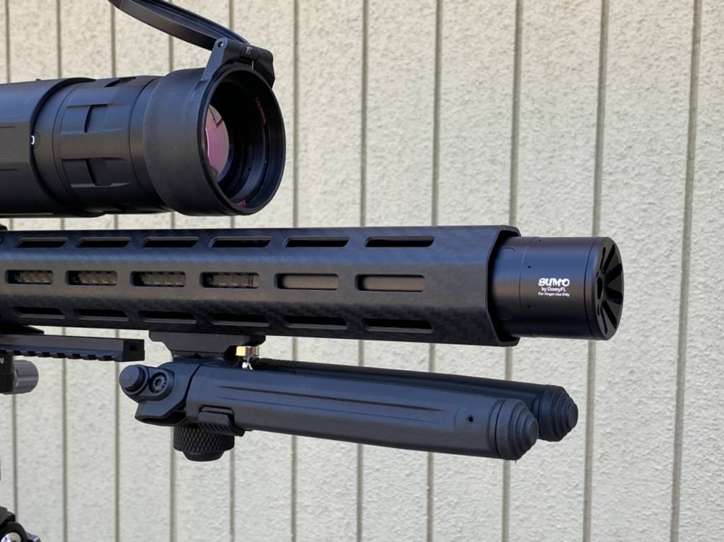

Can you make this for a 500mm barrel?Scotty,
The blowback shroud that I made for the Leshiy 2 is designed to go inside the CF handguard so will not interfere with your Leshiy 2 to be able to fold as long as you are able to fold the Leshiy 2 with CF handguard installed.
