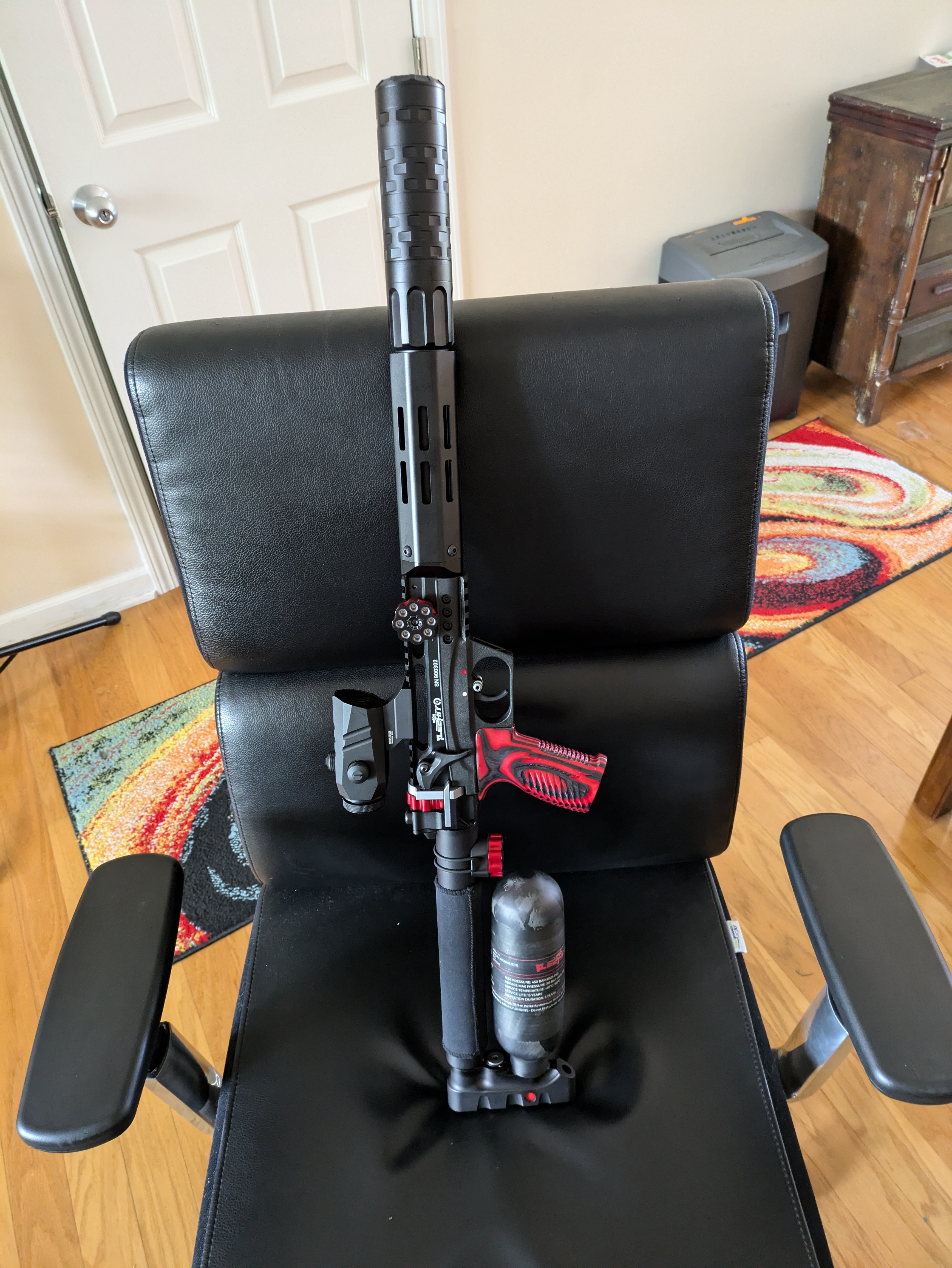

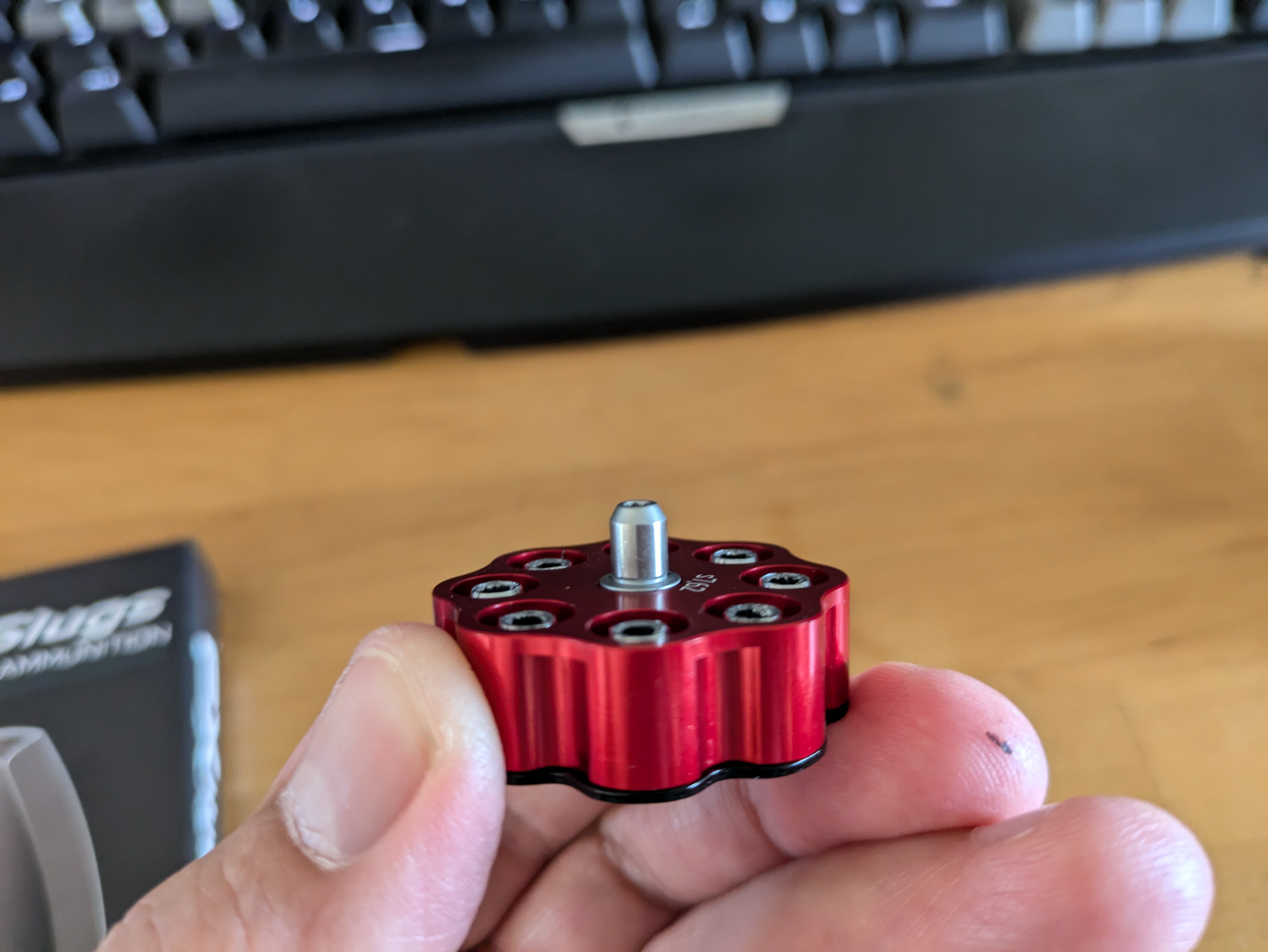

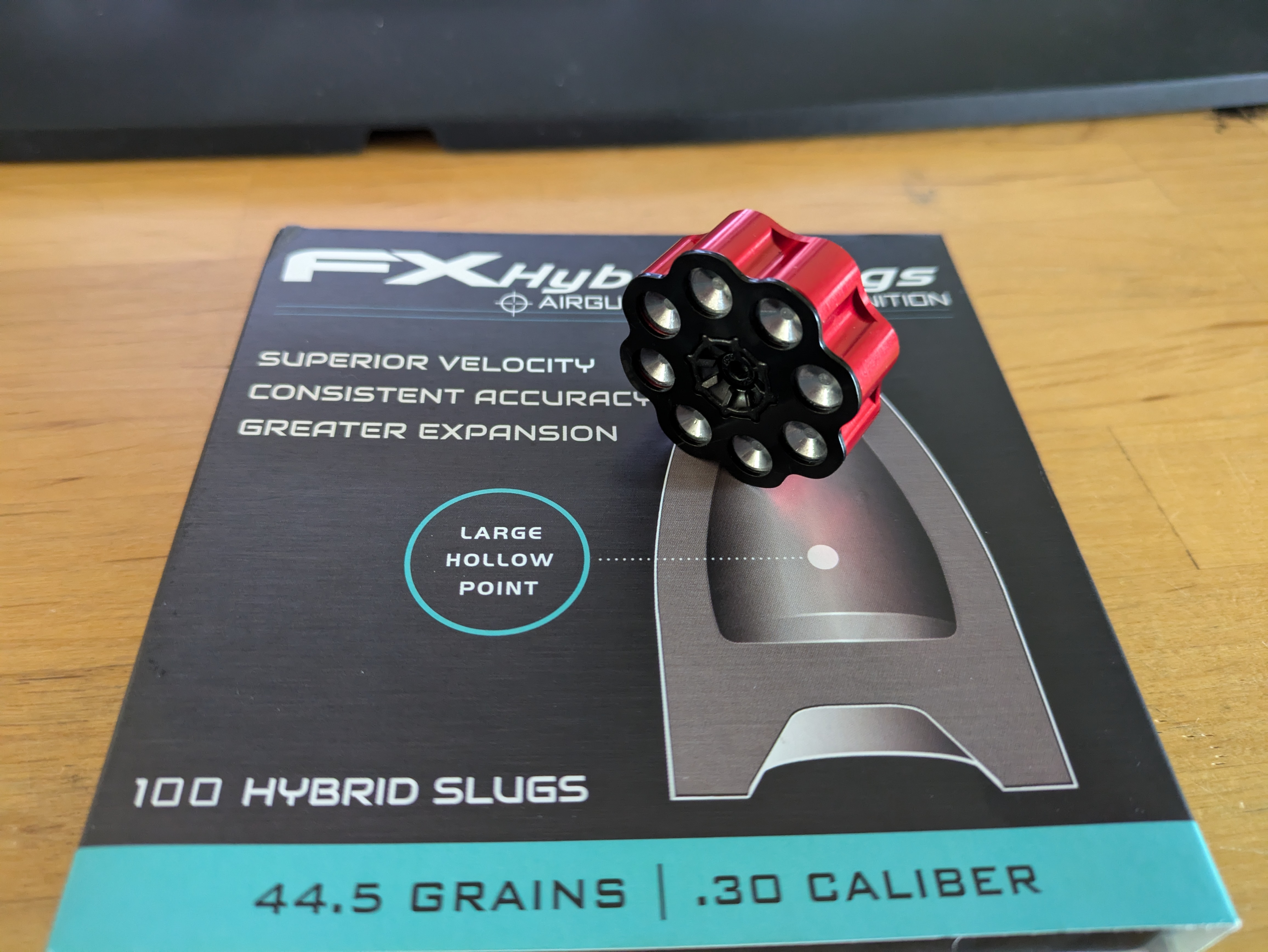

I just realized I received some hybrids a couple of days ago for use in a different rifle however, here are some pics of a freshly loaded slug mag. That's about all the lead that will fit in these mags! I haven't shot them yet but now I'm curious. This is my "Super .30" w/350mm and Raptor Reg set at 110b. It shoots JSB 44.75's at 800fps. I'll give the slugs a test and report back.
Awesome, so the hybrids fit the slug mags, if they shoot as well as they did from the standard mags without the loose fit, that might be my go too ammo! You have almost exactly the same set up as me, I have a 30 cal 350 running the apex/repr-x and also get about 800 fps with the 44.75gn hades - for the hybrids, I made no adjustments to pressure or jets no scope adjustments and they were dead on, 1 inch group at 25 yards, which is even more amazing as can switch between hades and hybrids with no faffing around! Only difference in our set ups is potentially the barrel, I'm running the new lothar walther premium polygonal unchocked 350/30 barrel from edgun Spain, its good! Definitely let me know how the hybrids run out of your setup with the slug mags ! I await with baited breath!

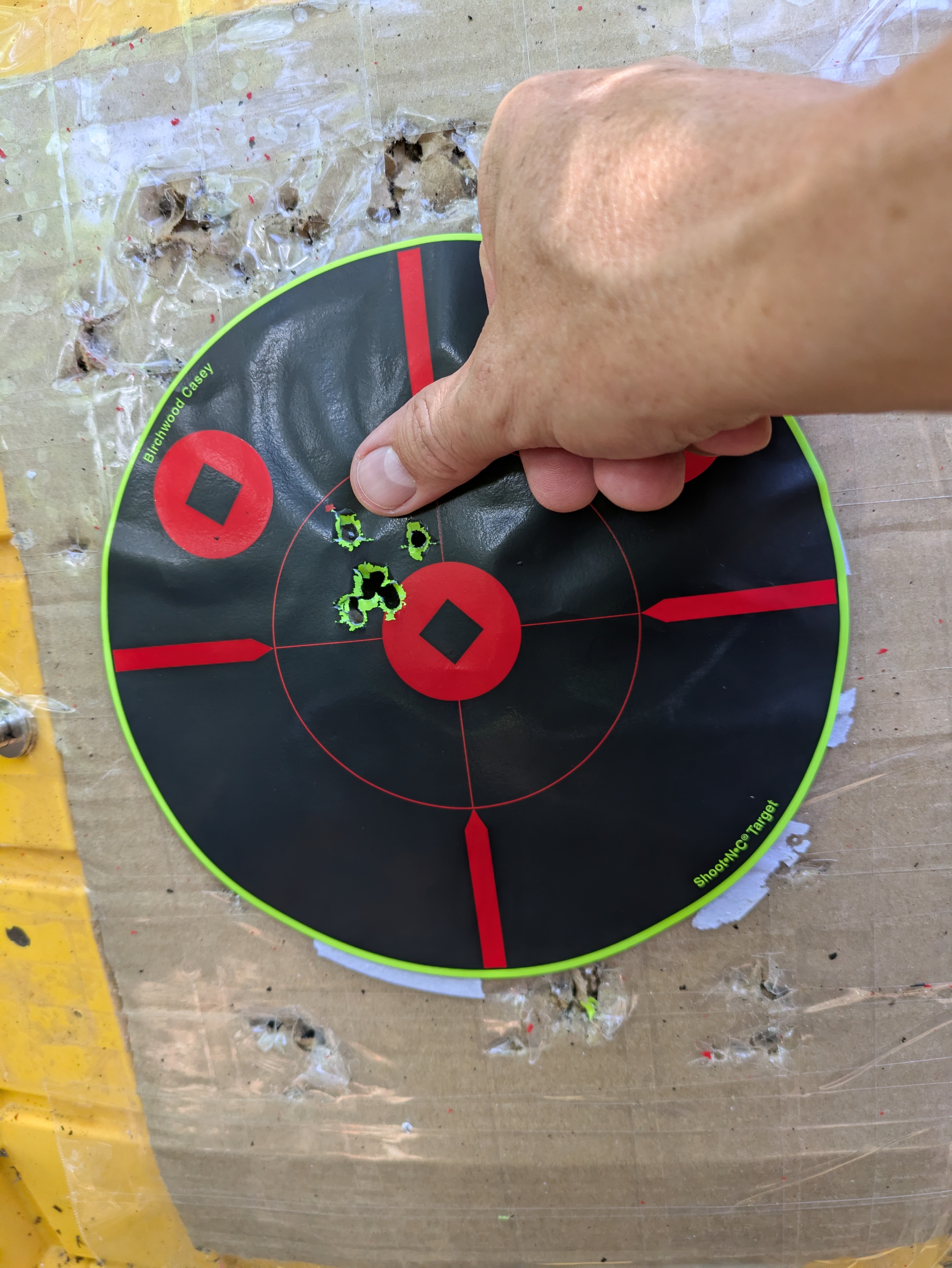

They operated just fine! Here are the numbers from 8 rounds. I used a Monstrum 5x Prism at 30yds for this and found the slugs to hit slightly left and high. The 2 flyers were me being impatient. Point of aim was the center of the target. I'll post what pellets look like after this.
L2 .30
FX Hybrid .30 Slug 44.5 gr
Weather: 91.1°F 12.7mph few clouds 1016hPa/mbar 30.0inHg 65%
Shot count: 8
Low: 761
Hi: 777
Avg: 768
STD Dev: 5
Spread: 16
7/4/24 11:45:08,777,FPS,59.7,FT Lbs,
7/4/24 11:45:14,761,FPS,57.2,FT Lbs,
7/4/24 11:45:22,768,FPS,58.3,FT Lbs,
7/4/24 11:45:36,772,FPS,59.0,FT Lbs,
7/4/24 11:45:46,768,FPS,58.3,FT Lbs,
7/4/24 11:45:54,765,FPS,57.9,FT Lbs,
7/4/24 11:46:03,765,FPS,57.9,FT Lbs,
7/4/24 11:46:14,768,FPS,58.3,FT Lbs,
Reactions: PasadenaMike

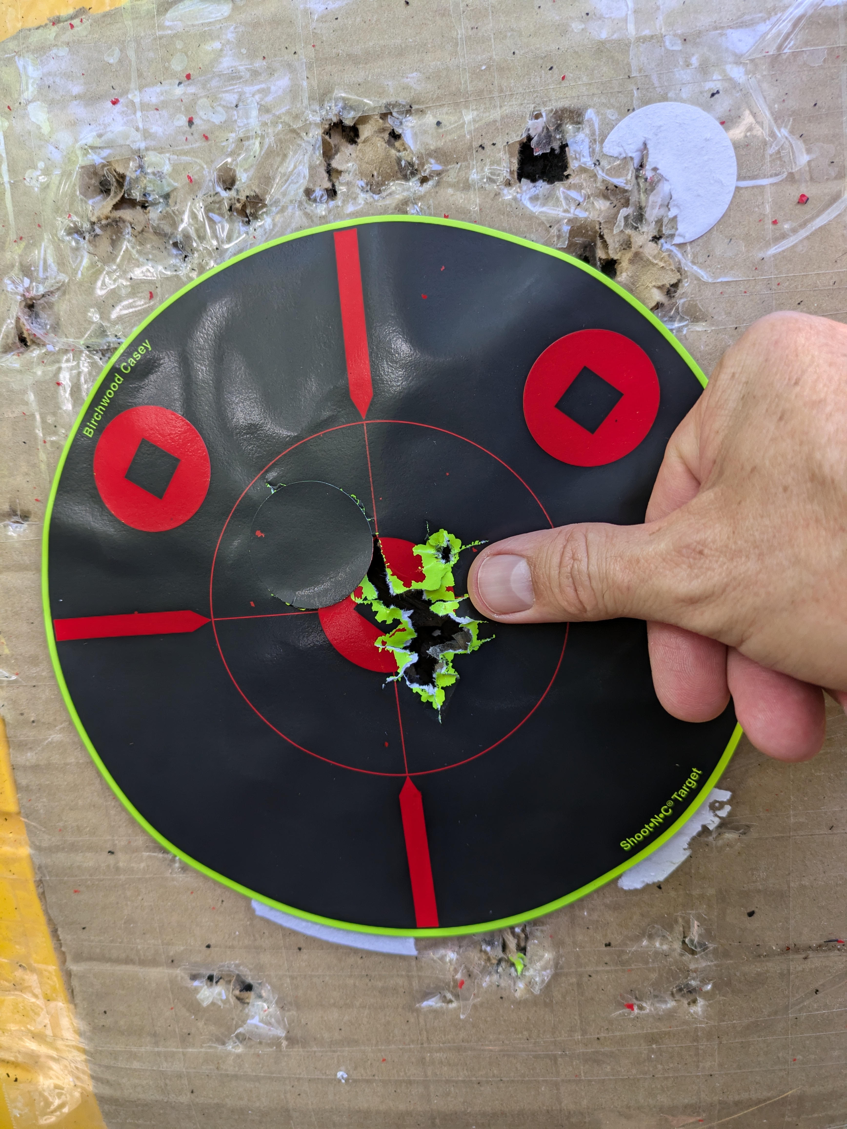

Here's an immediate followup with JSB 44.75 Diabolo pellets. I've got the gun setup for these. Hades fly exactly the same. Apparently I'm not quite getting 800fps with the reg set at 110b. I wonder why?

Interesting that the hades fly slightly faster than the hybrids, i would of expected the opposite! So are you shooting the hades from the slug mags also? Perhaps that's very slightly slowing the speed from the tighter grip of the mag, my hades are very loose in my standard mags but not enough to fall through ..... What jets are you running in your set up?
