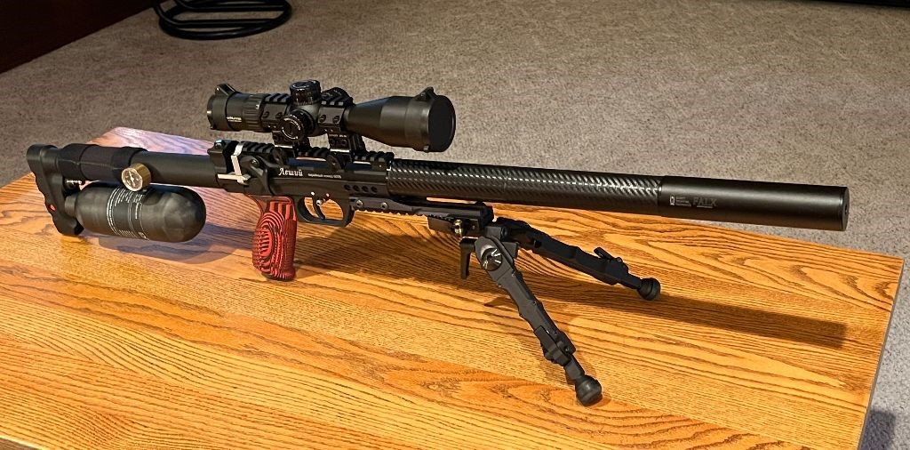

I always use a 350 tank with my .30 setups. It is usually on the gun because it is a hassle to change. One thing to note is if you have an aftermarket hand guard you cannot fold the stock with the big tanks and lock it in place without an extended lock pin. They lock fine with the factory shrouds.
