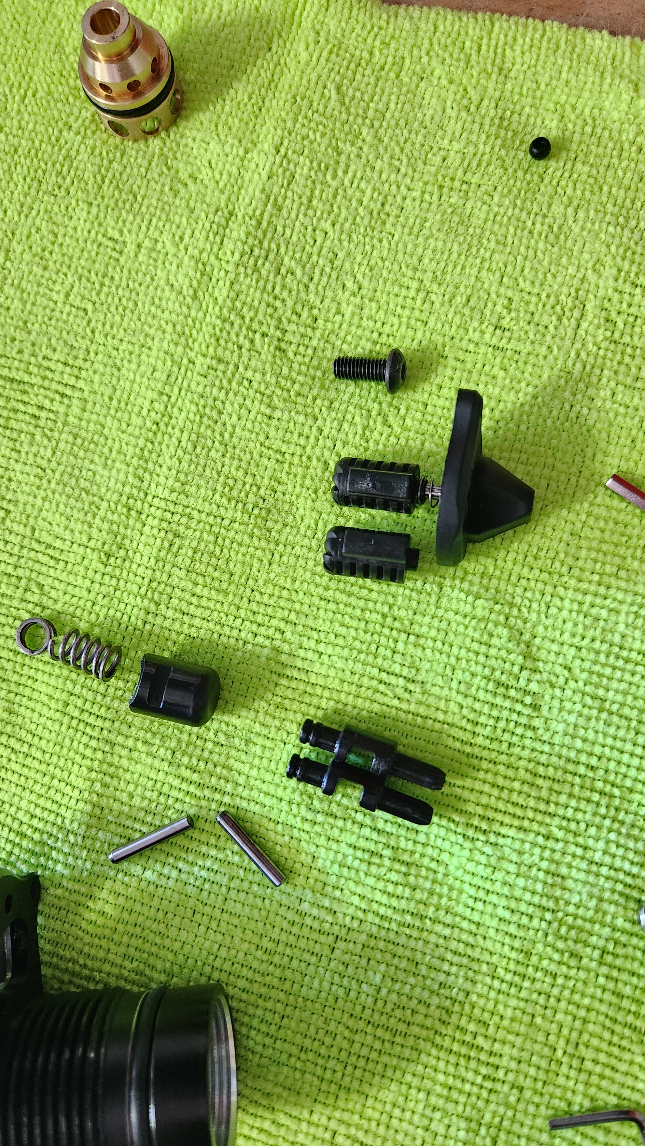

100% agree with you on this i’ve put a lot through mine and still solid. i barely shoot my fx’s honestly lolAbout 15k shots through my l2 since I got it earlier this year and surprisingly the plastic parts have held up it seems, the r2d2 spring broke instead. Wasn't using plastic ball for all that, I swapped it in since metal ball was dented a bit somehow but the plastic ball already cracked after less than 2k shots. New parts are below the originals and hardly any difference sofor wear n tear
