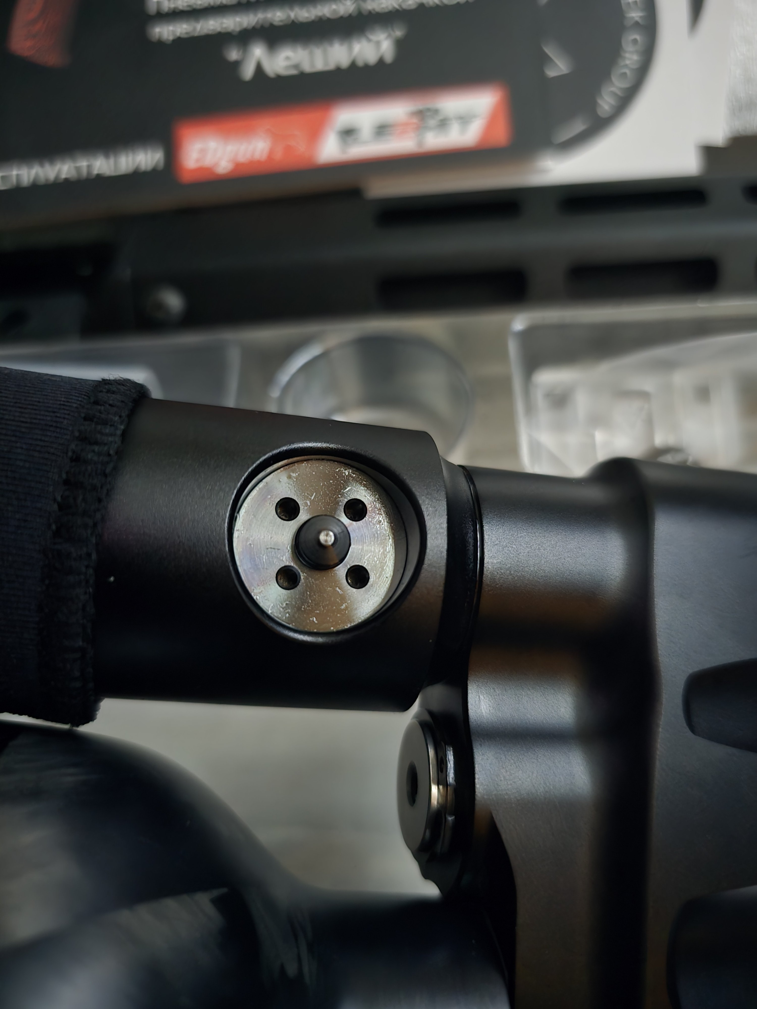

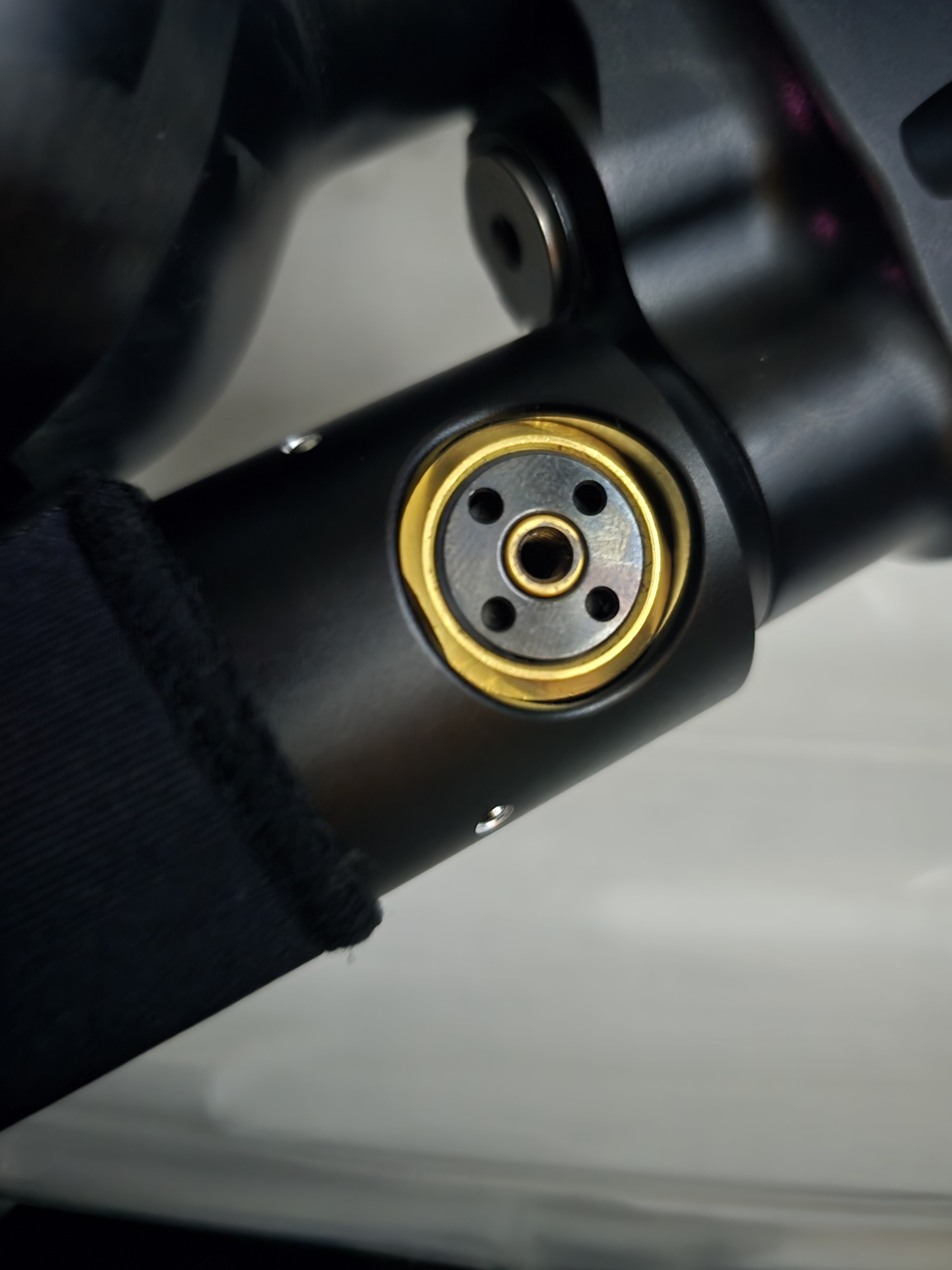

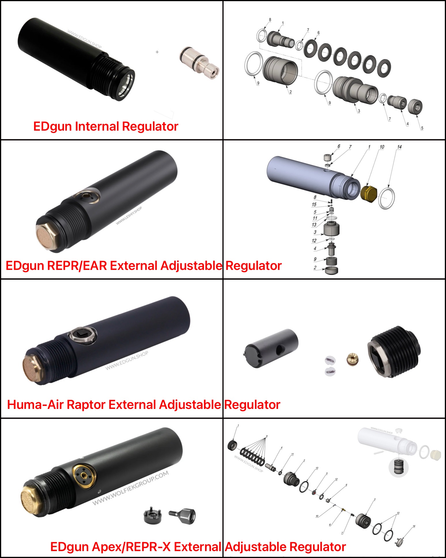

Hello AGN friends. Received my first Edgun yesterday. Purchased from Edgun Shop Spain. It is the 9mm variant. I am confused on the regulator that mine came equipped with. It is the push in style that is retained by a slide pin. I am wanting to get a huma raptor but from everything I have found so far the huma is for the plenum with the threaded regulator chamber. Am I missing something? Below are pictures of mine from the box...Any clarification will be much appreciated. Thanks
Hello AGN friends. Received my first Edgun yesterday. Purchased from Edgun Shop Spain. It is the 9mm variant. I am confused on the regulator that mine came equipped with. It is the push in style that is retained by a slide pin. I am wanting to get a huma raptor but from everything I have found so far the huma is for the plenum with the threaded regulator chamber. Am I missing something? Below are pictures of mine from the box...Any clarification will be much appreciated. ThanksView attachment 518552View attachment 518553
You have the REPR-X/Apex Externally Adjustable Regulator. Your plenum is not compatible with the Huma-Air Raptor Regulator. The Huma is a threaded screw in type, the REPR-X/Apex is held in place by a pin.
