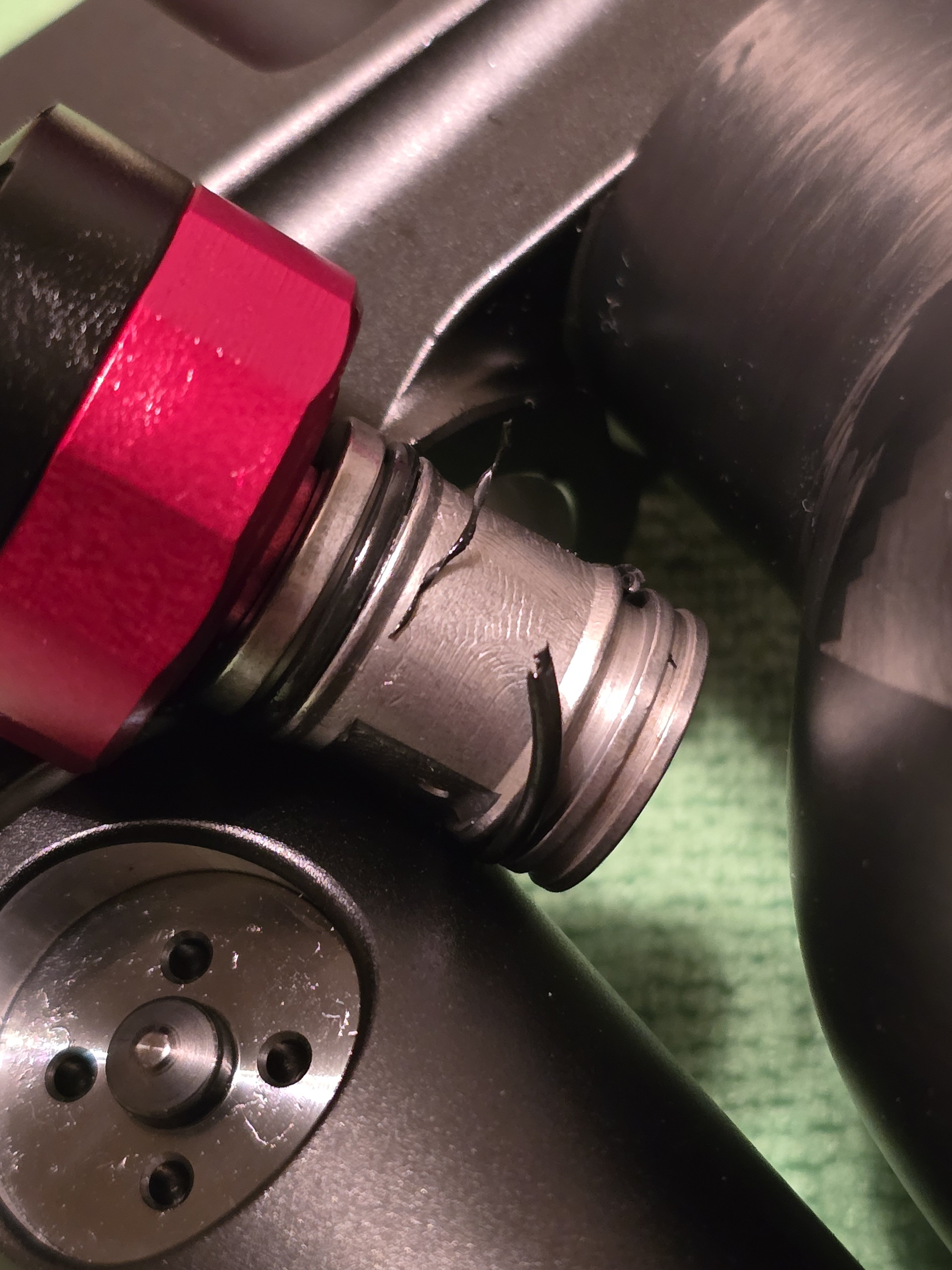

Not sure about latest L2 Regs' back back in time the first REPR surfaced many people blew the Reg oring in very first 5 minutes - including myself :)
If you start turning the key but not more then 15 minutes .... make couple blank shots. Every time you turn it one way stop there and blank shots and only then keep going where you wish - the Reg oring need those blank shots to stay in one piece.

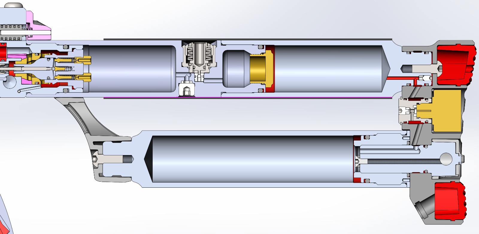

It sounds like your regulator isn't regulating. Like others mentioned, this probably means a seal isn't quite working appropriately. EGS will probably instruct you on how to open it up to inspect the o-rings and various other sealing features. The pic gives you a basic idea for where the seal failure might occur.

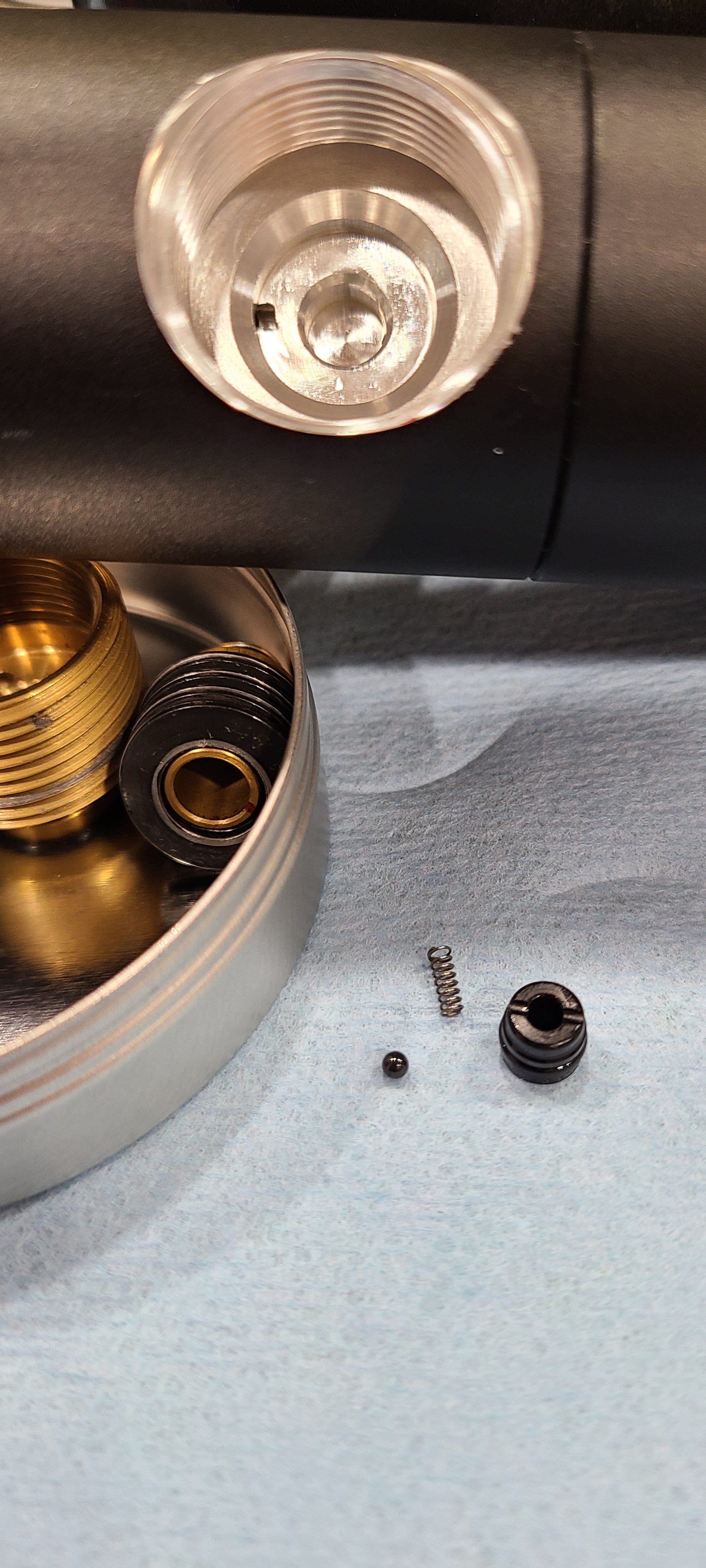

I really love to shoot my Leshiy, but it was a bit of a learning curve. In the beginning I had some issues, and in hindsight I think it was not properly set up by the supplier (Edgun Spain). My regulator did not work very well (it was almost impossible to turn it), trigger was not always working, ... All my issues were resolved by opening up the gun, cleaning it and reassembling. I even suspect the supplier of recycling used parts: the internals of my regulator showed heavy usage marks and my trigger rod was bent. Now it shoots very reliably and accurately.
So my advice for the regulator: watch a video instruction, open it up, clean it if necessary, check the o-rings and ball sealing and reassemble. Just be aware of the very small parts in it (don't lose the ball). And have fun while doing so, the Leshiy is pretty nice to work on ;-)

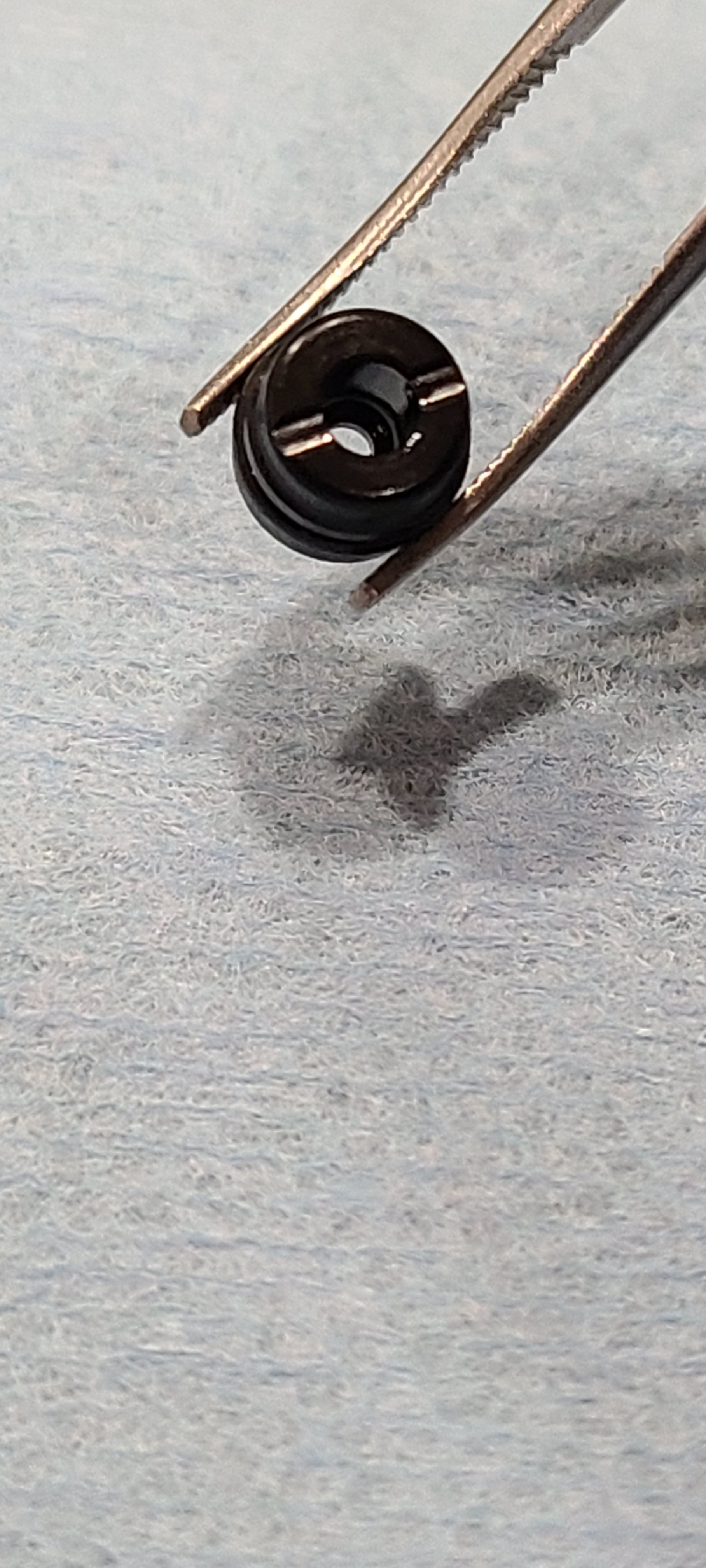

I made a lapping tool (back about 2022) and lap-polished the ceramic ball nest in the REPR, and never creep again. Here is today @ 74 bars I didn't shoot the gun since Oct=3 months. Today I was doing firelapping my FX liners with L2 and this how I can confirm no creeping if you take wall care of the maintenance.

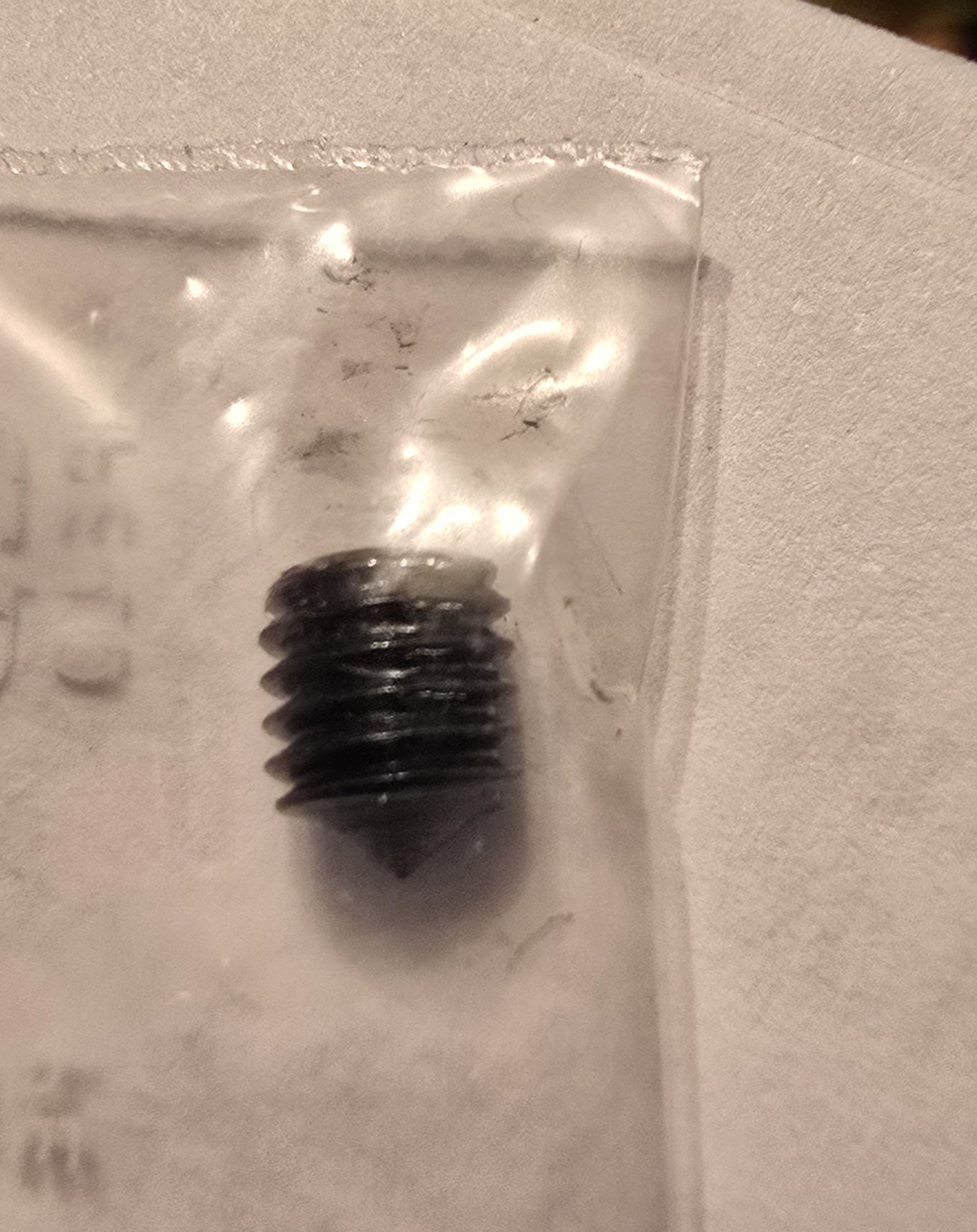

...in photo as REPR-X does not have a guage port...

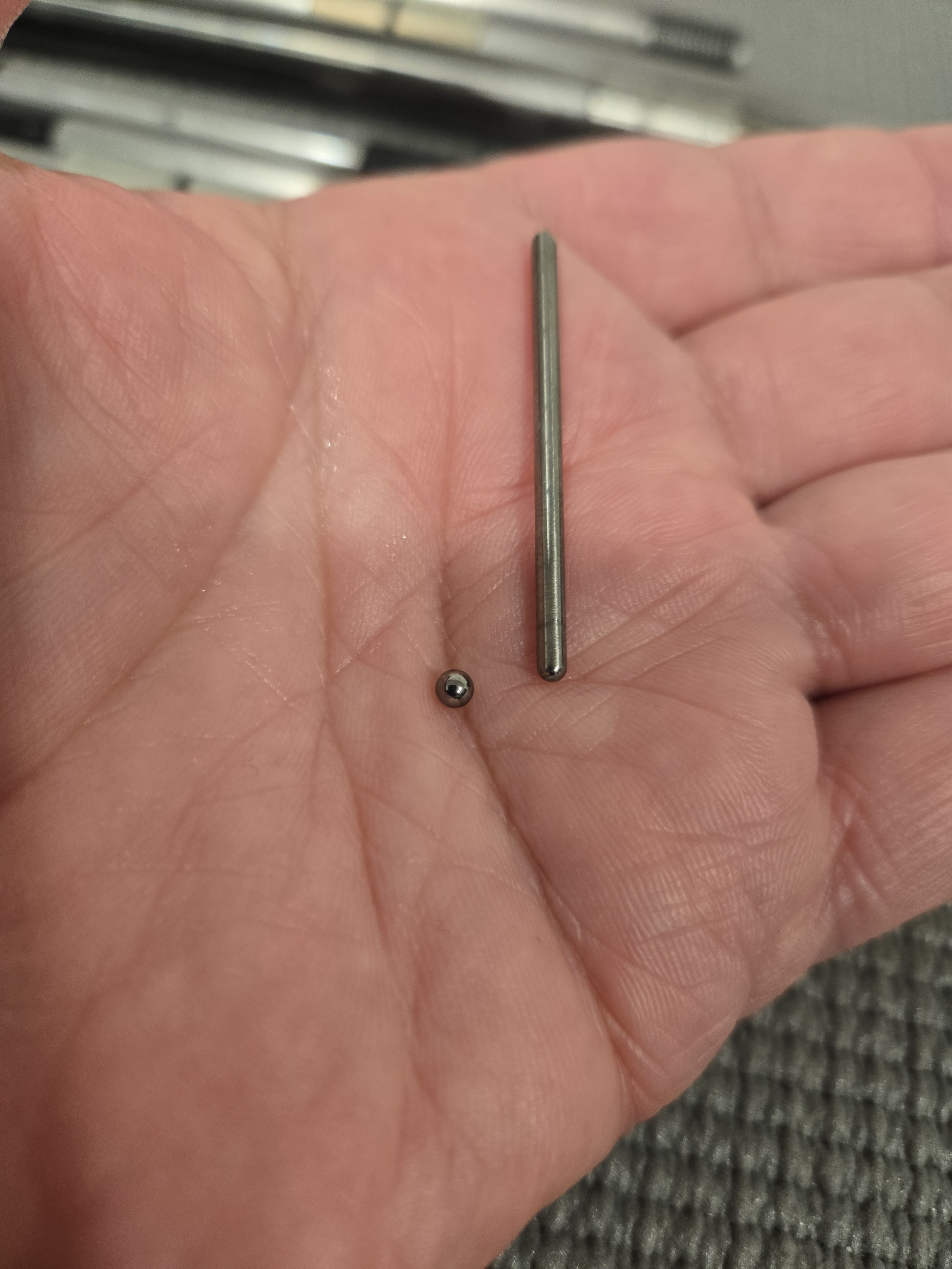

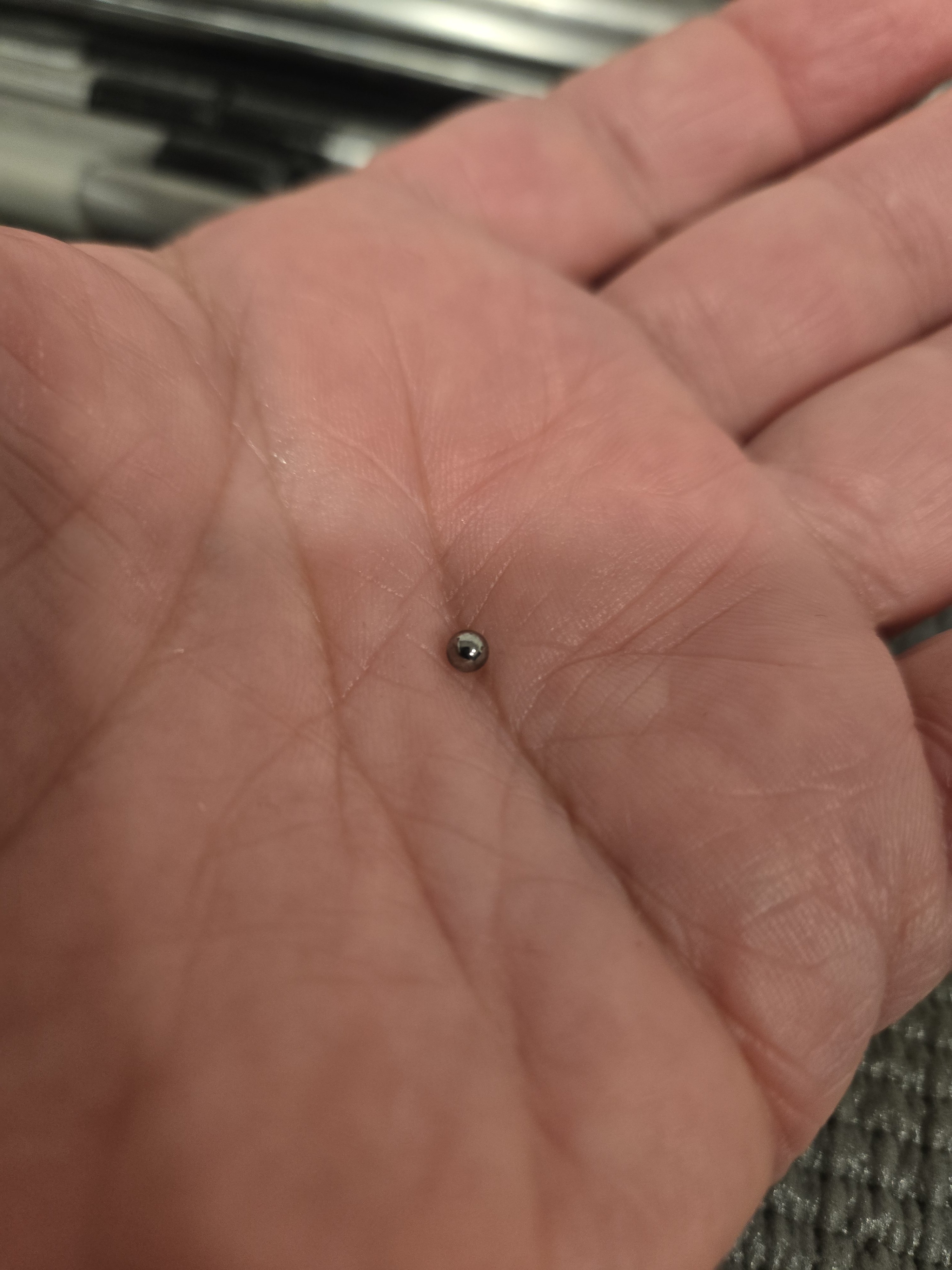

In that your photo how the adapter with gauge is installed....when you remove the setscrew there underneath is a ceramic ball... so not the setscrew seals but a ball underneath. If you didn't removed tat ball .... ???
My set screw in that location had a pointed end and sealed against a Delrin washer. I could be wrong but there was not a ball. I got the regulator to finally give. I gently turned it clockwise then back a tiny bit and it finally started increasing pressure. I am now at a steady 170 bar. Now I will see if it holds without change/ creep. 🙂

The early REPR's came with a ceramic ball underneath that screw. That could happen that Egun removed that ball and replaced the screw...people were most likely loosing these...so make it idiotproof as much possible :)
Next. In the Reg valve a same ceramic ball. I have a pin (cannot remember 2mm or about 2.5mm) and made a rounded nose. With that ball nose I polished the black delrin piece where the ball sits and seals. Never creep in 2-3 years.
