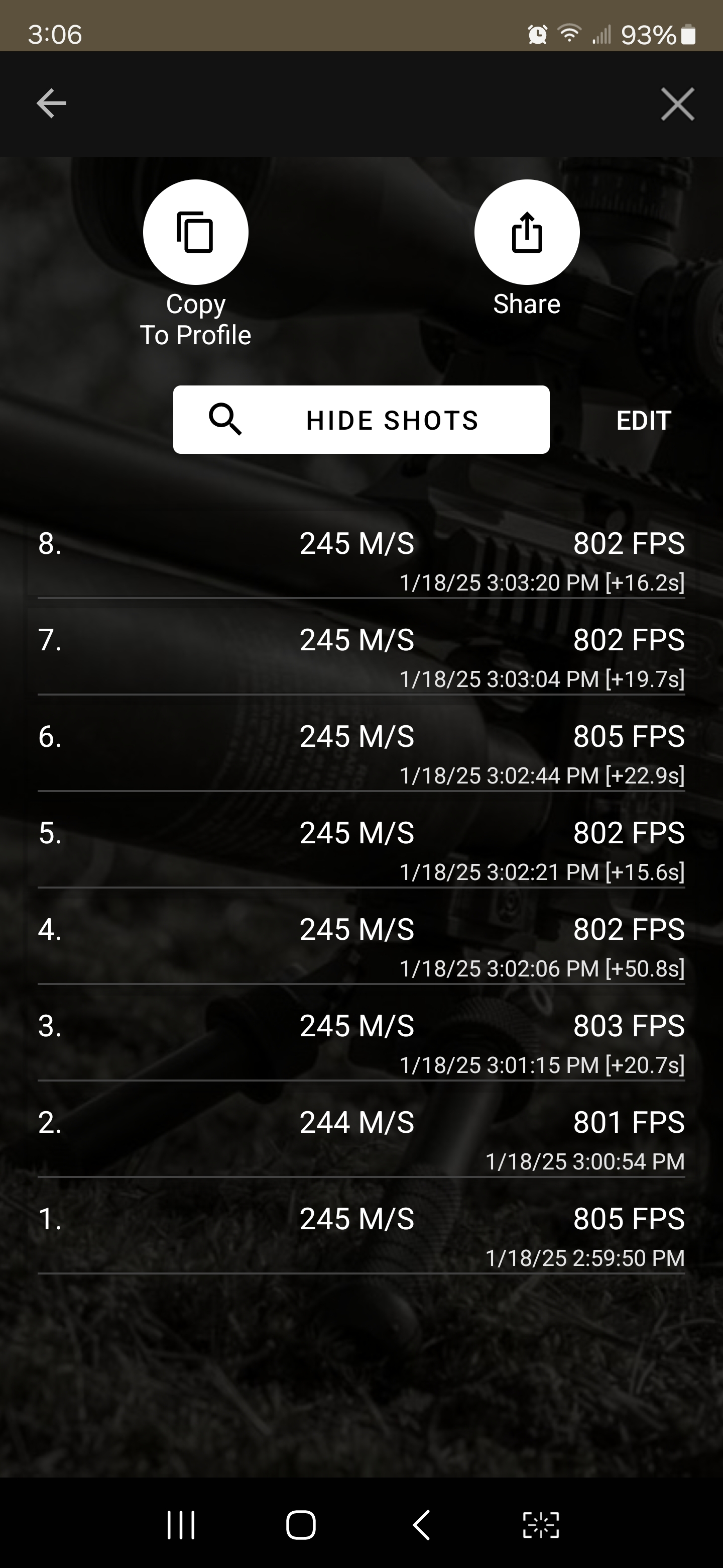

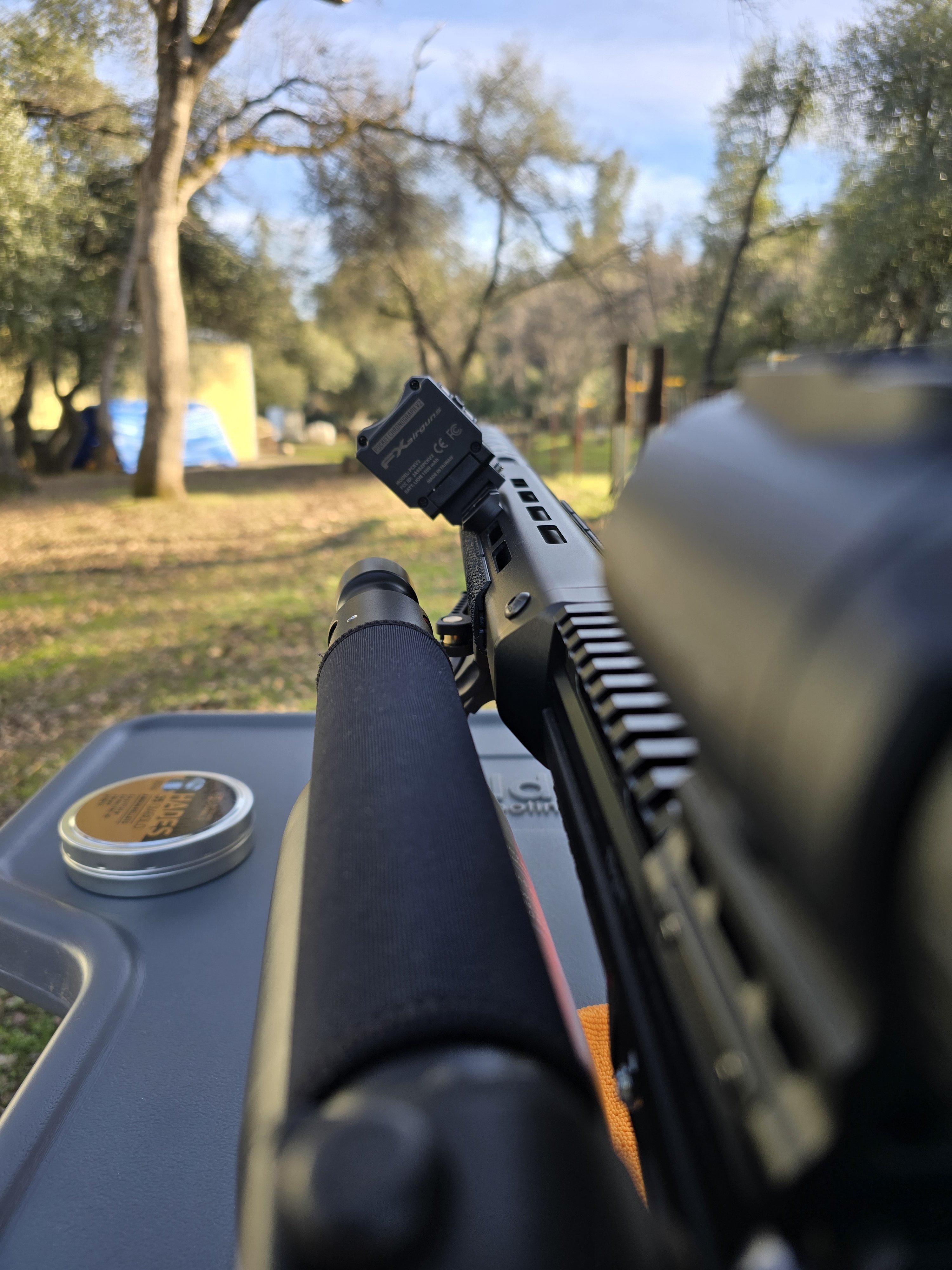

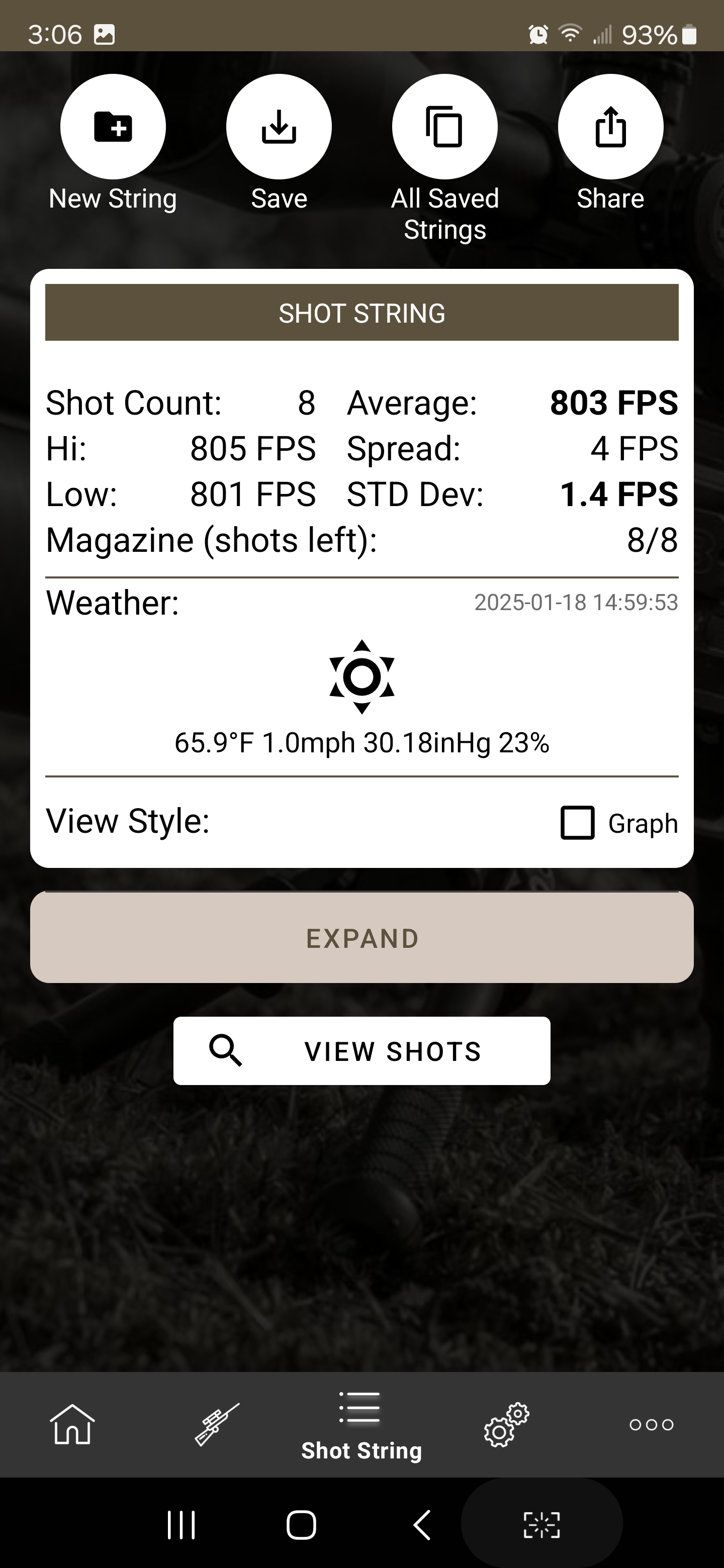

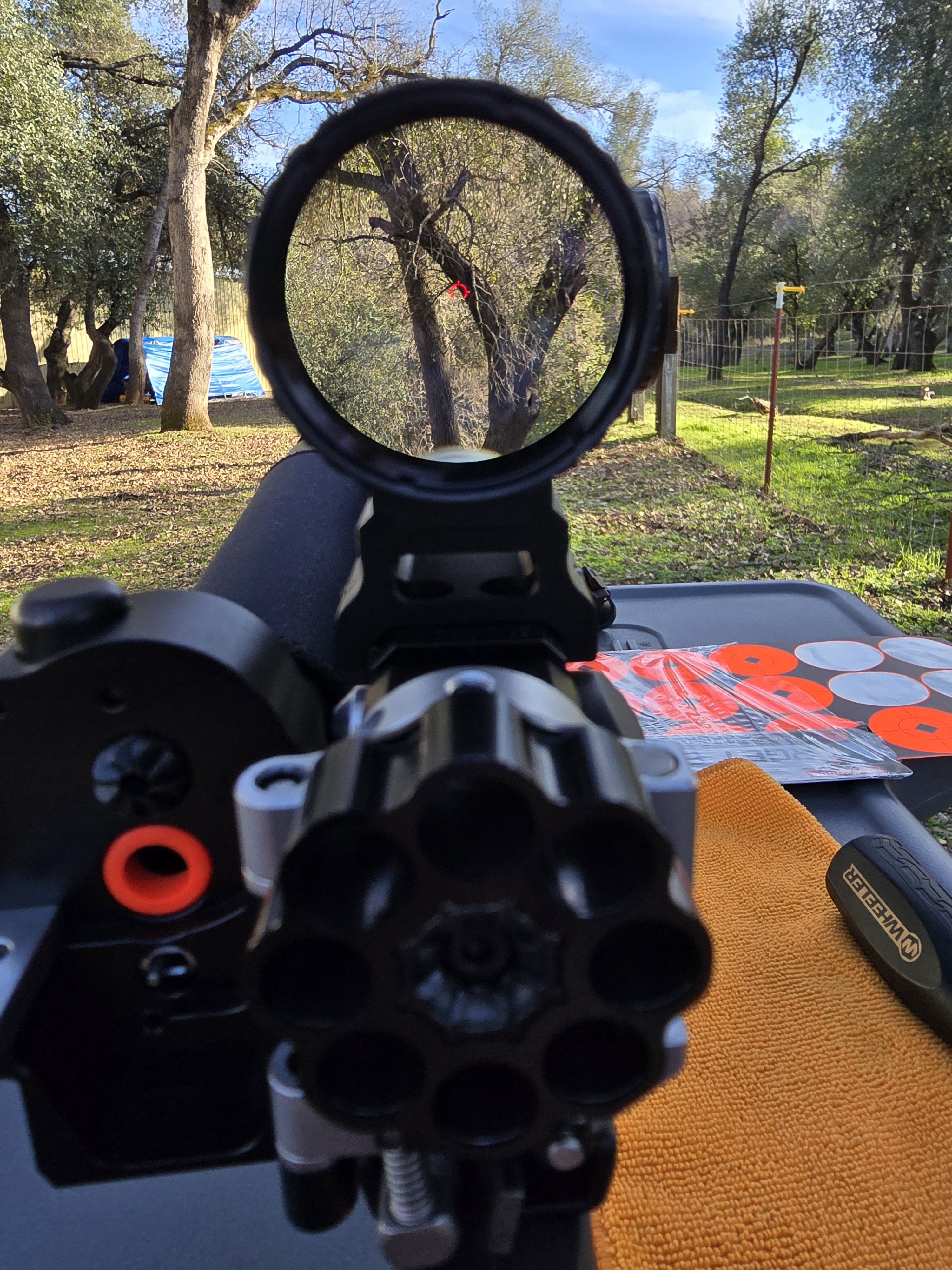

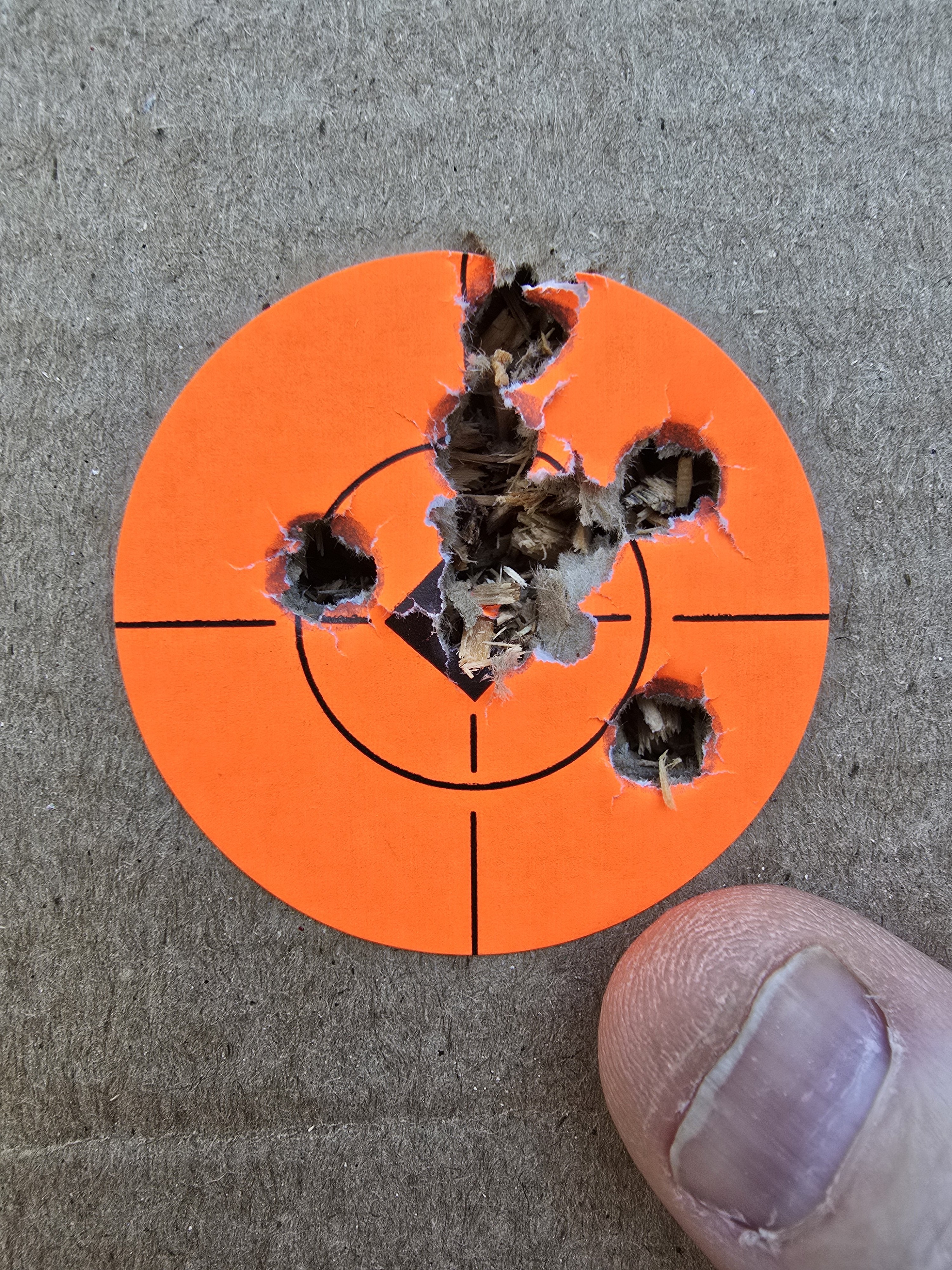

Okay, finally sent some lead down range! It was a beautiful day for shooting. After first shot the plenum gauge settled at 167 bar and recovered to 166-167 between each shot over 3 mags. Photos are of last mag 8 shots @ 35 yards. JSB hades 77.16 gr. Average of 804 fps. Shooting from bi-pod no bag in rear. 3 power prism. I am happy so far! No cycling issues. Everything was super smooth. Did refill to 300 bar before Shooting third mag.
