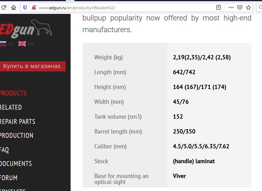

All these accessories are cool and all, but the one thing I’m not seeing anywhere is more info on that carbon bottle! It’s the one thing that’s featured in many a Leshiy2 video, but not on pre-sale or discussed! IMHO - That’s the accessory that finishes the Leshiy2’s killer-cuatro-combo of Portability, Repeatability, Power, and Shot count! I wonder if it’s a china-made bottle, and everything’s messed up with chinese carbon these days, hence they are pushing all the barrel-end accessories first, while that bottle is left on the back burner...
Total stock volume is 152cm3
the two tanks from the video is "колбу 0,2 л и 0,5 л." = flask 0.2 and 0.5 ltr. = 200cm3 and 500cm3
Edit: in comparison, Leshiy Classic's useable tank volume is 50cm3 (with the standard EDgun regulator)
