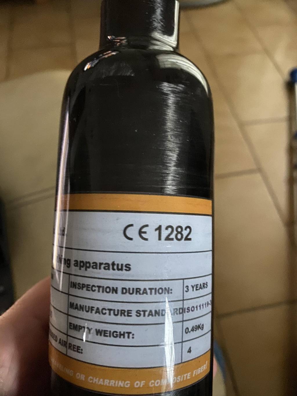

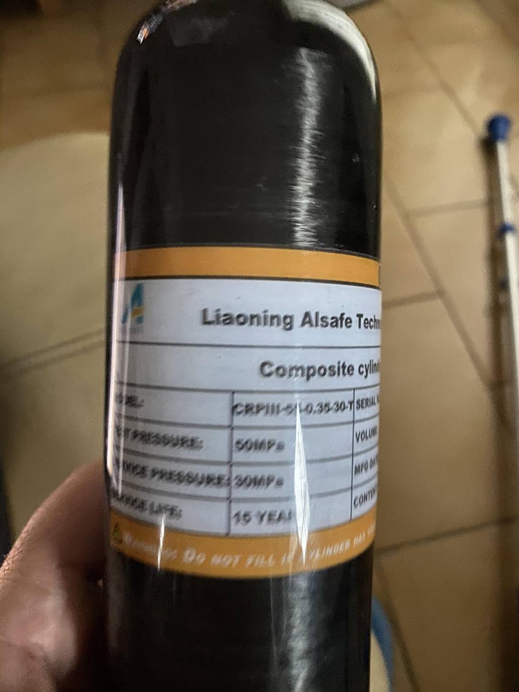

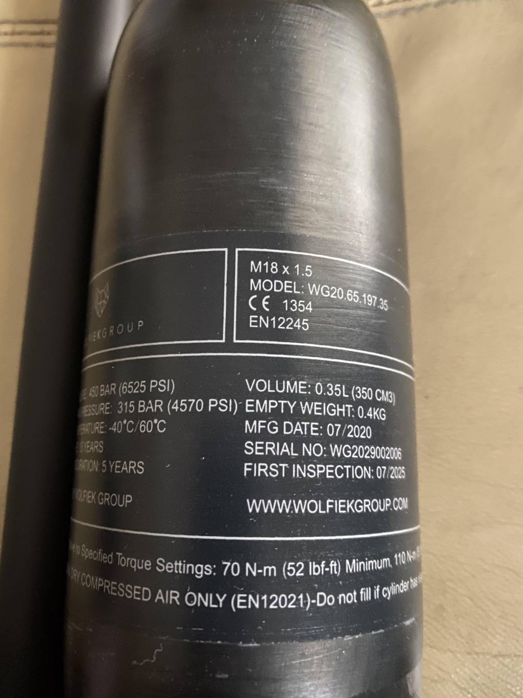

Hi, I have received the bottle. Its 350 cc. Actually It´s fitted to FX Dreamline Compact, waiting to Leshiy 2. Fantastic quality a lot better than other bottles that you can buy in ebay. It´s the same that FX bottles. Ratted to 4570 psi (315 bar). Very happy with the bottle.
so 152 + 350 cc = 502 cc or 10 times the volume of the Leshiy Classic, so about 10 times the shot count of the Classic with same barrel length/power level, nice!
Actually it's probably more like 75 cc + 350cc as you have to remove the bottom tube to install the bottle.
I don't buy any carbon fiber bottles that's not DOT. To dangerous especially when it's next to your face. I will get the ones bryan ordered in when he gets them. If not my FX 300cc bottle will fit just fine and I know there safe.
The bottle from Edgunshop has CE homologation under the next european legislations: 2006/42/EC Machinery; 2010/35/EU Transportable pressure equipment; 2014/34/EU Equipment and protective systems intended for use in potentially explosive atmospheres (recast); 2014/29/EU Simple pressure vessels; 2014/33/EU Lifts and safety components for lifts; 2014/68/EU Pressure equipment; Regulation (EU) 2016/424 Cableway installations.
So the bottle it’s totally secure. My FX Impact bottle has not dot certificate but CE certifícate.
People in Europe also want to live safely.
Buy the way the bottle of Edgunshop it´s tested to 6525 psi (450 bar), so you can be calm.
FX bottles are made in Korea, and I am, in Europe, very calm with this. And my IPad/IPhone/Macs are made in China, and very happy with them.
Obviously you can buy where you want, but buy in Edgunshop it´s secure too. Im very confident with Francisco (Edgunshop) in Spain but I have bought in USA too with confident. Whats the problem?? Europe is also the first world.
Yeah, I was going to mention the CE approval. Only approved armor I wear in my motorcycle clothing. And I buy SNELL over DOT helmets, too. But let's face it...we're all taking chances here as everything is human made. Any certified safety review is better than none, but we're all really relying on manufacturers to want repeat biz and no lawsuits to do their due diligence. After all, other than money, is there another true motivator?
