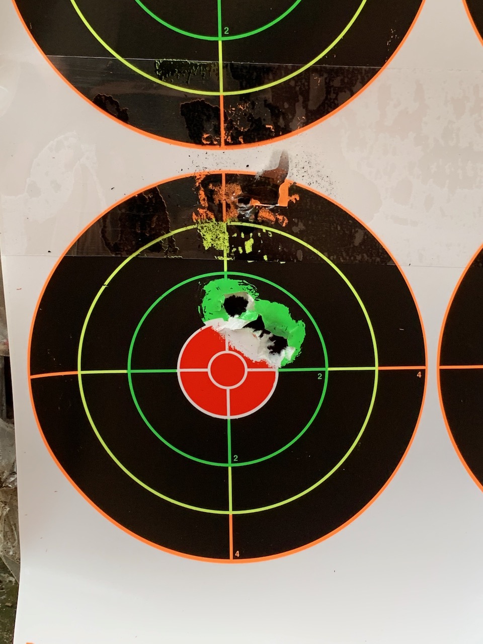

Bingo seems to be correct. I just fired off this round of 8 shots from 46 yards. .22/350mm barrel with a Koi attached directly to barrel via 14x1.25 adapter. JSB 15.9gr sorted by weight, not cleaned.
The first two high shoots at the top of the target were sighters to figure out elevation. The central group is 6 shots. Concentric rings are 1/2" apart. I'm much more pleased with this group considering I'm only using 8X for the distance. No stray or oddly dropping shots.
