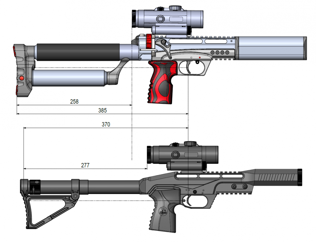

Oooh, I'm interested in this too! (Leshiy 2 overall size - 250mm and 350mm size when folded).
If you've got a Leshiy 2 (all kitted out with a scope, bipod, etc), I'd like to know what a good pack size would be. I'd like to backpack with my Leshiy (when I get it...), but don't want to carry an oversize rucksack unnecessarily. Please chime-in!

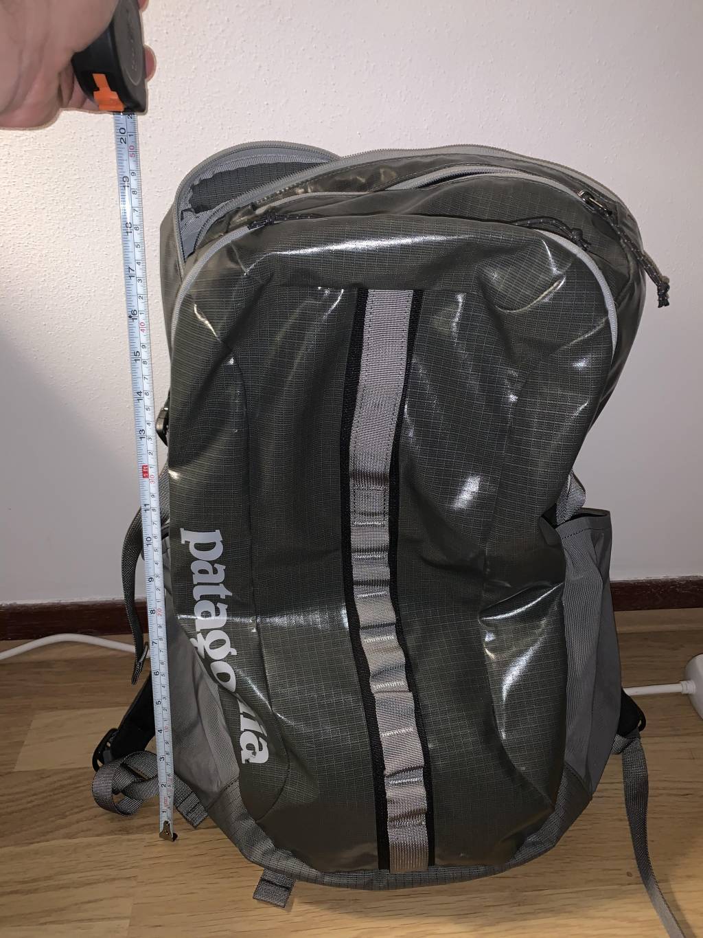

Here is a suggestion...I am a huge fan of Patagonia equipment. You can’t be the quality AND customer service of the company. Plus there is a 25 year guarantee on their products good any where in the world. I bought a jacket in Prague and Patagonia repaired it 3 years later for free when I was home in USA for a month with 2 day service.
The Blackhole backpacks / luggage / duffel bags of Patagonia are rock solid. They aren’t waterproof, but with that coating, they are VERY water resistant and if you really are concerned you can buy a cheaper storable cover for it to keep water out.
Length is around 22 inches and capacity is around 30 L. You could easily put the Leshiy 2 in it and a buddy bottle, with lunch and some gear and should be good for a day.
No need to extrapolate - my 0.25 w/ factory 350mm shroud is just under 18" from the back of the installed magazine to the end of the shroud when folded (if you use an aftermarket grip that extends back beyond zero degree factory grip, your overall length might be a little longer since your grip will stick out a little further). When unfolded, it's 29.5".
