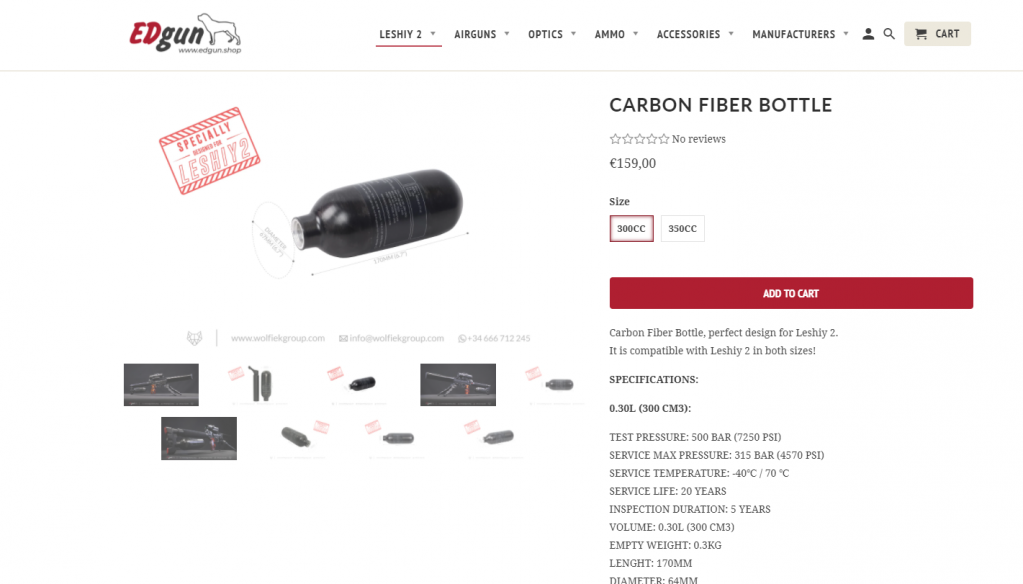

@ctshooter....isn't Brian selling the bottles from EdGun? Francisco has them available on Edgun.shop (see screenshot) in 300 and 350 cc. I have seen people here post their Leshiy 2s with bottles so I assume they got them from Brian, EdgunWest.com

@ctshooter - yeah they appear compact and from what I have seen allow you to close the gun all the way and lock it, at least the 300 cc bottle. Francisco / Ed has their conversion wrong on the width of the bottle. 67 mm is about 2 2/3 inches. So 2 2/3 inches wide and 6.7 inches long. So about the length of my iPhone and about an inch smaller in width. Price is VERY fair compared to what FX is charging for a similar sized bottle which is around a $100.00 more for FX vs Edgun, well done @edgun.

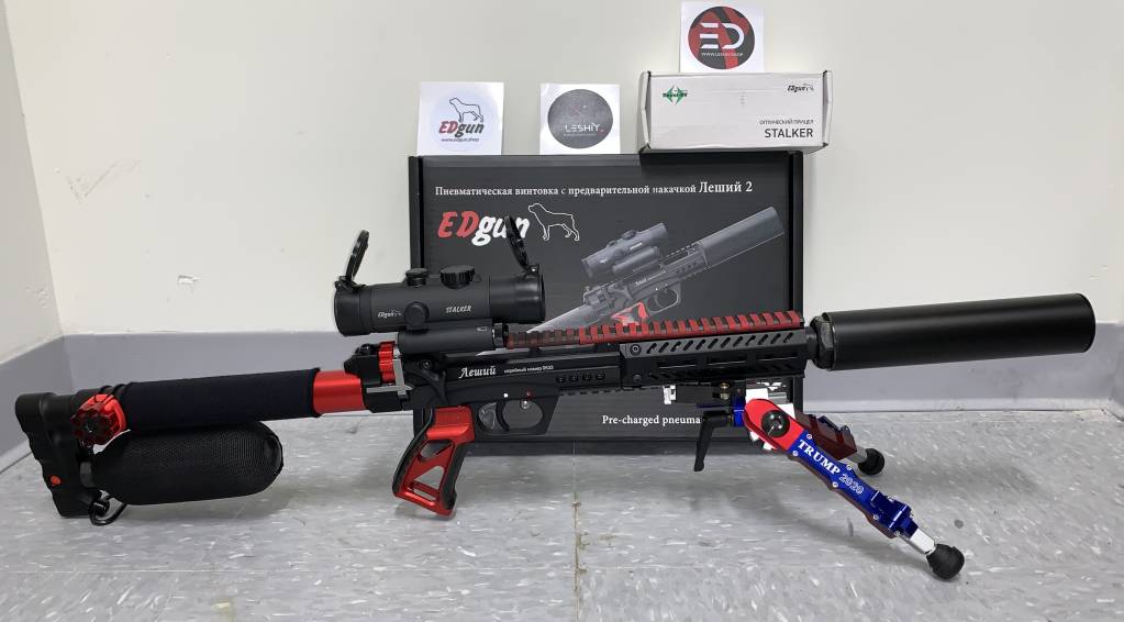

i got my bottle from edgunEU it's the 300cc the smaller one I was scared of hand clearance but it was not a problem at all. But if i had to do it again 2 things I would have changed #1 I would have got the bigger bottle because I got the red plenum the largest one so it give me more room to add the bigger bottle. And #2nd I would have got the Fx bottle in 300cc because it comes with the adapter so you can remove it and still keep the air in the bottle. The Edgun EU bottle is just a bottle no adapter. Now it's great quality in fact great quality but that's what I got and am happy hear is a photo

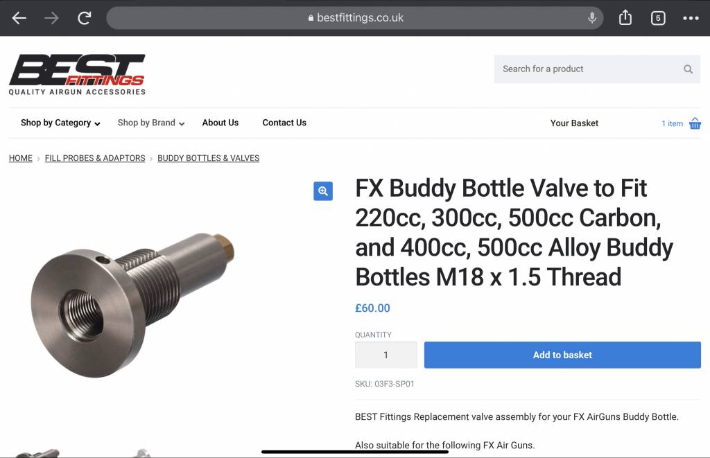

I thought you had to remove the valve from the bottle?
Shoot them an email and ask....I know people who have dealt with them and they are supposed to be a company with good customer support.
I haven't had my lower cylinder off yet, but I'm positive that you cannot just remove a bottle from a pressurized Leshiy 2 (i.e., there is no check valve on the L2's bottle port).
