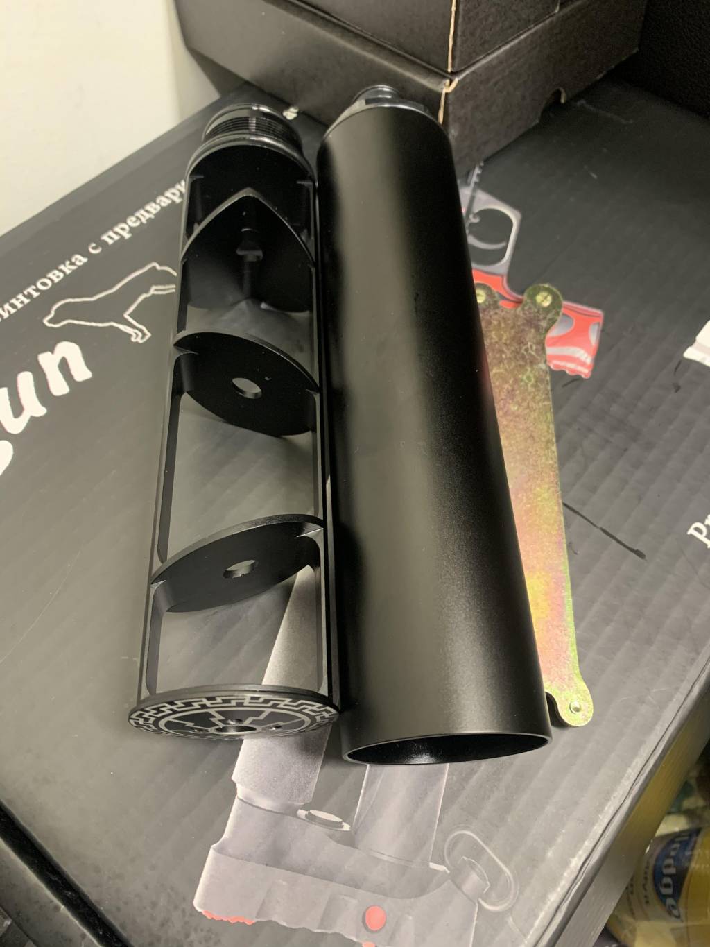

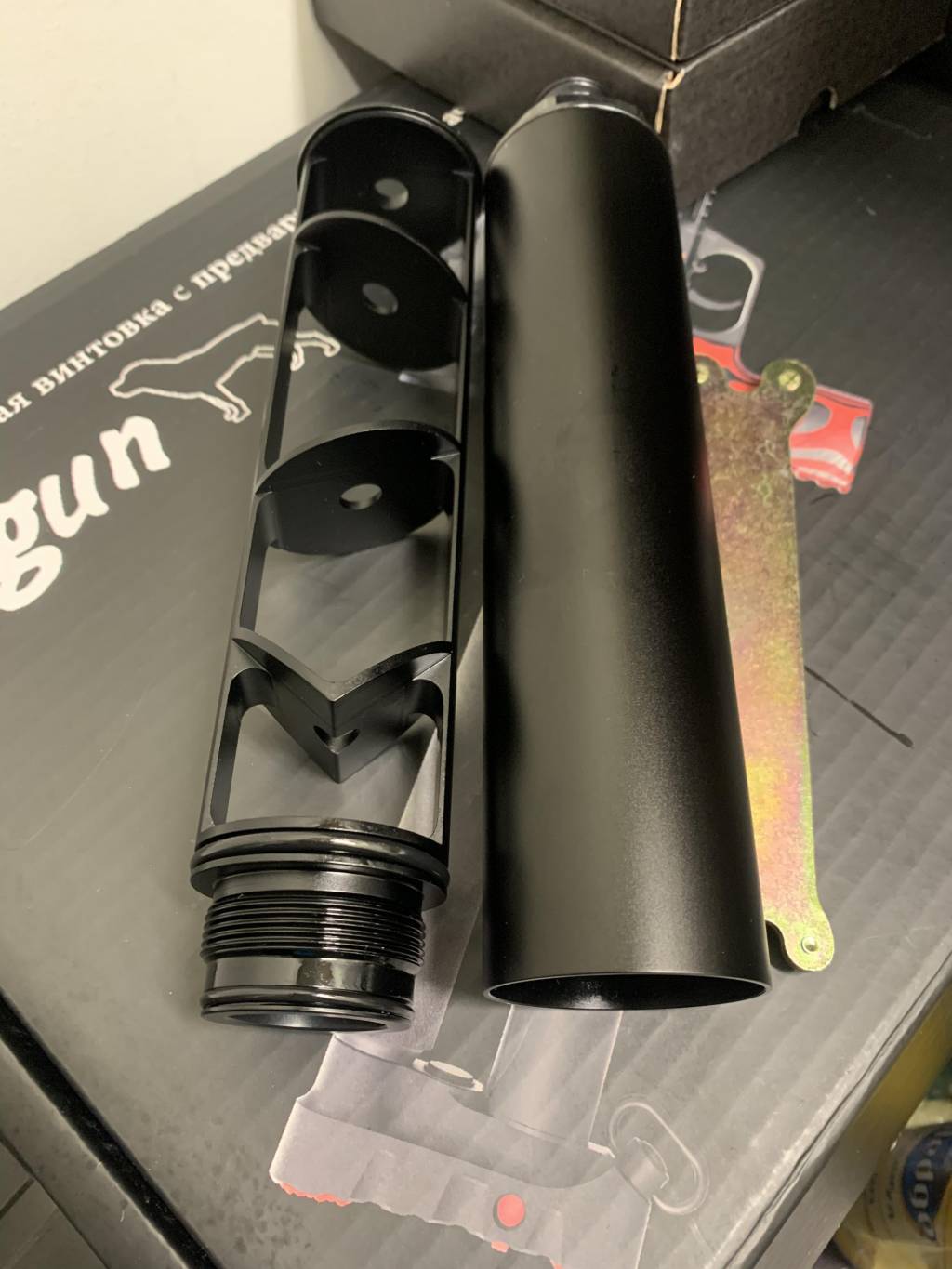

Has anyone took apart the valkyrie 200 moderator well this is what it looks like inside. I took mine apart to see if I was clipping? But am not clean and clear!!
@blackpaw
yes it works well but I have the bigger 200x350mm size Valkyrie it's a deep sound not I high pitched sound I can't believe it works so well because this is so simple looking. Now hears the thing I have a solvent trap cleaner I use for cleaning my guns powder burners. And it's the same thing as this but more baffling some guys use them as a silencer I would not do that but just saying they do. So I might try one out the see how it does. But yes it's worth getting the Valkyrie kit the only thing that I would say is better would be the emperor by Donny but man it's big

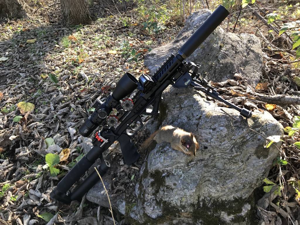

Finally got this little guy. Been chewing on my T111 plywood on my shed this summer. The walnut tree beside the shed was too much for him and he was distracted. Shot him from the garage about 45 yards. Missed him on the first shot and got him on the follow up shot when he turned to see where the shot came from. I am still figuring out this trigger. My experience so far is to as Brian explained , pull the trigger rapidly and not squeeze it until it goes off. There is a definite difference in the way the shot sounds and the gun is more consistent accuracy wise with a consistent quick trigger pull. Anyone else experiencing this?
Yeah, the first shot might me a little hotter than the rest. If you're finding that to be the case, hold under ever so slightly on the first shot, but the trigger pull just needs to be smooth and swift 👍
