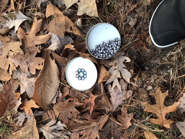

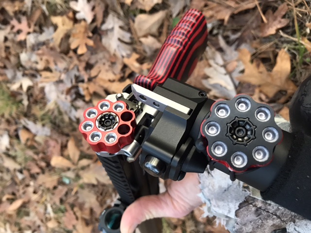

I too get 6 to 7 magazines per fill in.30. I have started taking my tin of pellets in the woods and refilling after shooting. Always having a full magazine to work with is very convenient.

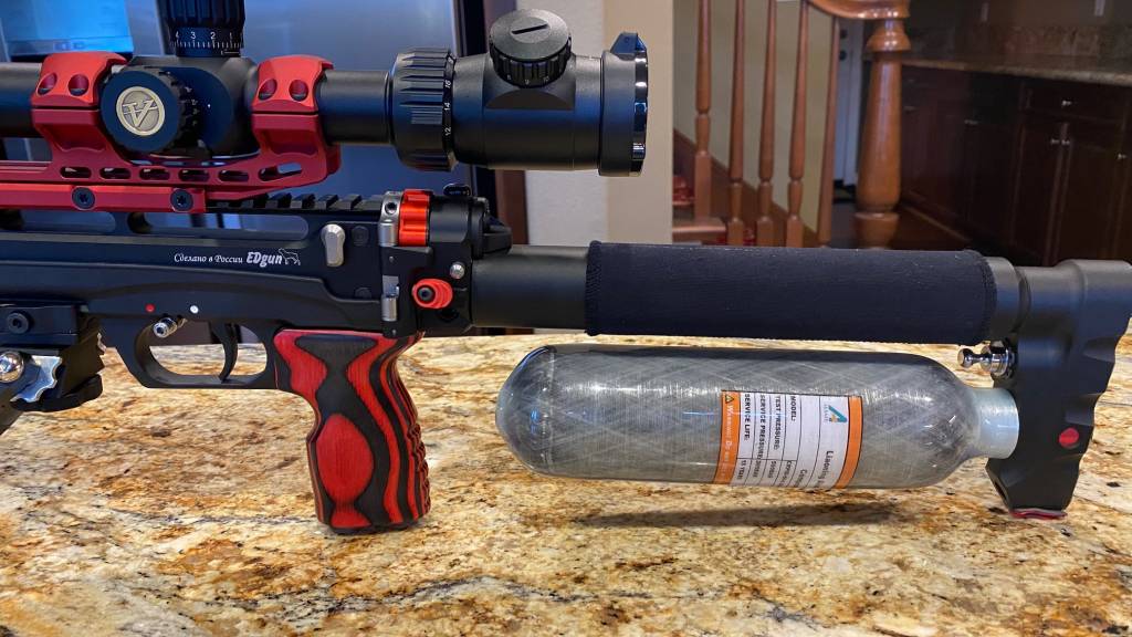

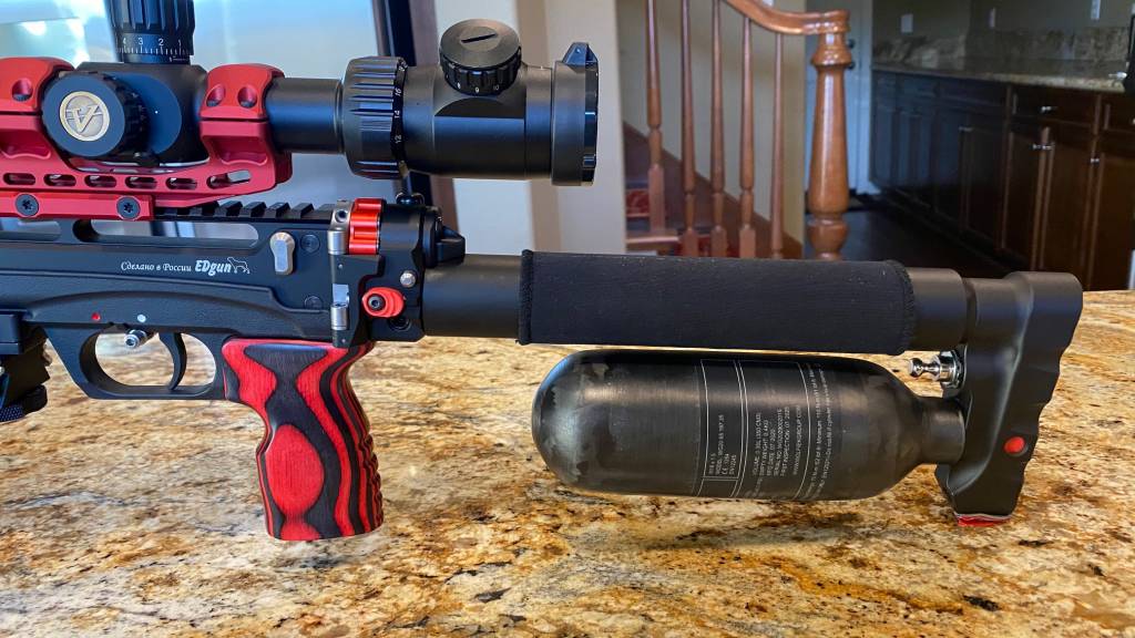

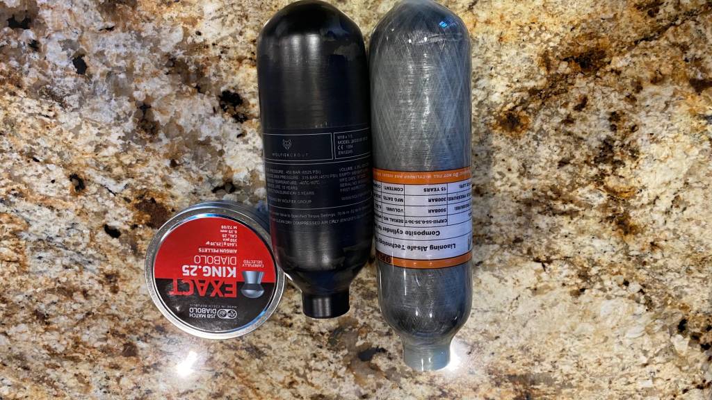

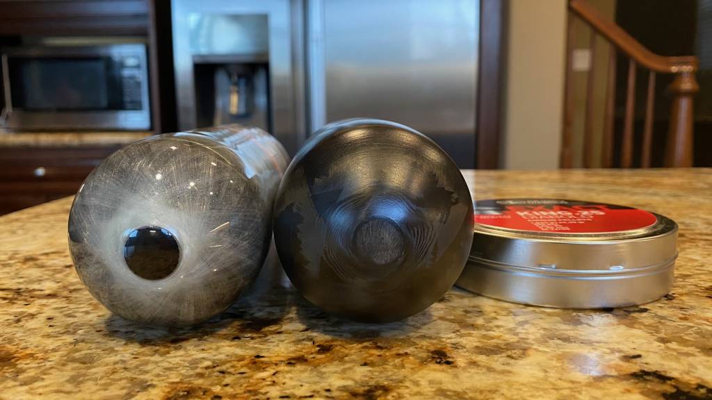

I got the 350cc (.35L) fiber bottle from Spain a week ago. Increased number of magazines per fill to 2-3 times more. very happy with it.
the tank was 179 euro + 39 euro shipping to total 218 euros ($257 (1.18:1)).
its about 1.2 inches longer.

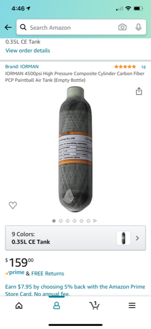

Was on amazon and found a .35L 4500psi carbon bottle with M18 x 1.5 for $159 shipped free next day delivery.
