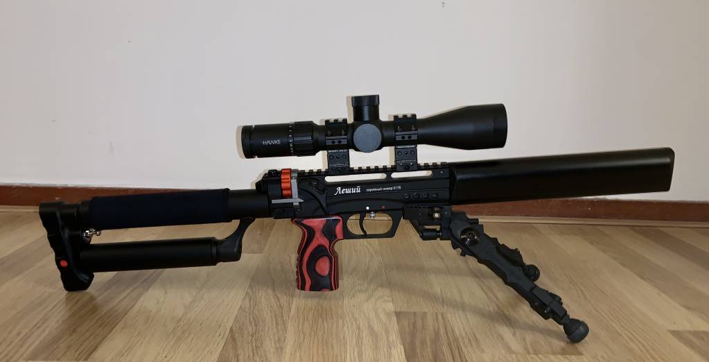

My Edgun Leshiey 2 is ON ITS WAY!!!! The gun and everything is supposed to be here this coming Friday!!! And that photo looks so much like me, minus the hair, beard, but other than those things...100 % me (mainly crazy look) 😉

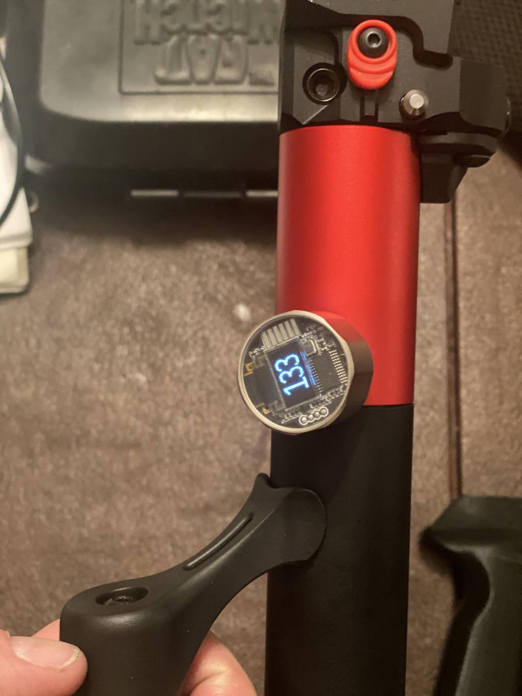

I’m not getting any where close to 945 FPS with 16 grain pellets out of my 350mm .22 out of the box. Getting in the 890’s so 18.1’s would be slower yet. What chronograph are you using? I tried to use the reg tester today for the first time. Put it on but the compressor wouldn’t get above 1000 psi. Turned it off and it leaked that pressure out. Took the tester off and put everything back together and it took a charge no problem. Has to be leaking somewhere but I couldn’t detect where, any way the regulator end had 130 written on the end where the adjustment screw is. I thought the .22’s were set at 120 bar. So why is it marked 130? The tester will tell what it really is once I figure where the leak is. The regulator tubes threads didn’t regulate with the tester either. It was 180 degrees off so the butt was upside down when it bottomed out. I thought everything was supposed to pretty much align when assembled.

Tighten that knurled screw on the reg tester with vice grips. You can't tighten it enough by hand (at least mine is that way). Also make sure to close the little bleed screw on the valve! This is the assembly order btw..

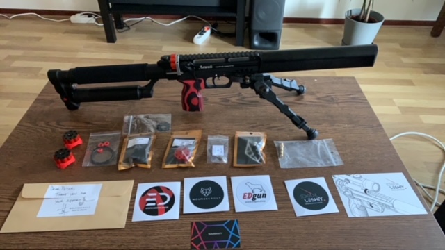

Well it is here 4 weeks and 2 days early.....my Leshiy 2 in .177 with the 350 mm barrel. Beautiful and impressive workmanship, but the probe is leaking. Ordered the gun from Francisco at Edgun.Shop, and he included a few extras, and below is what I got except for the 300 cc bottle. Won't worry about it for a while, but have it.
HOWEVER, the probe seems to not be working correctly and I am getting a lot of leaking and so the gun won't properly fill. Here is the string for the details and photos of the issue I have already posted: https://www.airgunnation.com/topic/its-here-its-here-edgun-leshiy-2-but-houston-we-have-an-issue/ 😢
However, again though, I know I am super lucky to have the gun so soon, and Francisco I know will make it right. Also it is one of the first 200. :D Serial number 176. Just glad I have the gun before my cousin, need to make him green with envy. 😏
So did yours bleed through when you filled it and just tightening the knob by hand before you used the vice grips? Sorry, I haven't used my reg tester yet. Still waiting for my gun lol.
I had the same experience. Had to tighten the knurled knob on the reg tester with pliers.

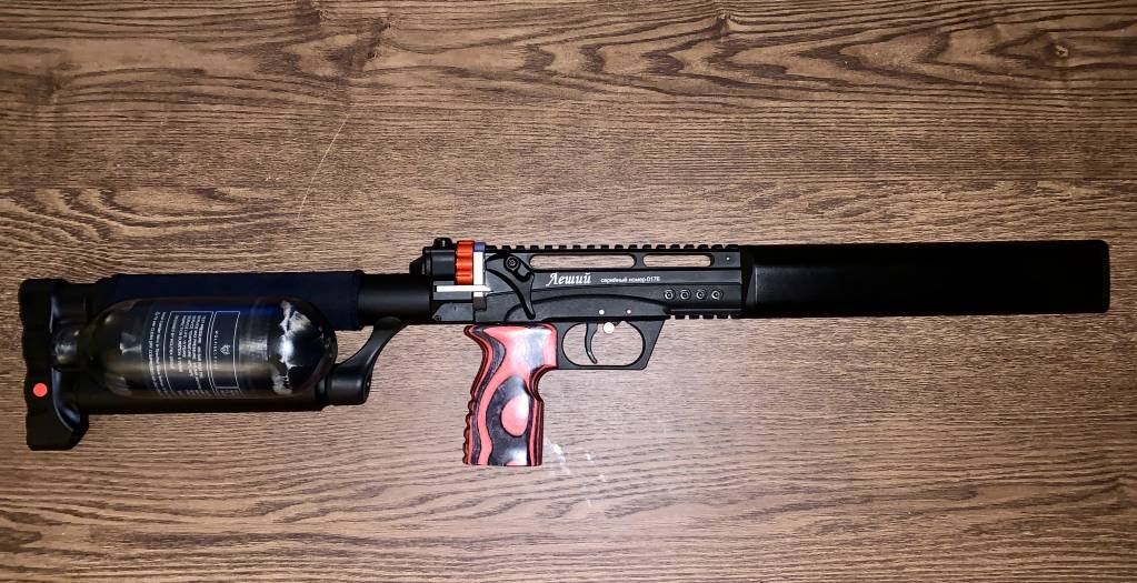

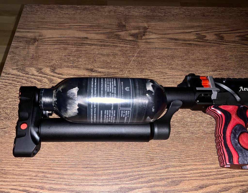

Though not installed here is a size comparison of the 300cc bottle looks like overlaid / placed and there is a ton of room between the bottle and handgrip. If I got the 350 cc bottle with out the power plenum I think it would be a bit snug.
