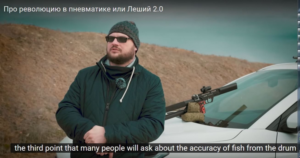

I would think the indexing is done pneumatically as mechanically would require a very long trigger pull - here's a screenshot from a Russian video that shows the linking of mag and indexing - trigger and valve, I'll bet there is a lot of info there if you understand the language
https://www.youtube.com/watch?v=VO71b-E36ac
I figured it was pneumatic, otherwise the trigger pull would be very long and heavy... Unless the mag indexing is done via a wound up clock spring and indexing pin, but that doesn't appear to be the case, because then the trigger would still have to reset the hammer on every shot.
So that still leaves my question of is there a minimum regulator pressure or muzzle energy required to reliably cycle the action. Guess we'll have to wait for Ed to chime in.

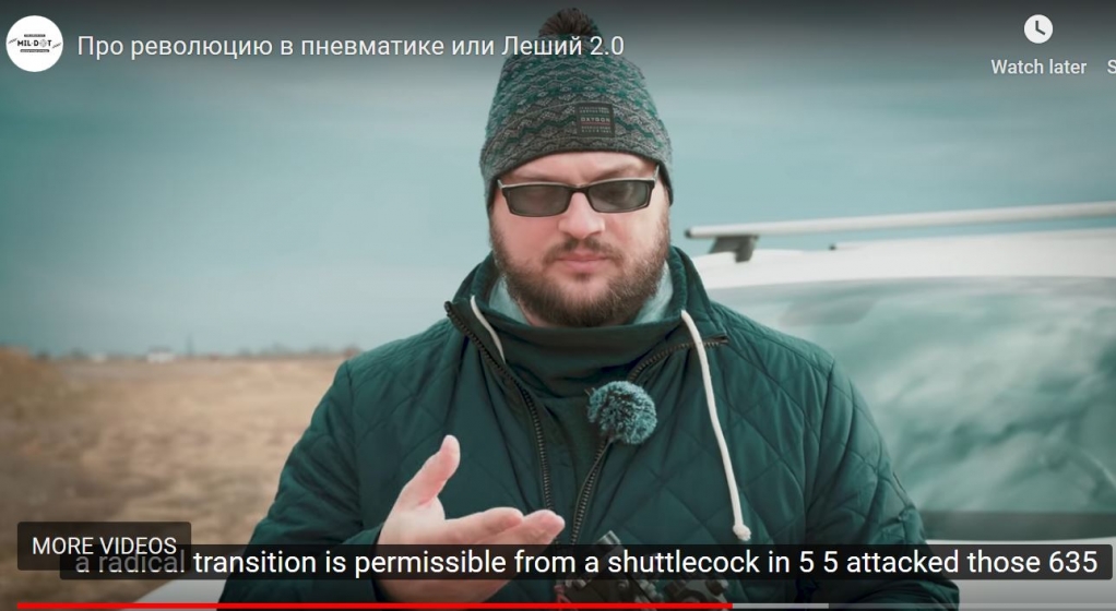

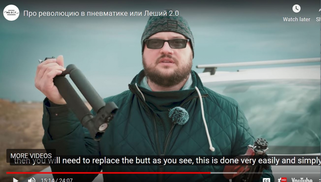

What I get from this video is that the unit with the regulator and valve etc. is caliber specific but I could be wrong
https://www.youtube.com/watch?v=xA0d3szCy_Q
