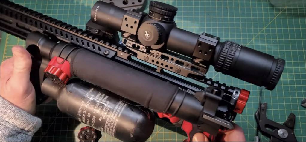

So I got this today..
350cc.. Didn't realize that there was going to be an interference issue with the trigger guard when folding it closed! I started thinking, why not make a little spacer / bushing with dual-sided grooves for o-rings to seal it?
Then, someone today told me that some dealers already thought this through and came up with spacers. Do any of you have one? If so, is it threaded or does it just slip over the threads on the bottle receiver?
I’m still confused. You say the neck is too short but it is the opposite end of the bottle that appears to be hitting the trigger guard the way your posting the pictures. Lengthening the neck will only compound the problem. The bottle needs to be shorter to allow it to clear the trigger guard. Others have installed the 350cc bottle and can still close the stock completely. I have measured my top tube from where it joins the butt to the valve assembly block and it measures 9 1/8” . The 350 bottle should measure 7 1/2” long by 2 1/2” diameter, which when folded does overlap the trigger guard by 2” but when folded it is offset as is the stock OEM bottom air tube. So is it the diameter of the carbon fiber bottle that is your issue? I plan to get the 350 bottle and it doesn’t bother me that it would not still fold as i don’t carry it folded when hunting. If I want to pack it I can just take the gun apart or put the original tube back on it. Again how are others able to fold their stocks. We need more people to chime in on this that have the 350cc bottle.
Yeah, I had a brief moment of derpness (busy day today). The trigger guard does interfere with the 350cc bottle, but I fixed the problem by slightly unscrewing the stock via the plenum tube threads (going into the hinged valve body).
It cants the buttstock slightly counterclockwise 2-3 degrees, but it allows me to fully close it and lock it down. I prefer the slight CCW canting anyways (which is how I have had my single shot Leshiy setup for over a year now).
