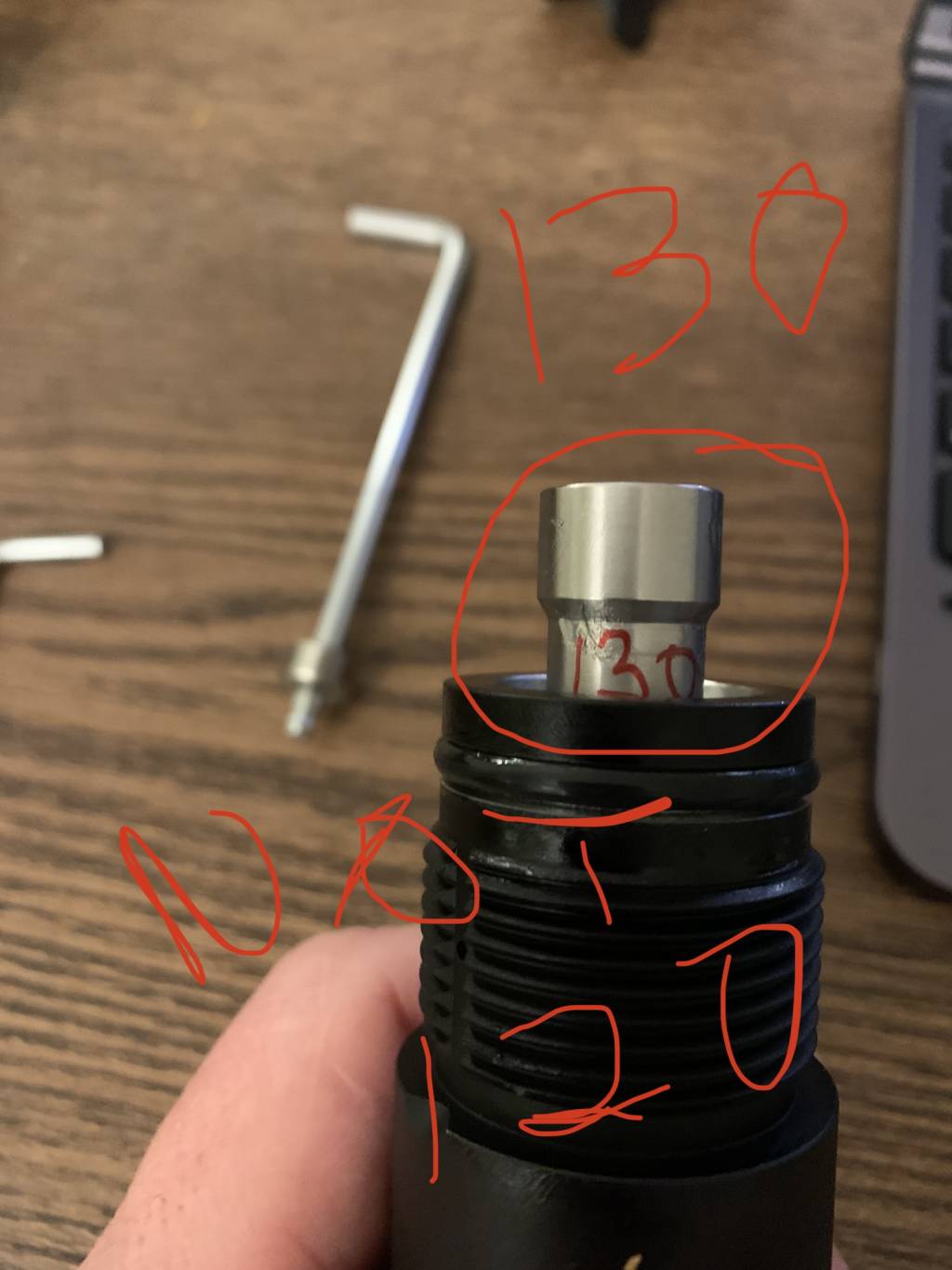

1) Pressure regulator set at the wrong setting for a 4.5 mm / .177 caliber gun (see attached photo previously posted)

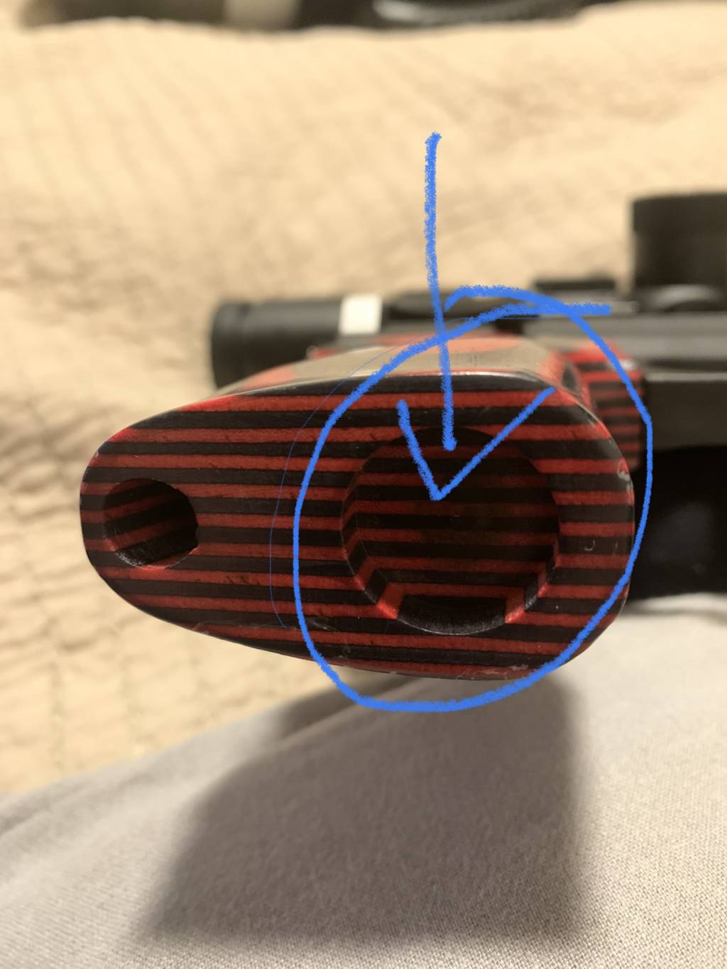

2) Grip no magnet attached in the base of the grip, no biggy and I already plan to find a different grip and replace it, mainly because my hand just doesn’t like it.

When I did the first chrony numbers, all posted, I was getting over 1000 fps / 300 mps from 8 gr poly mags and with JSB 13.43 gr monsters 24 ft/lbs & from 10.34 Heavies I was pushing an average 958 fps and 21/22 ft/lbs. I decreased the pressure to what should be in theory 120 bar from the labeled 130 bar (incorrect setting) and the heavies dropped to 932 fps average, this is more where a Heavy should still be but still a bit hot. Once the tester arrives I will start doing some serious measuring etc.
Again, the gun is beautiful, handles well, but far from not having kinks in it, and I am basing all of my views off the data / I have collected and posted myself. I have a background in engineering / science and material testing so I know testing methodology and I am halfway mechanically inclined.
So mistakes were made...now it up to the users to correct them and communicate to the dealers and manufacture to ensure other’s don’t get the same issues. Everything that happened were OEM...and nothing was changed and I mean NOTHING until yesterday evening.

@molasar, but was there supposed to be one there when the rifle was shipped, or we add it ourself?
Yes, that is for magner, but the point is that the handles were sent to Brian directly, and I had no chances to install the magnet there and, franckly speaking I just forget about it, so I didn't tell him anything! Since I still use the "old" handles withou that magnet place! :) Sorry for that!

I believe BlackPaw said his regulator came set to high from the dealer. I believe he posted a picture of the regulator with 130 written on it, when it should have been sent at 120 bar. If you look Brian‘s video at 3.55 min he says the .177 regulator pressure should be 110bar.
