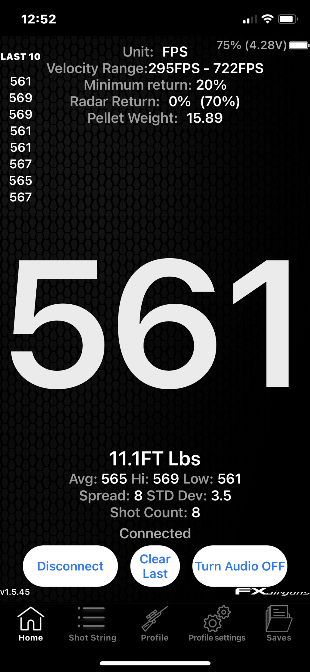

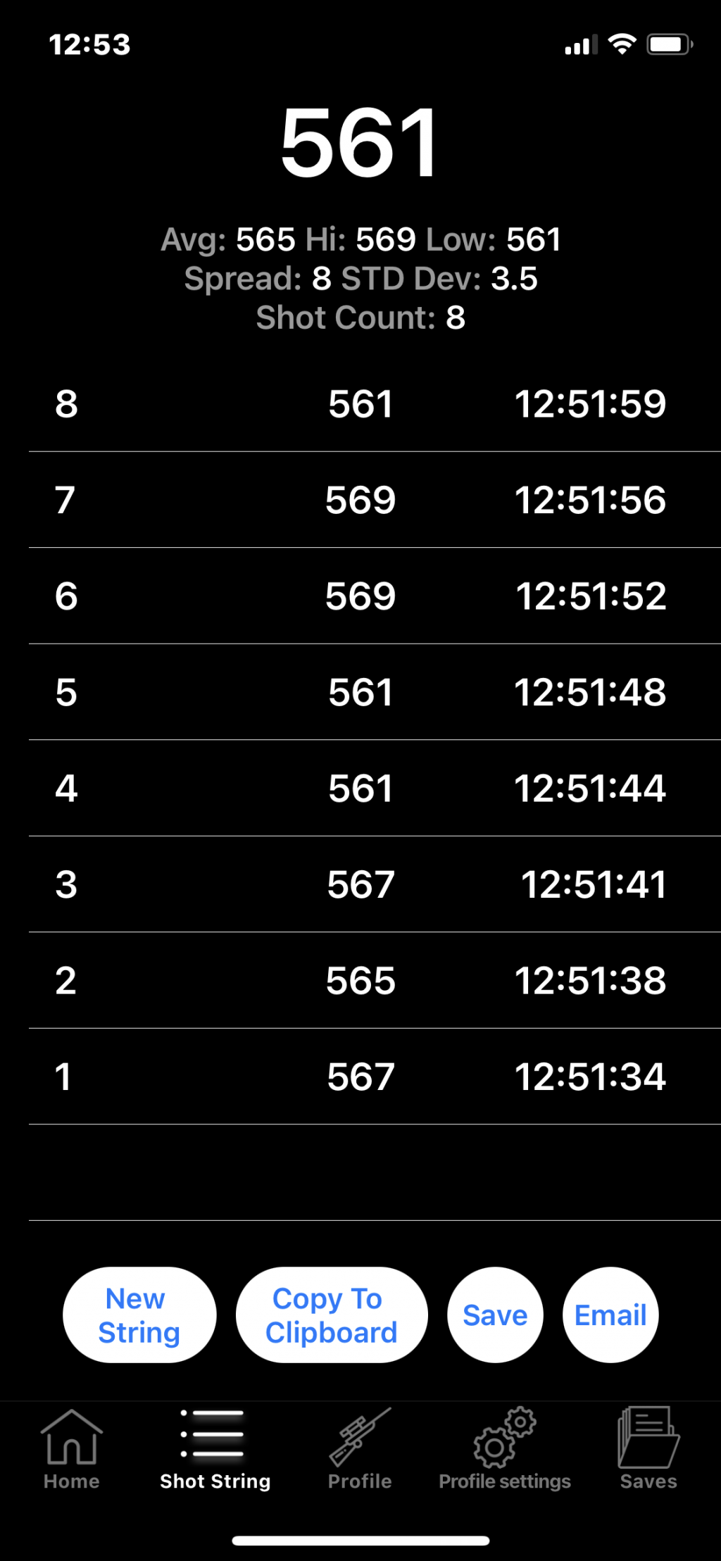

If anyone is interested in the low power capabilities of the L2 using the nozzles I’ve just completed my tune, I’m in the U.K. and whilst I own fac rifles the L2 for me is off ticket and intended for short distance low power rat/barn shooting so 11fpe was the goal, My L2 is .22 350mm, I don’t have a reg tester yet to confirm but going on the 5 mins of adjustment = 10 bar I’m estimating the reg to be around 65-70bar, I’ve installed 2 x 1.0mm nozzles and transfer port is 3mm, I’m right at my target of 11fpe and using approx 1bar of air per shot, I have a 220cc bottle fitted and am able to get 200 shots from a 260 bar fill down to 60 bar, very happy with this set up and can’t Thank Francisco enough for all the help and support he has provided me from the start
