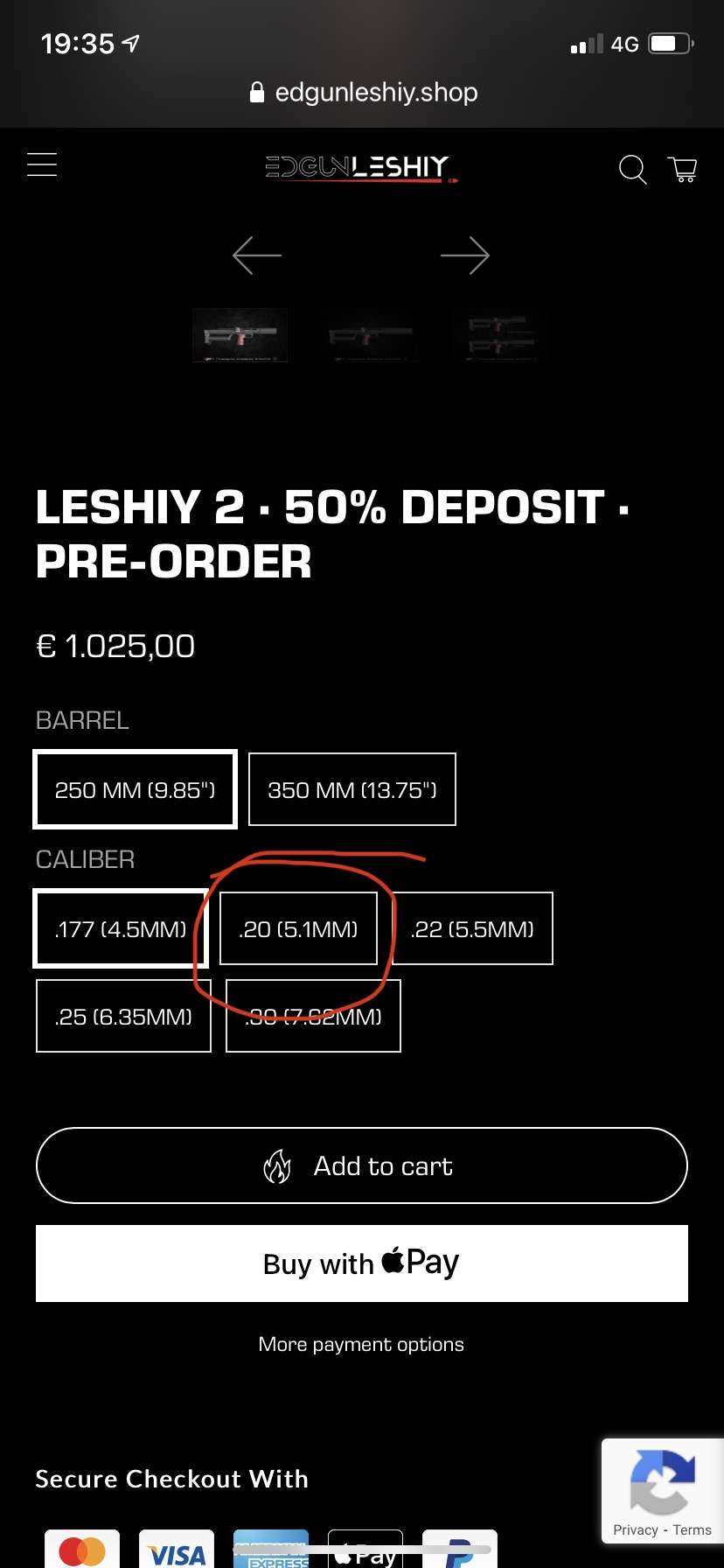

To follow up on my post I originally put an order in with Francisco for a 20 caliber and Joost here in the Netherlands is selling the 20 cal too, the last I checked. But I went for .177 cal because at the time there was a chance I was moving to Denmark, but didn’t happen and now have gun, and do an don’t regret it. I thought someone had a 20 cal barrel so why i was asking. I guess Brian figured they wouldn’t sell so he opted not to carry them. Here is Joost’s site..20 caliber = 5.0 mm.
Right here. I’m thinking of ordering one from Francisco.
Ah I see, it appears that the 0.20 caliber is not an option in the US. I don't think it's a very popular caliber here in the US; I remember when the original Lelya was around, it was mostly offered by Ed in the 0.20 caliber and it was one of the very few guns that I saw in that caliber. When I got my first Lelya, I made it a point to get the 0.22 because I've never had a 0.20 pellet in my possession.

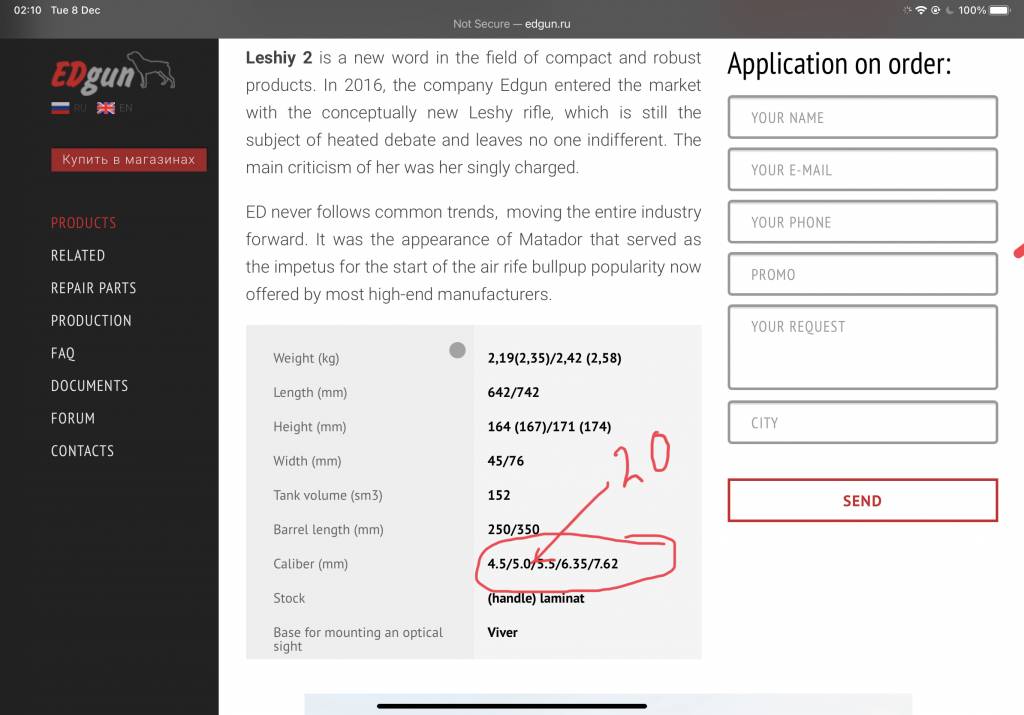

@edgunwest - Well, I will say this as a counter opinion. The BC per weight of a .20 cal is superior to both the .177 and .22 cal.
In the firearms the 20 caliber has become quite popular for varmint hunting and there are two commercially available rounds 20 cal tactical and 204 ruger. Plus all the wildcat rounds. I would love to see a resurgence of the .20 caliber in air arms, because it does have several advantages referring what I already said above.

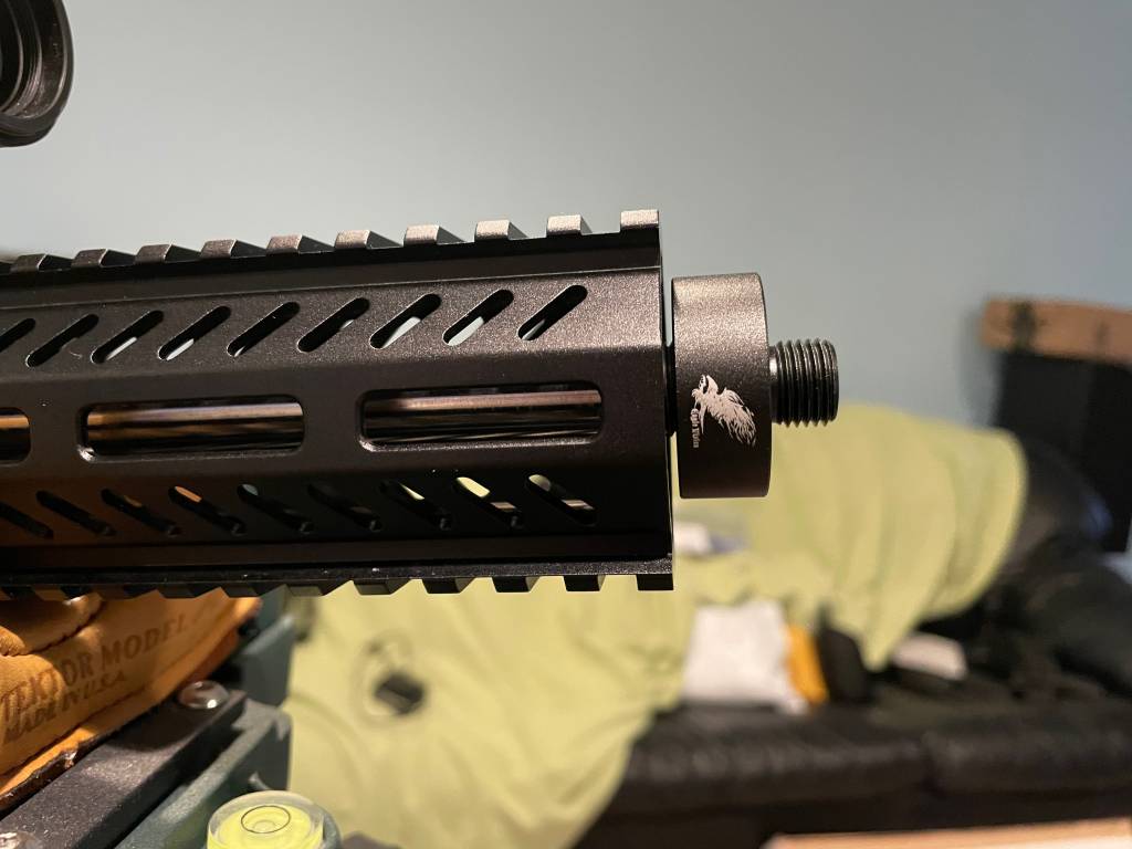

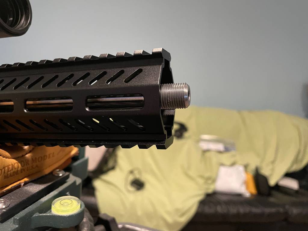

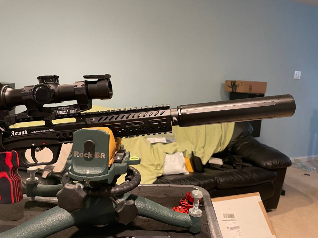

Another Leshiy 2 moderator option. Some credit going out to Y'Odoyle as I saw him mention an adapter in a completely separate thread. Someone was asking a question about an adapter for a Vulcan which would go from 14x1.25 to 1/2 UNF and @Odoyle mentioned an Eagle Vision adapter that AoA sells. I hopped onto AoA and ordered the $15 adapter.
The problem with adding a moderator when using a Valkyrie kit is that even if it has 14x1.25 threading it will likely not thread in all the way (The Donny Koi will fit inside the rail). Once tightened, the back of the moderator has been tightened up to the end of the rail. This does not produce good results as the moderator has now been tightened and aligned to the rail and not the barrel.
As you can see the full threads are not fully exposed when the Valkyrie rail is installed.
I was very pleased when I saw that the EagleVision adapter would tighten just before the rails.
I think this give a nice mounting option and accuracy is maintained.

This is a good option, Sean. I'm being stupid and want to keep the overall length as short as possible so I do have my Ronin screwed directly to the barrel and pressed against the rail. I guess I was lucky enough to have it pretty well aligned because groups at 35yds are very good and repeatable. I can see how that could change if the Ronin came unscrewed from normal handling or whatever. As is, the only thing I did was put some protective tape on the rear endcap of the Ronin so that I could screw it on tightly against the rail and not get it all scratched up. Works so far so fingers crossed.
If that changes over time, I'll bite the bullet, order the Eagle Vision adapter and add that dreaded extra 0.75" to the overall length ;)

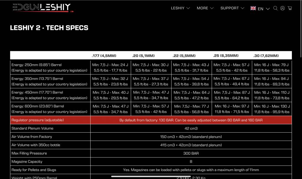

Edgun Leshiy 2 data / specs / etc posted by Francisco at Edgunleshiy.shop. Here is the link and snapshot of what is there. Most thorough technical data I have seen so far. https://www.edgunleshiy.shop/pages/leshiy-2-tech-specs

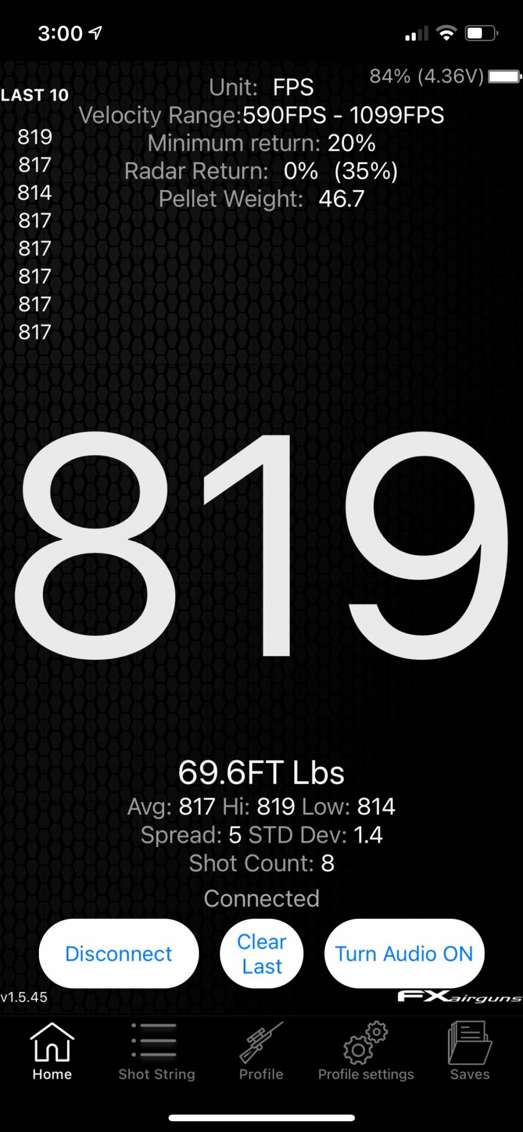

Thank you for posting this. I just did a test with my .30/350mm barrel. 0.2/0.2mm nozzles. Reg at ~150 bar. H&N 46.30 pellets sorted by weight in 0.20gr groups.
With the JSB 44.75 I was getting about 71 fpe. So these max fpe number listed are pretty close to reality.
I was also maxing out with the .22/350 barrel around 40fpe with JSB 25gr pellets. So again - pretty close to listed numbes.
