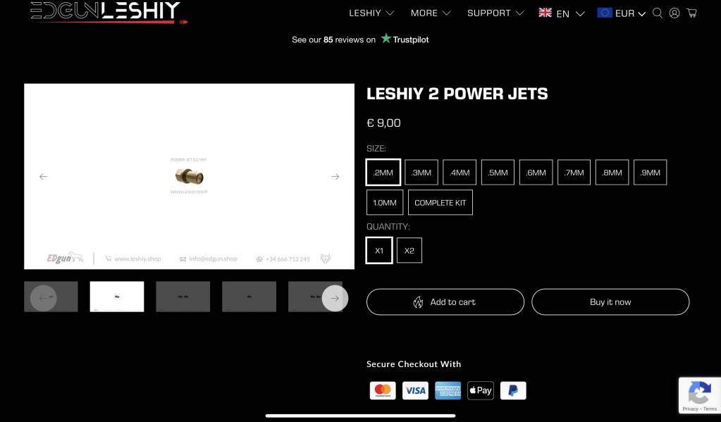

@deepbass9 you make good points. The Leshiy 2 is an amazing, but very expensive gun with direct and hidden costs to be all it can be like the jets. You can buy the jets from EdgunLeshiy.shop individual for your needs.
True, but by the time he buys a couple of jets and pays for overseas shipping . . . and in the currency conversion and the extended wait time, it's probably better option just to bite the $90 USD bullet and buy domestically.

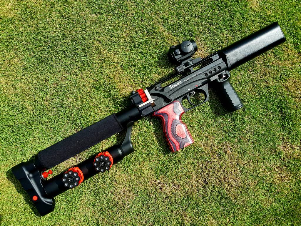

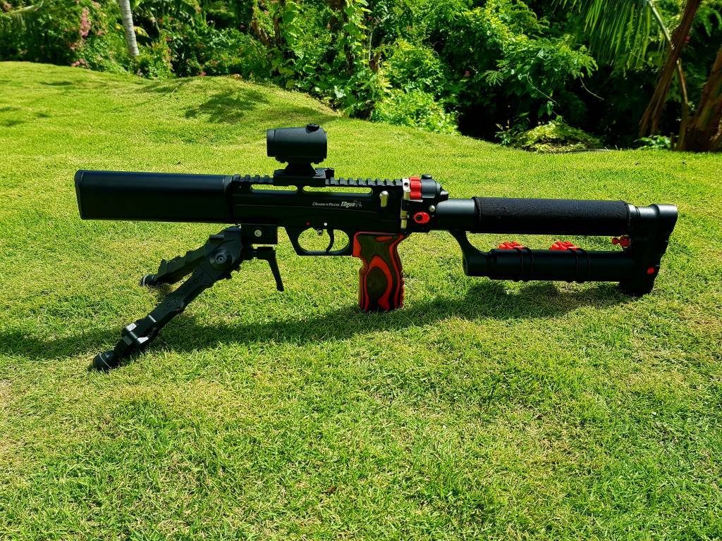

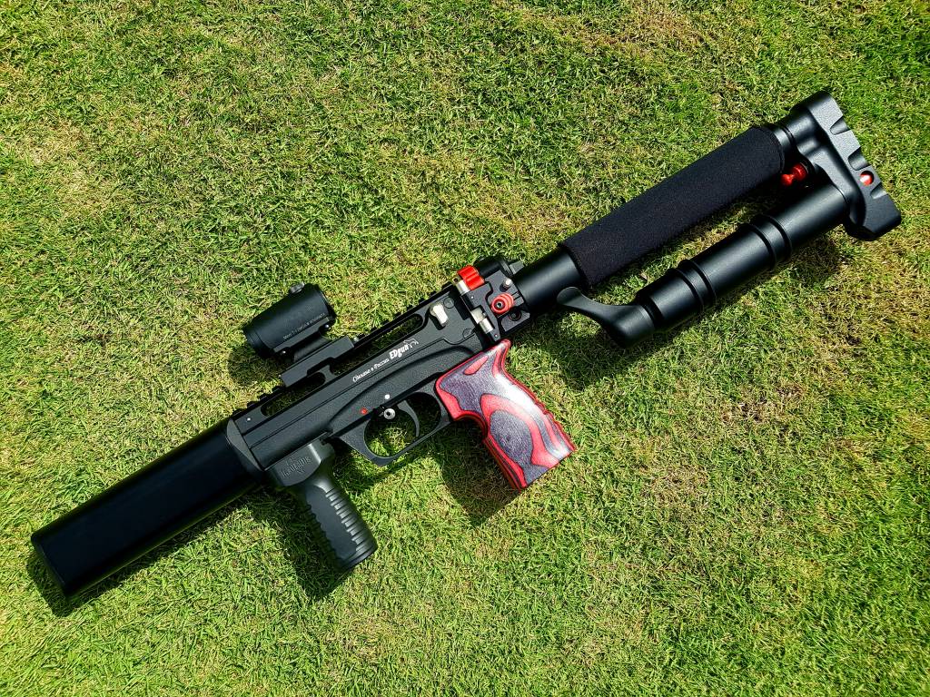

Enough of the fuss. Time for some obligatory gun in the grass pics...
For now, I have it setup with my Aimpoint Micro T1 with LaRue Absolute Co-Witness QD mount and LaRue F.U.G. vert grip. I'll set up my scope when I have the time to properly mount and zero it.
