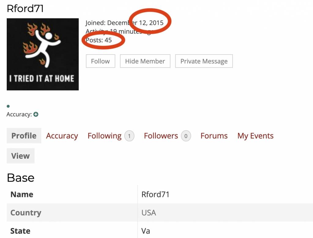

Pay him no credence. 5 years on the forum and 45 posts - you can see he's been a real contributer to the forum.

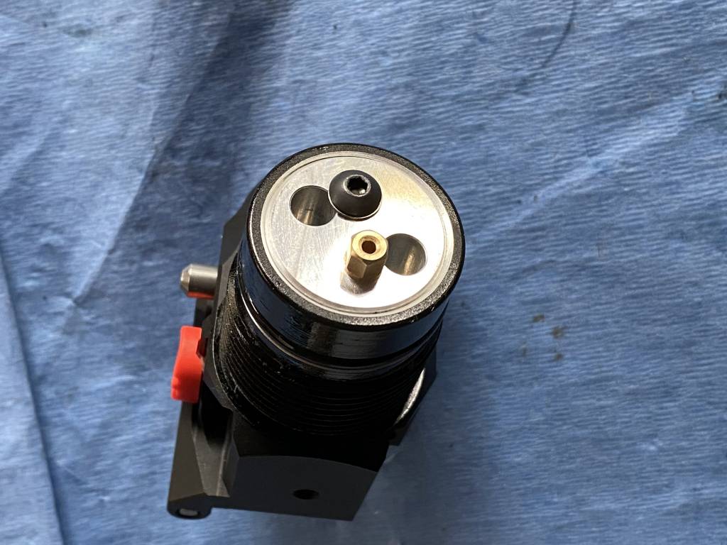

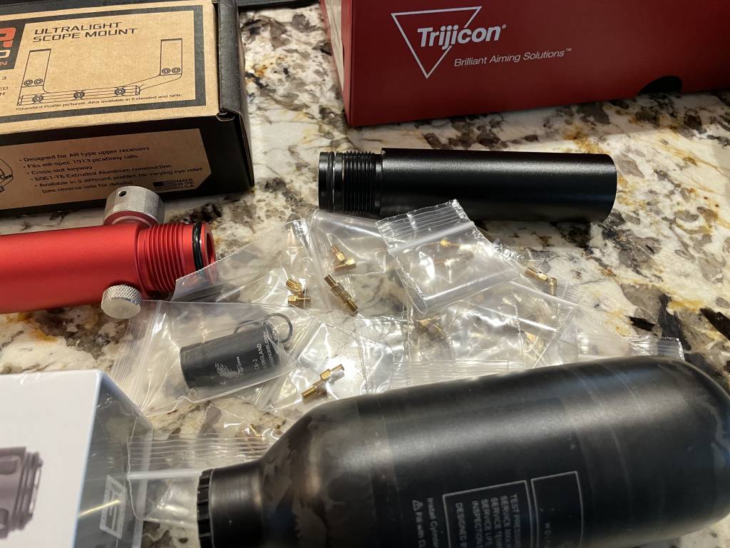

What were the bolts you bought on Amazon for?
I'm having trouble following with all the other conversations going on.

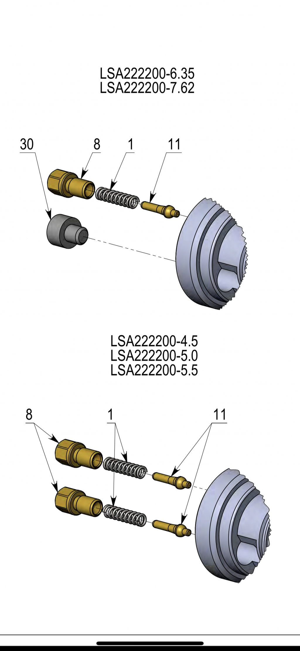

That amazon order is for a M4 bolt to replace one the the jet. That’s how my .30 cal L2 valve came.
according to the Leshiy 2 schematic both .25 and .30 valve came with only one jet and a M4-4mm screw in place where the second jet goes.
