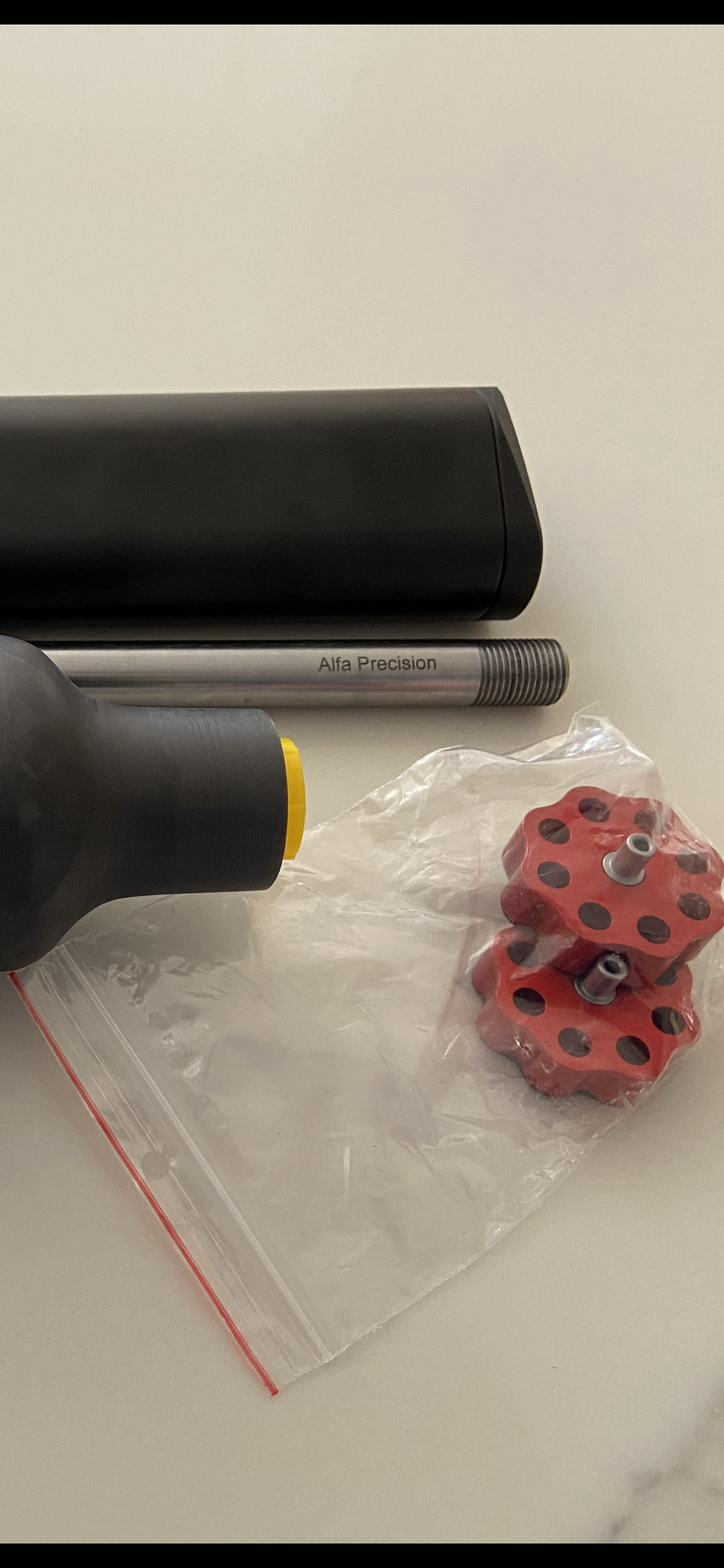

Original 30 cal 350mm Alfa barrel swapped over to 22 cal 350mm Alfa barrel. Same reg at whatever it came from factory: likely 130 bar, and factory nozzle/nozzles. I have no idea what I have in mine. Never even looked. All I did was swap barrels and install the new CF bottle.
Cleaned the barrel and releaded the barrel with 18g JSB’s. They’re flying at 945 FPS. My 30 cal 44.75g JSB’s fly at 805 FPS. Stock transfer port puck too.

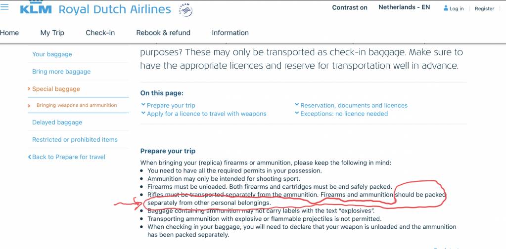

And it’s amazing how taking pellets on a plane is a pain in the ass not worth it. So I ordered pellets for the two rifles in 177 and 25 Cal from pyramid air.
Black paw, are you taking your air rifle on the plane? If so you should be able to pack your pellets in your checked luggage in a locked case. This is normal procedure for hunters taking their powder burners and ammo on hunting trip on airlines. That said I know there are some countries and airlines that don’t want guns brought into their airports so you need to check the airports and airlines policy on that even if it’s just a lay over and connecting flight. This happened to me back in 2012 when trying to figure which way to use my mileage points for a hunting trip to Africa. They didn’t cover South African Airlines which was a direct flight so I would have had to go to London and then to Frankfort then to South Africa. My agent told me that England and Germany were not gun friendly and I could run into problems at the airports getting my guns onto connecting flights even with TSA permits but that was a bad year with terrorist and the olympics were in England . I don’t know if it has gotten any better through those countries or how it is in The Neatherlands.
@Letherman - for TSA you are correct, I can pack pellets in my check in luggage, but that is for USA. KLM says ammunition and I couldn’t find anything that distinguishes pellets from firearm ammunition in their rules. The agent said the pellets need to be in a separate hard case, so I decided not worth headache to argue with those that control my fate over $50 in pellets. The Taipan is staying in the USA anyways. And finally my Leshiy 2 will get a its intended purpose report, hunting / pesting out in field. The same goes for the Taipan. My Dutch shooting buddies tell me of the nightmares of plane transfers in Germany with even a rifle scope. My buddies tell me they tell German customs the rifle scope is a spotting scopes if asked (which is technically true) when there is no gun for it.
