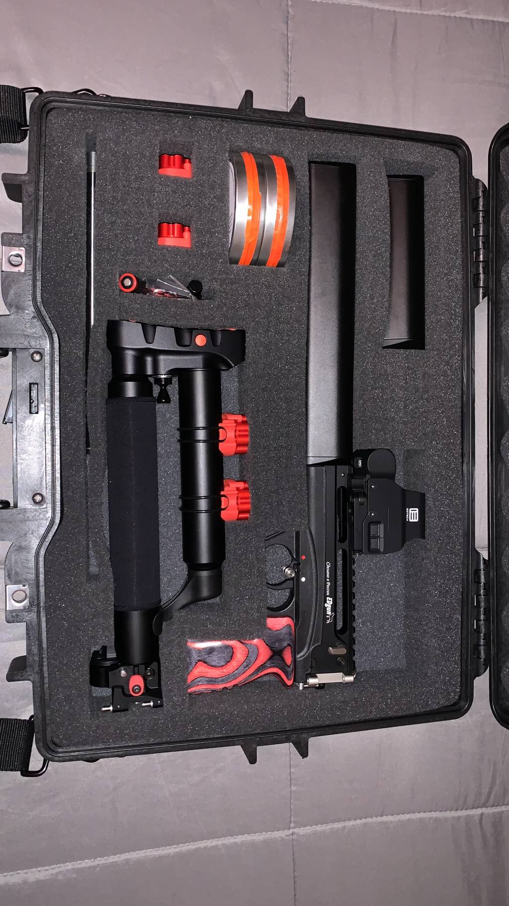

My L2 was delivered today. I’m going to run a SWFA 3 x 15 scope on top and was wondering about scope ring height to get proper clearance, does anyone know for sure if I can get by with medium height rings? Going to store tomorrow. Any help would be very much appreciated.
Beach-gunner
Dennis
Congrats! Such a great feeling when it finally arrives, isn’t it? Hang on for those of you waiting! Trust me, it’s so worth it!!
So I have the EOTech EXPS2.0 on mine and that’s equal to about a medium height ring. I’d say go with the talls because I could use just a tad more height when shouldering as I’m standing up. It’s doable but you will only be grabbing the tail end of the butt. My experience anyways.

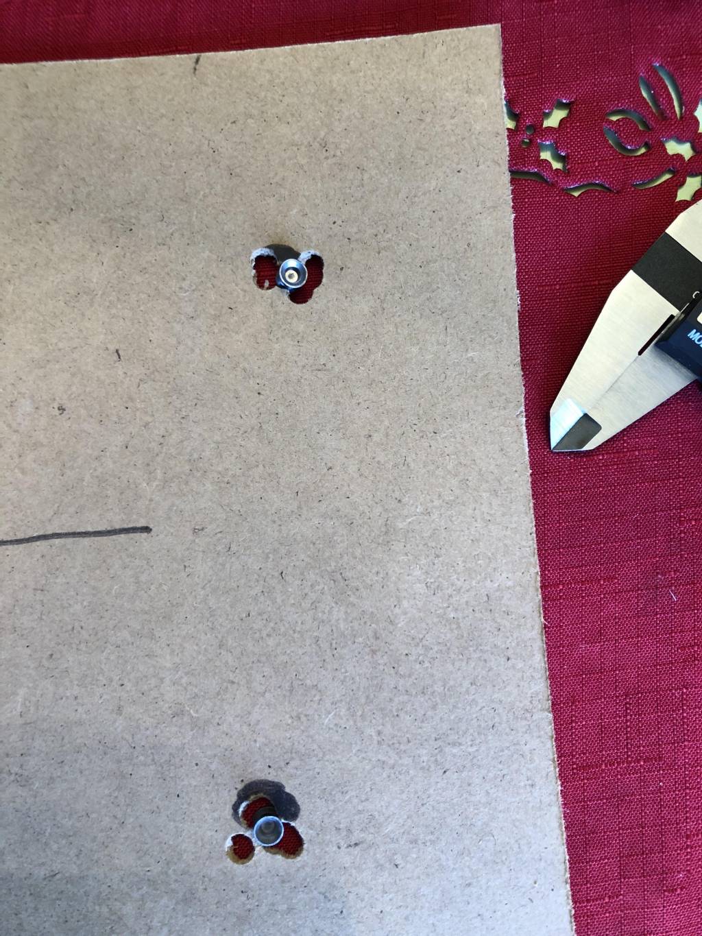

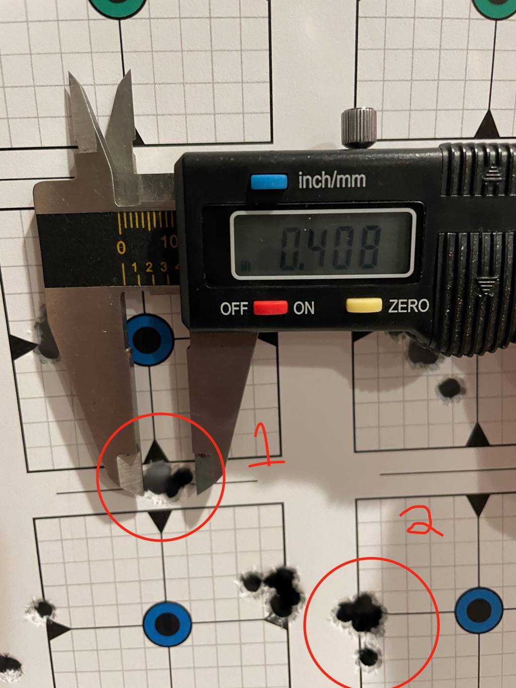

I think I've narrowed it down to 3 slugs at this point. 2 - 8 shot groups below with the leaders. I can't recall which is which of the 3 slugs, but group #1 is .40 inches edge to edge in .25 caliber. I guess that would mean 0.15" ctc for that group. Group #2 is even tighter but you can see on of the 8 shots went low.

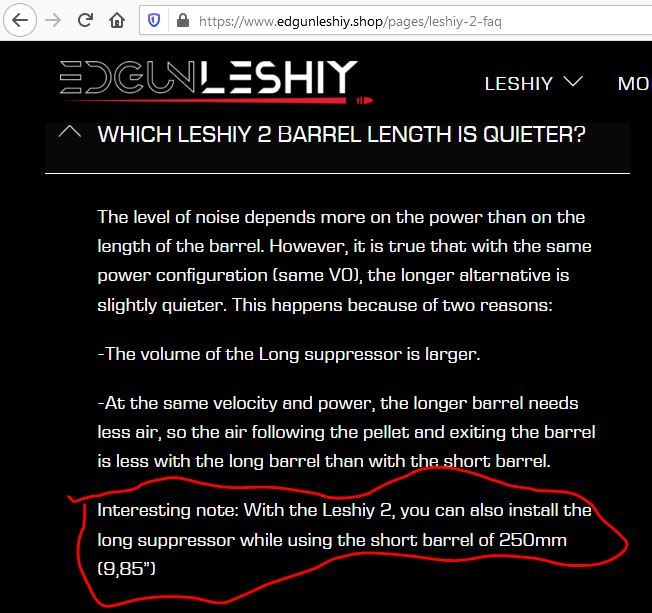

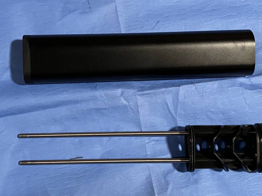

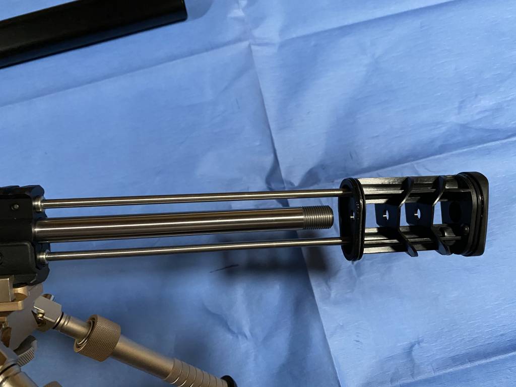

I got my L2 earlier this week as well. It is quite a bit louder than my .30 vulcan 2 with a ronin on it. I took the ronin off the vulcan and I have been running my L2 without a handgard and the ronin. It is still louder but it is an improvement over the stock moderator. I am wondering it is possible to take apart the stock L2 moderator. It looks like it should be possible to create a new end cap that would let me run the stock moderator as a shroud and then use the ronin on top of that. I would need to build a custom endcap in the machine shop. I haven't figured out a way to take it all apart yet and I didn't want to break it so I haven't tried anything yet. Does anyone know if these can come apart?
Yes, it can be taken apart. Just remove the moderator from the gun then hold the moderator body and press down on the mounting screws against a flat surface. It will put enough pressure on the front end cap to give you a gap from the moderator body and the front end cap. It’s has a couple of large o-ring which makes it tight against the moderator body. Once you get a gap between it it’s easier to pull the front cap away from the body tube.

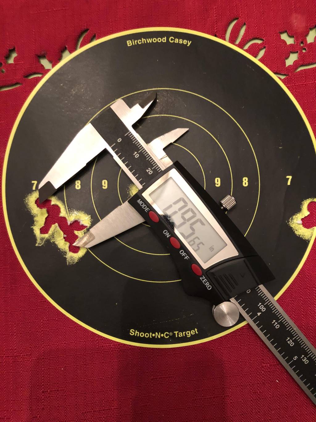

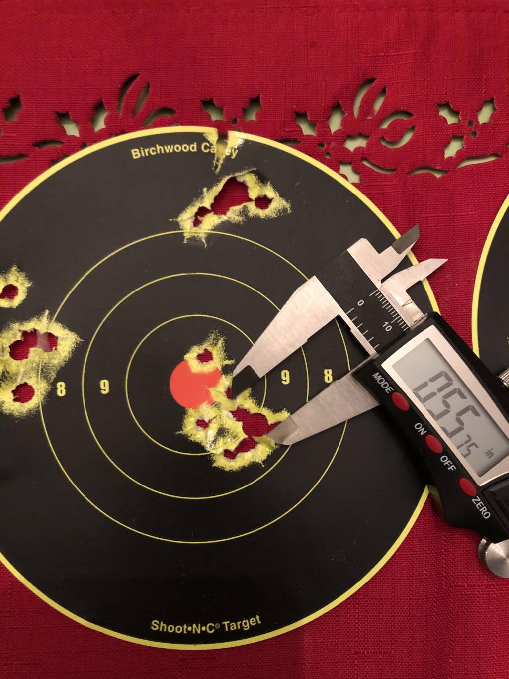

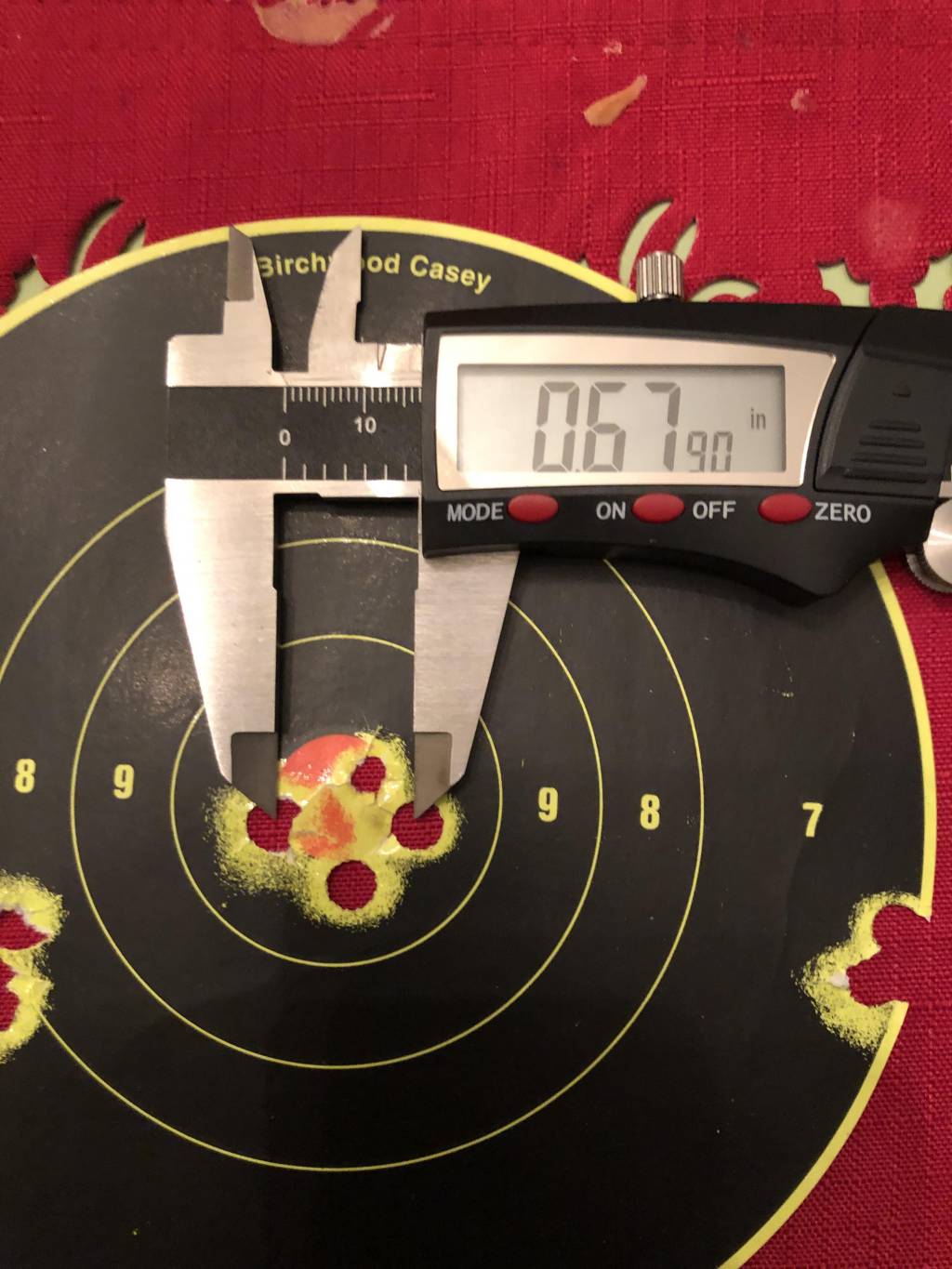

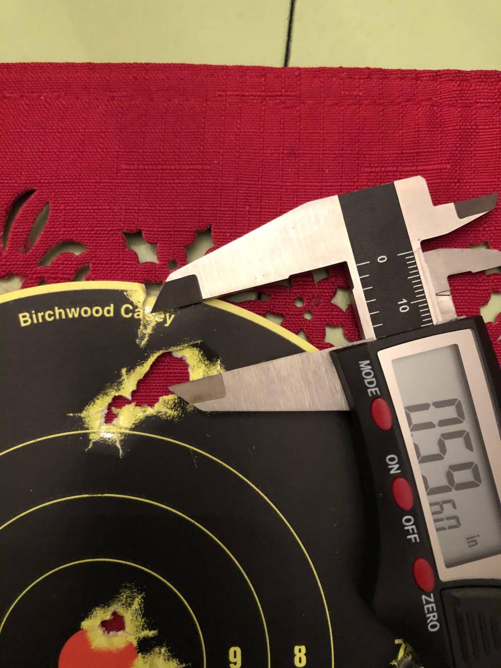

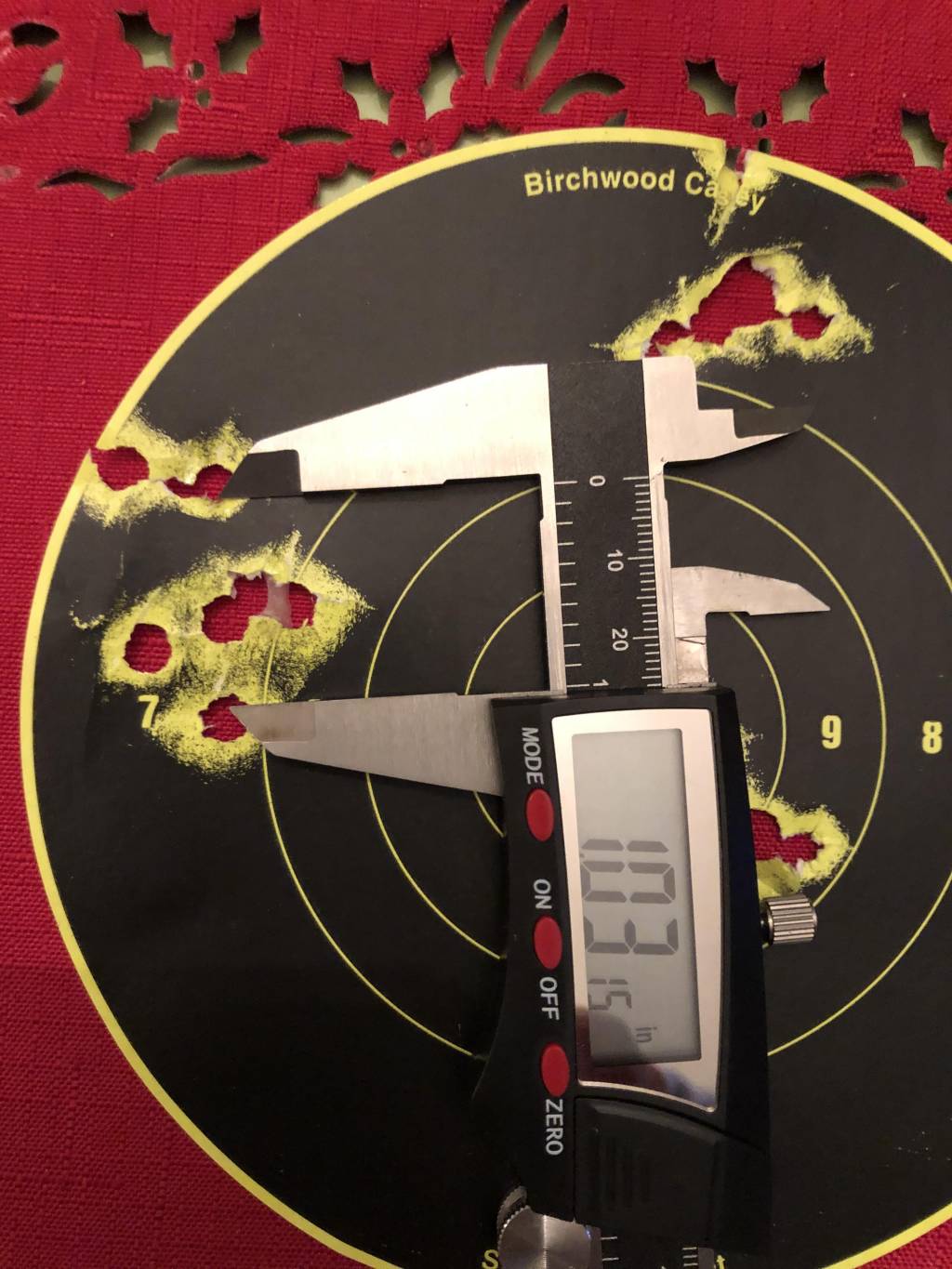

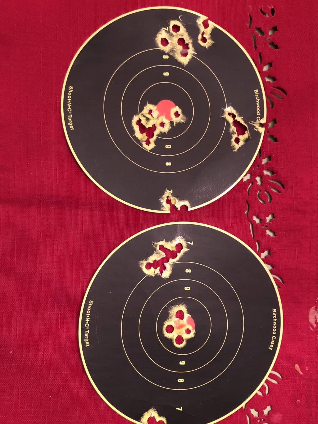

I was able to go to a shooting range today to sight in for a 45 yard Zero. Two targets and I shot the AA 25.4gr and the JSB 34gr both at 45 yards.
First pic is both targets. Second pic is the first group 8 shots with 1 flier 25.4gr AA. Third pic is second group of 8 after adjusting the elevation up slightly. Fourth pic is final group with 25.4gr AA after the adjustments. Fifth pic is the first 8 shot group with the JSB 34gr. Sixth pic is 8 shot group with JSB 34gr, fell off the regulator during the 8 shot string. All in all I think a great shooting day. Ill be using the gun as a woods walker while hunting small game and it is definitely accurate enough for me!!
Sidenote, I did tell Brian at EDgunwest that I had a pile of JSB and AA 25gr pellets and that I would like the gun to be tuned to those pellets....it looks like he did and I’m very thankful for that. Dealing with him has be a pleasure! Also I got 4 mags (32) shots with the 25.4gr AA before I re-filled to test the JSB 34gr’s.
