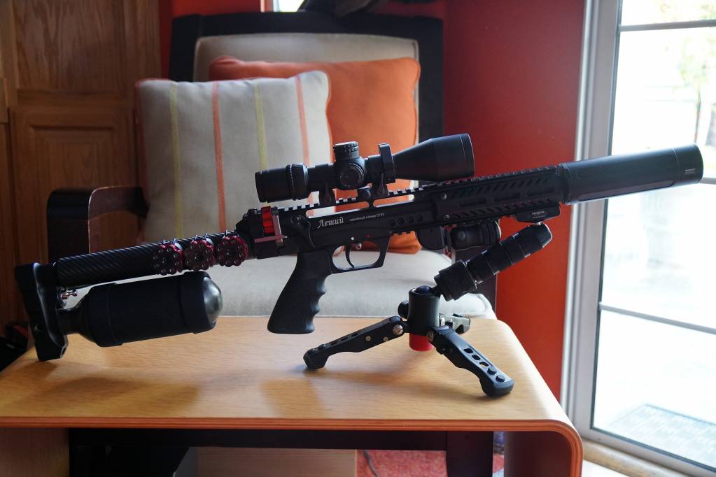

I have the 350cc installed so I'm getting about 10 magazines from a 250bar fill (you can fill all the way up to 300bar for more shots if you want to press the issue). I've never had the occasion to shoot anywhere near 10 mags on any single squirrel outing. Here's how my L2 is currently set up:
I currently have a .25/250mm and a .30/350mm with factory moderators, the Power Jets, and the 300cc bottle. On order with Brian, I'm waiting for my Vanir setup (Huma MOD 40 moderator with Valkyrie carbon fiber handguard and .25/350mm barrel). I'm on a boring work assignment today with lots of down time and just placed an order at EDgun West for a .25/450mm and a .30/450mm barrel to include a Valkyrie CF handguard for both 450mm barrels. This should keep me busy for the foreseeable future lol. As the saying goes, "Idle hands are the devil's workshop".

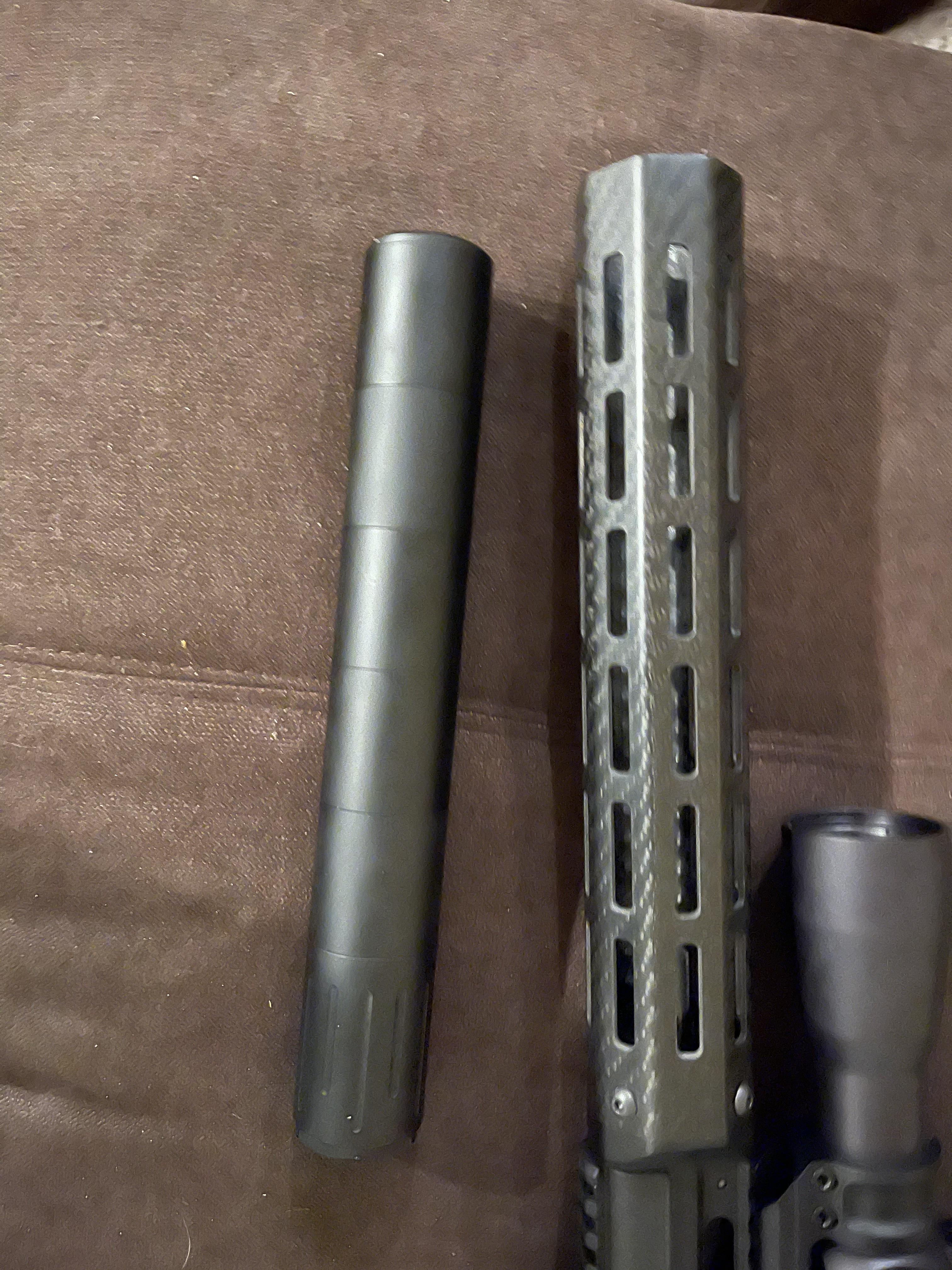

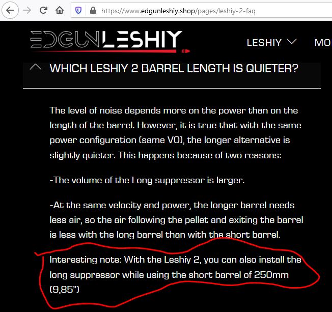

I'm not sure if anyone mentioned it or not but can the factory moderator for the 350mm be used on a 250mm barrel?
Yes but note it will be a long reach from the barrel end to exit hole so make sure its all lined up perfectly
Thanks. Gonna try this out.
Just wanna say that I installed the 350mm factory moderator on my 250mm barrel setup yesterday and it works well in noise reduction.

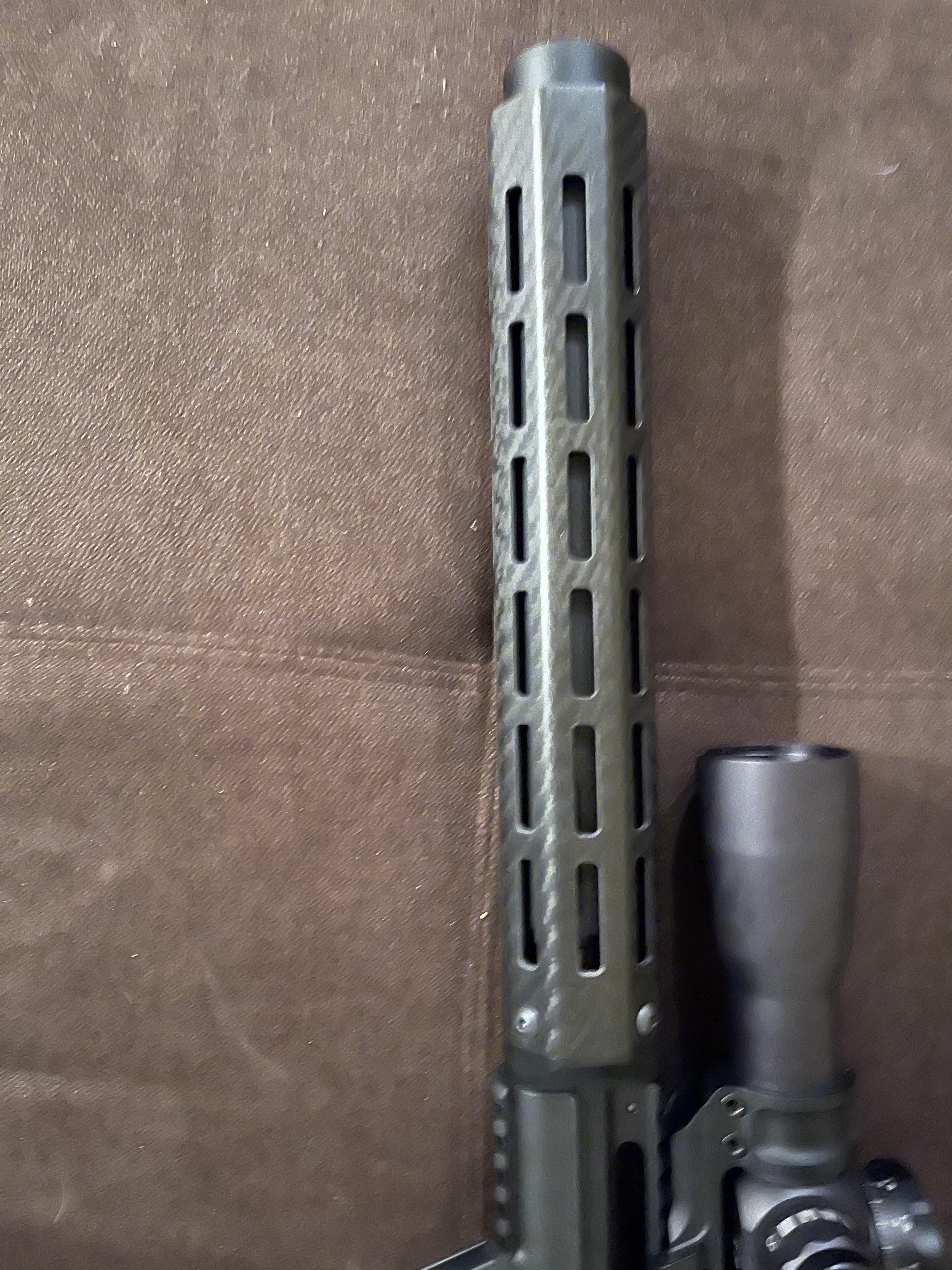

here is one set up
30 cal 250mm tuned for 50 grain at 725
CF rail
Huma mod40 7/8 stack
this makes the 250 quiet don’t waste time with the 350 OEM on the 250 doesn’t work that well and it increases the chance of clipping
