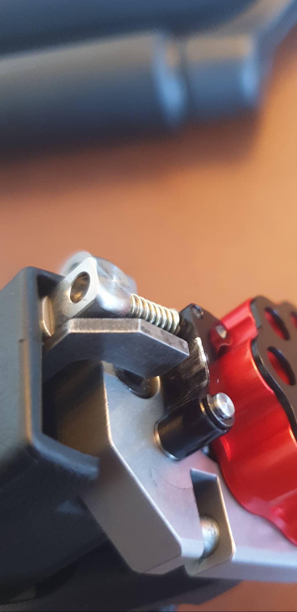

Just a bit of an update... it seems that the trigger blade is not resetting into the correct position in front of valve pin in order to take another shot due to the magazine not rotating properly.
It seems to rotate a tiny bit, at best 1/4 to 1/2 way so the trigger blade is pushed down by the magazine "hump" where the pellets are inserted.
If I rotate the magazine after the 1st shot into the correct position, it allows me to take another shot, but I can only rotate it 2-3 times max and then the magazine seems to lock up.
Hopefully this narrows it down, but I dont see any issues with the plastic parts in R2D2...
Any other areas of adjustment/failure for the indexing?
This seems to be the cause of both these issues.

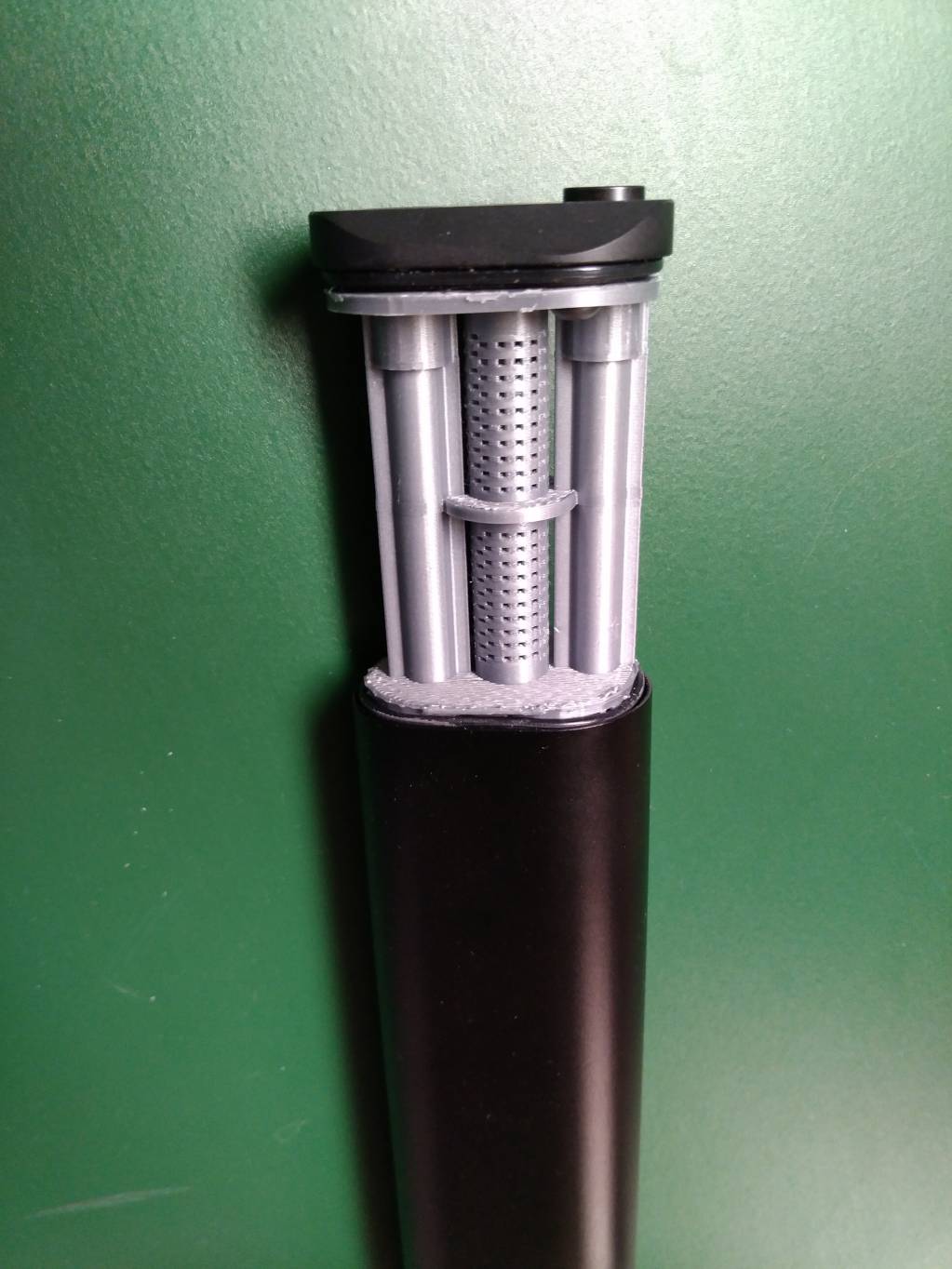

All I did differently today was fit a water filter cylinder with orange color indicating silica gel in it to my compressor intake to dry the air as my condensation valve used to throw quite a bit of moisture out when filling, immediately after fitting my diy air dryer, it no longer spits out water at all..cant be a bad thing!

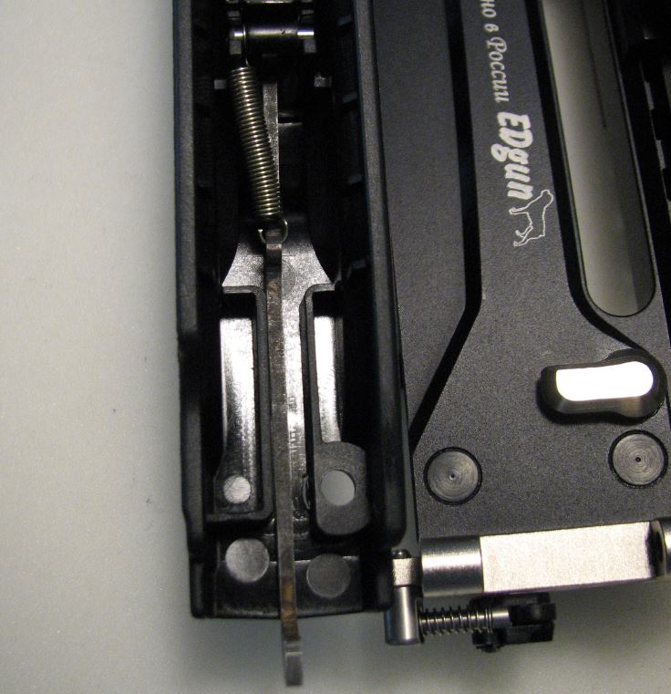

You stretched the spring, are you sure it is positioned in the left right side of the frame like this?

water will freeze at 0 degrees C be it Russia or anywhere else, any water vapor in your compressed air it will freeze when decompressed and may stop the indexing mechanism

See picture above, sounds like your spring is attached to the wrong side of the trigger pin

Pulled over by the spring, the pusher rest in a channel in the left side of the guard, in line with the valve pin short of a few tenth of mm
When you pull the trigger the valve pin will moves sideways from the pusher and the trigger will have to move forward to reset
Safety on will position the pusher under the valve pin
Yes its located to the left and holds the blade perfectly to the left and mostly vertically straight. I do wish it had a better guide for the blade in that area to stop side to side movement, i feel it would improve the design and make for a more reliable tool as there is a lot of side to side play in that area.
When safety is set, it drops the blade to the bottom.
Spring is not stretched, its not even the original!

So being the MacGyver and self confessed tinkerer that I am (just revealed my age!), I purchased an assortment of springs on Amazon and set about making a temporary replacement so I could actually use my shiny new toy. It has worked perfectly since...
What I meant was if it can handle Russian winters, it can handle anywhere so I doubt it that!
The first thing I did was bring it inside and used the hair dryer to warm things. It has also been in my cosy home all night and is still doing so. I have an air dryer on my compressor intake now, zero water comes out the moisture release valve on the compressor now.
Strangely the day I did this compressor mod (yesterday) is when my issue began! Literally within 3 magazines. First 2 I was trying out the .25 cal 33.95's to compare to the 25.39's I have been using for months with zero issues. I also shoot the .30 cal 44.75's so cant be to do with the pellet weight as the Leshiy likes heavy ammo!
Im sure its just a coincidence...
The gun is dry inside. It is not moisture related.
Its not, its on the correct side and gun has worked perfectly fine for 3.5 months as it is. Maybe a Goblin came in the night and switched it around? Just kidding, I have checked it and actually just put a new MacGyver spring in, its even better than the last and holding to the left. safety on, drops the blade to the bottom, not firing when in safe so all seems fine there.
It has been in spec since November and working fine.
Well it has always done this perfectly fine (after I fixed it anyway), until yesterday all of a sudden during normal use.
Now it will not reset back enough no matter how far the trigger is adjusted forwards (trigger grub screw all the way flush just as a test)
Yes I understand how it works as I fixed a faulty gun I received where it wasnt doing this.
Oh yes, one last thing. Does the trigger guard in your gun scratch up the bottom of the magazine roller bearing mechanism? I have noticed that mine is getting a but scuffed on the underside of the little black lever that has the roller bearing on it.
Yes that's normal, the catcher also functions as upper guide for the pusher
Apologies what I meant was Trigger blade, not guard but i think you got it!
OK, mine is getting quite scuffed and a little rough. Fits my theory of the "disconnector" pin binding next to the tigger blade and getting marred. its a bit rough on the edge. Doesn't seem right and never noticed it before. I little black wearing of sure, nut something that catches on my fingernail.
Hopefully getting my mystery solved will help others when it happens as I cant se anything I do to mine that would cause this so this could be something us Beta testers are figuring out for the longevity of certain parts. It is a new concept after all
It is well looked after and gleaming clean and I have only put maybe 1000 pellets through it at max, both .25 and .30 combined.
