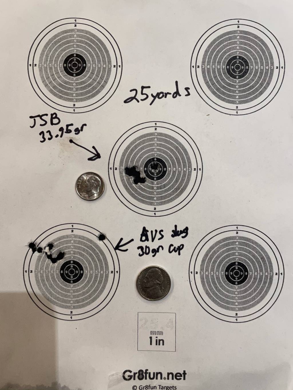

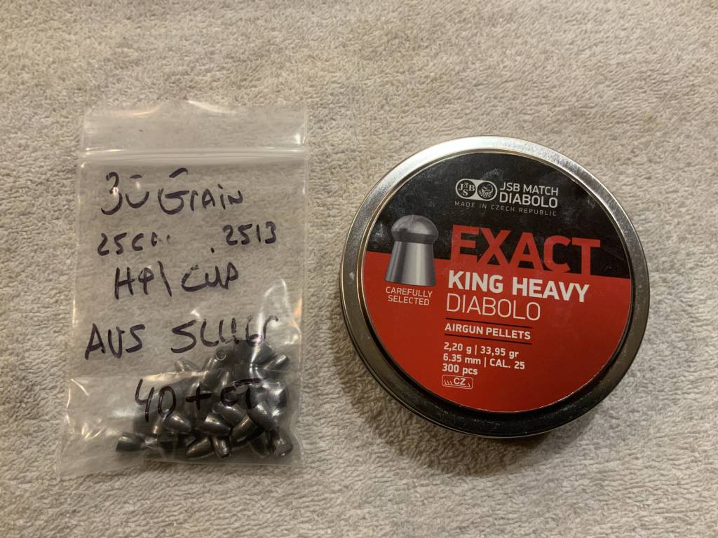

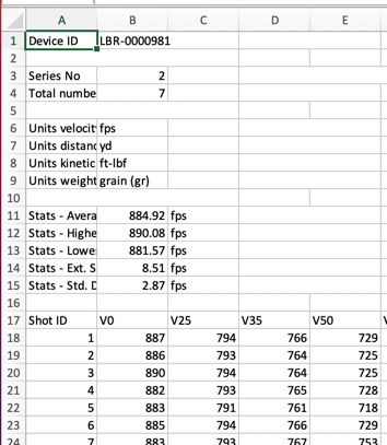

The .2 and .5 nozzles appears to be optimal set up for the L2 .25 350mm for the JSB Exact Kings 25.39gr at a speed of 880fps. But not quite fast enough for my liking, I prefer to shoot the JSB Exact Kings Heavies 33.95gr at 880- 900fps. With this setup l only get 800fps.
JSB 25.39 JSB 33.95
@Rford71 - you need to understand that the nozzles are like tuning the hammer spring. Once you get the most efficient setting you're just blowing air if you increase dwell. What you need to do at this point is increase the reg to 150-160 bar to get the extra power. You'll probably get right about there with the 350mm barrel, maybe a touch less. With .2 and .4 nozzles, 150 reg, and the 450mm .25 barrel I get 950 fps for the MkII 34gr.

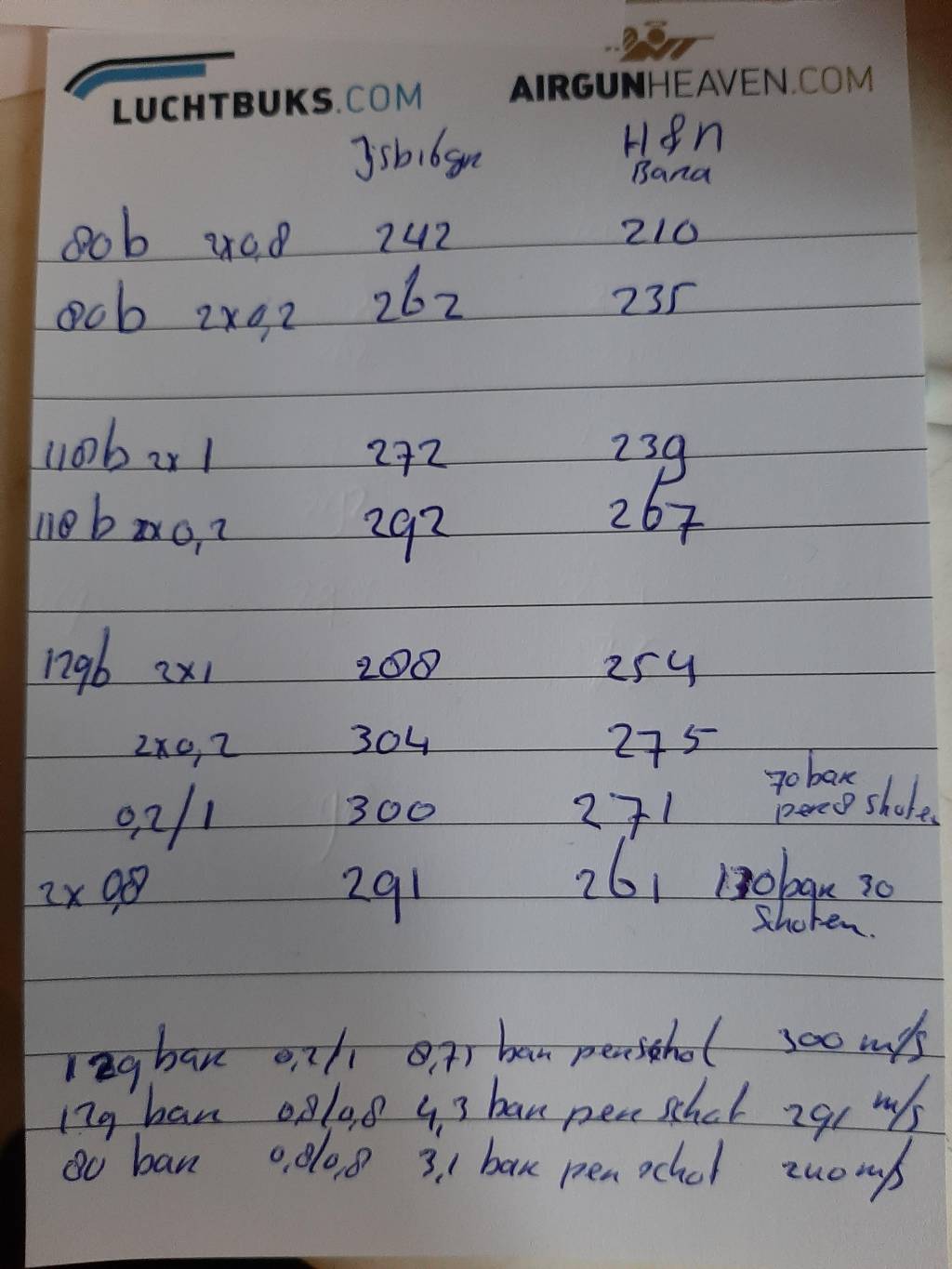

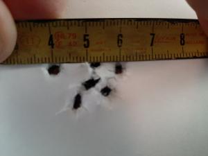

i did some testing when i got the leshiy with 16 gr jsb
also tested the effect of the jets at a couple of reg pressures to see what the effect was on the speed an shot count . Young
short conclusion as for now is that the small jets give a very high air consumption with my .22 350 lw barrel.
there for is tested further with the .8 jets inside giving some pritty good results at 80/85 bar setting at ca 242/245 ms and good shot count it shot nice groups upto 20m what was all i had acces too indoors .
—- these pictures where my last results at 50 meters using 16 grain jsb .22 at 292 m/s giving 25 m groups within 1 cm
128 bar and. 0,8- 0,8 jets getting 32 shots from 290 bar fill—
since then i set the reg at 108bar getting 272 ms with the same jets and ca 45 shots from 290 bar but have not been able to shoot due to bad weather , so i am curious what the the resuls wil bee.

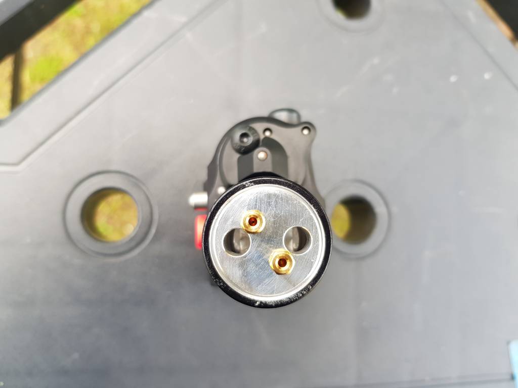

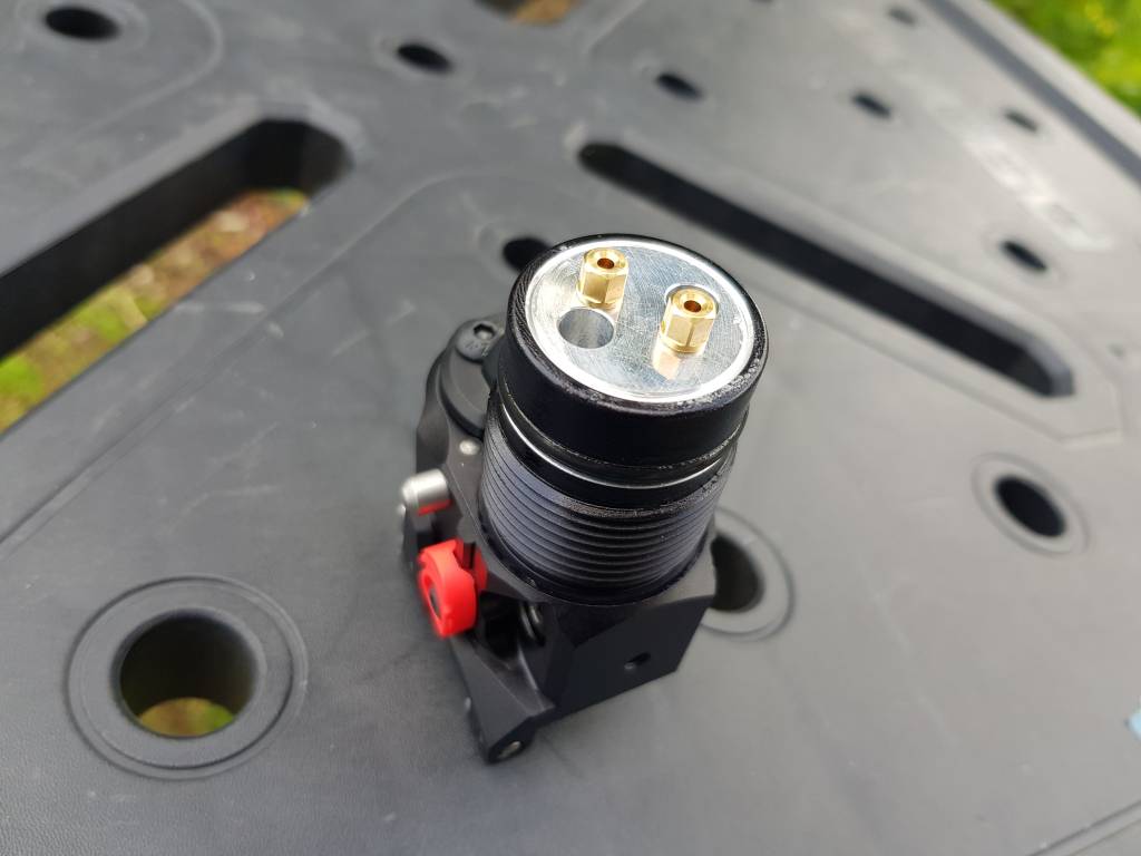

Did any of you check the real hole diameter in the jets that it came with.
mine where both markt 0.2 but the hole size was 0.6 or 0.7 when i compard it with the jets set i got from Francisco.
looks like they where short of the right jets an had to drill them out.

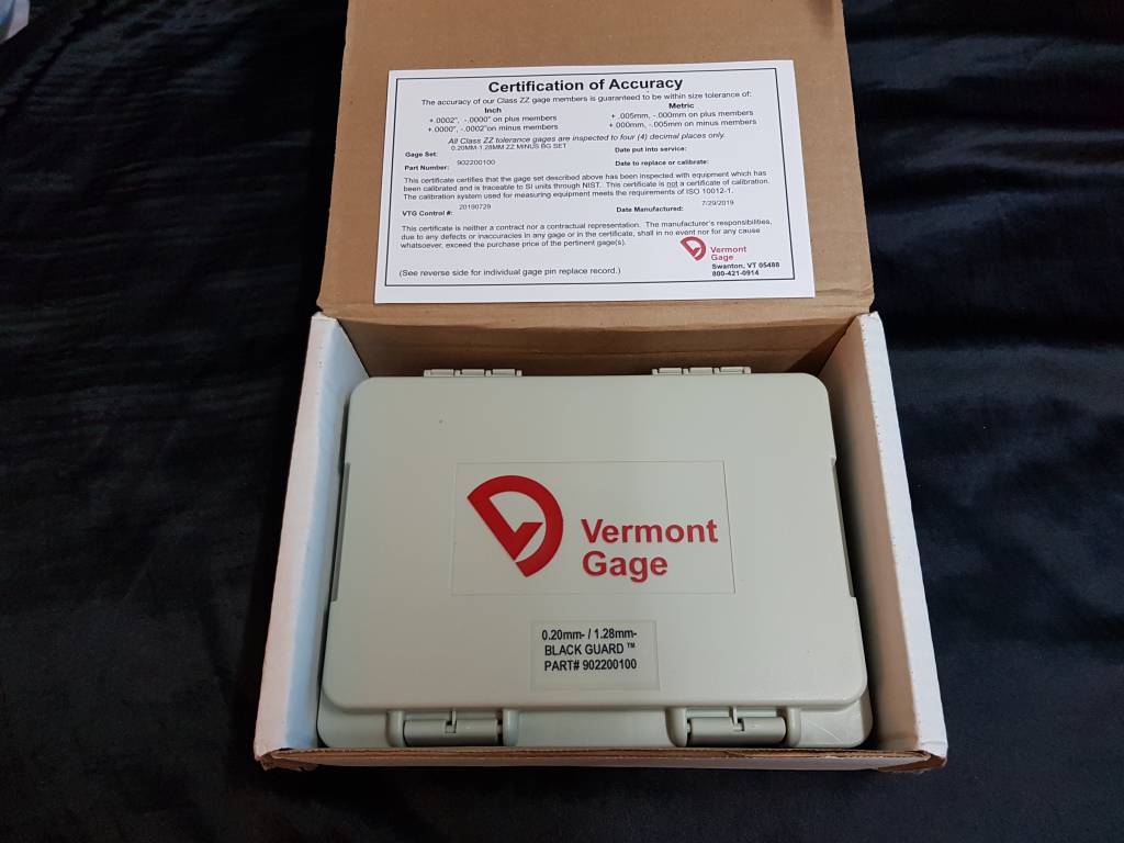

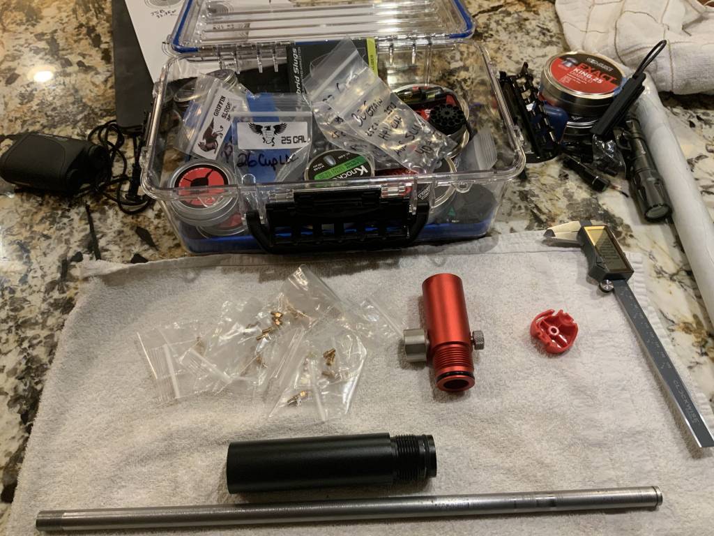

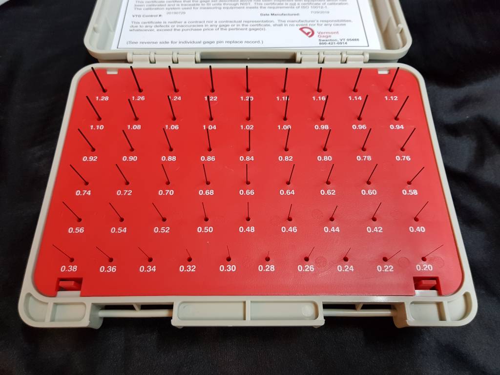

I picked up a pin gauge set just for the purpose of measuring the jets. I have a .25/250mm that came with 2 jets, no M4 screw plug. I asked Brian what size they were because they were not marked and he told me .4mm and .5mm. He said the only way to truly know which is which was to use a pin gauge to measure them. So I ended up buying a set and I may only use it once but who knows. I still haven't measured it yet but when the time comes, I'll be prepared. The jets come in sizes .2mm to 1.3mm. The Vermont Gage pin gauge comes in .2mm to 1.28mm. I wish they could have thrown in a 1.3mm to make it complete lol.
